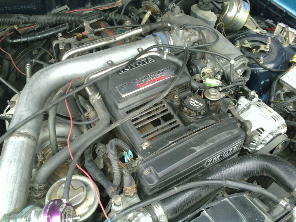

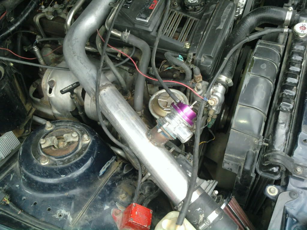

My friend has a Greddy Type s BOV on a custom intercooler pipes but it doesnt seem to be blowing off at all just here intake flutter.
Im not sure if it is a real greddy or a knock off it came on the car when he bought it.
Just looking for some reasons it would do this car is still making boost seems to be running ok.
Any suggestions?

I have the same 1 running only the top line. I use the stock line with no problems. Back the screw out as far as you can. Mine is out all the way with no problems ever.

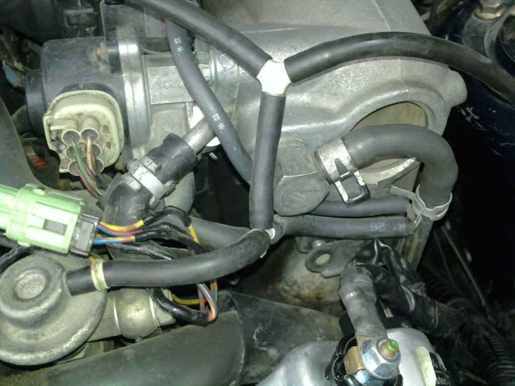

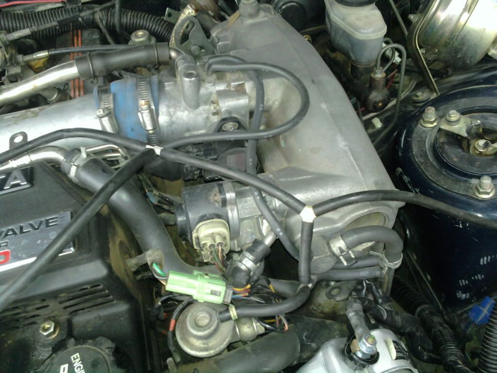

geezus thats alotta teeing. from what i can tell from the pics. it is hooked into the wrong sorce. the bov is an important part of the cars intake, i would not combine it with anyother part of the cars vac distribution. the correct place to hook it is off the hard pipe inbetween the 3k pipe and coil cover. then on the other side by the tb it is connected to ITS OWN SORCE.

Damnnn, your supposed to use the bottom nipple if i remember correctly, You BOV may have 2 springs in it. Run it to the stock bov line location.. shouldnt have anything hooked up on the fpr line.

Nope top big 1. I have the same 1. Bottom 1 supposed to make it react faster i think. Never used it and mine goes off all the time.
Bov own line.
Boost controller should inbetween waste gate and turbo nipple.
Take all that nonsense and return it back to stock.

I agree with everything Hvyman posted, even the not sure on the bottom nipple part. I too, had this same BOV, and never used the bottom nipple. I never had any problems.
I also agree with starting over with all of that T-ing. Did I really see a line running from a 4-Way T running to a 3-Way T. How in the hell could you have any idea what was going where? And what is that red wire running to where your BVSV should be? I'm assuming the vacuum lines from that go to one of the T's now.
