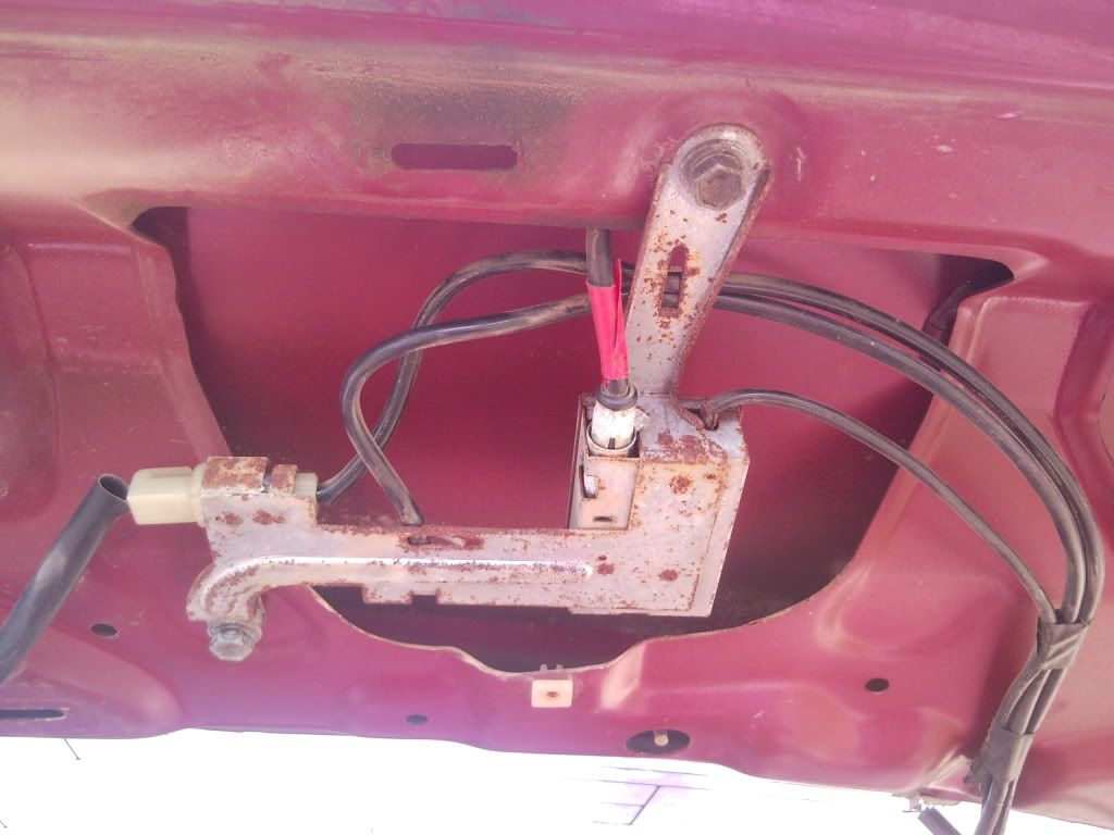

Looks like it may be another case of differences between various countries, I guess. Here's a couple pictures of the underside of a Canadian hatch - this isn't the car with the problem, it's my other '89, and it works fine. Both cars appear to be exactly the same in the way of wiring.

While I do have a connector C19 on my 87......
... as you can see there is no coke at that location. The ground wire comes directly from the defrost grid and is soldered to the little metal frame. No capacitor and no inductors.
