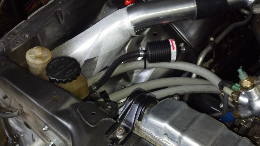

So I read a lot of older threads on adding an in line filter. I am going to go with a Magnefine 3/8 for the low pressure side. Does it matter if I install this under the car near the rack or up top near the reservoir?
Also, after fishing out my screen from the reservoir its ruined so I don't plan on using it since I'll have the Magnefine filter
Another thing worth noting I wish I knew before fishing out my screen....the top of the power steering reservoir comes off so you can easily get the screen out and clean it

The easiest place to add the filter is behind the bumper not far from where the "cooler" is. The "cooler" is just a loop of pipe. I cut off the u-turn closest to the hood latch to add my filter with a tiny pipe cutter. The right size hose will just push onto the pipe far enough to get a couple of hose clamps on it. Then, mount the filter behind the bumper.
Thanks for the info. I looked under the hood and located the loop of pipe - never noticed that before. I'm not 100% sure I want to cut out a section of the metal pipe so I may try and insert the filter between one of the rubber hoses. My filter is in the mail and I noticed it is directional. Can you confirm the fluid leaves out the bottom of the reservoir and comes back in on the side of the reservoir? I may try and connect the filter to the rubber section that connects to the side the reservoir or the rubber section right before it connects to the steering rack. I'll decide once the filter comes in the mail in a few days and I have an idea of its size.

I finally got the filter installed. I chose to install it right as the low pressure hose comes out of the rack in a section of rubber hose so I didn't have to cut the metal "cooler" pipe which was the other option. I will fill it with mobil 1 ATF tomorrow and bleed the system and take it for a spin.20160528_214521_001 (1).jpg

I cut my "cooler" so very many years ago... But I didn't know about the Magnefine filters back then, either.
