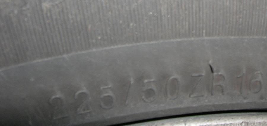

Must be your lucky day... These Kumho Ecsta SPT 225/50/ZR16 's are on all 4 of my sawblades... lol
Now to be fair i seached the internet before taking these pictures in the dark.... and 1 of 3 things has occured (or a combination of all 3)
1. Kumho no longer sells this tire in this exact model/series/iteration
2. The ratings have changed and Kumho changed with it
3. Kumho is no longer confident in rating this model at this rating

IJ.;1504095 said:
Never said they didn't exist ;)
While you didn't, searching the internet revealed (for me at least) only 225/50/R16 for Kumho Ecsta SPT's
Had I made such a claim without evidence, the misinformation task force would have striked swiftly

in the U.S. we have quiet a few zr rated tires actually ij. my falken 912's (crap) are z rated but my potenza re960 are only r or w rated(forget) but the potenza's are 10x better.
63
hvyman;1507139 said:
thats horrible gas mileage, might need to change you o2 sensor. i get about 25 hwy and 18 streets.
In the stock size??
(again didn't say they didn't exist just that I hadn't seen ZR in that size)

yeah stock size. there usually the higher priced better tires tho.
i got falken 912 zr in the front and some potenza 960 r rear. the 912's suck compared to the 960's tho.
