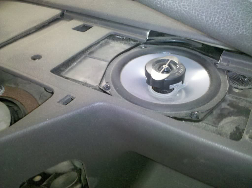

I have JL audio 5.25 TR coaxials in the rear pods. I just screwed them in to the top of the pod instead of seated inside. Had to trim very little. They sound fine.. then I've got 6.5 C5 components with ZR tweeters up front and a w7 woofer. All in an 88 supra.

I need some suggestions from the sound gurus on here, its noob time. I wanted to upgrade the 4 inchers in the front since only one works. I would like to stay under $50 for the pair. Whats the best bang for the buck here. Its an 88, I just bought it a week ago, stock radio for now. Also, I was going to do the 5.25 in the rear, and planned to mopunt them like qu3tzlgum8y, if I bolt them to the top, what can I seal them with so I can still utilize the stock ported box. Looking for suggestions on speakers here as well, like to stay under $50. Im not crazy about sq but I do want something better than the rattle pods I have now for speakers. Any help is much appreciated.

I don't remember having to seal anything.. they sound great. Here's a pic.
