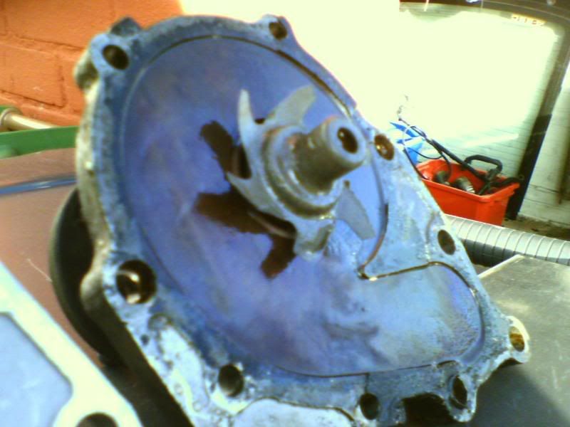

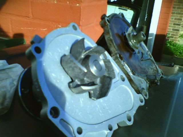

check your waterpump . . . it should look like this:
one i removed lately looked like this:
Reign_Maker
Has cheezberger
Aug 31, 2005
5,767
53
Florida
HighPSI: 500? huh? Whaaa?
Bondie: HOLY SHIT! I've seen some worn out water pumps, but DAMN! *shakes head* damn!
