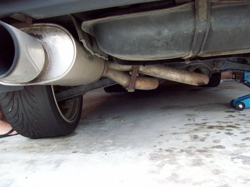

How do you have a 3" pipe and have your car sacked on coilovers while staying legal?
Had a thread on this a while back but now need to get onto it for cert and wof. Basically the back of my exhaust sits slightly under the dif so is roughly 50mm off the ground and needs to be 100mm for legal. Car is lower than display pic, and don't really want to raise it up (But might have to). Exhaust place said would probably need to go 2 1/2" because with 3" they could only remake it and move it so it sits about 20mm higher (so it clears the dif) (has to have 10mm clearance between pipe and body also)
Any ideas? Want to stay low and 3" and legal if possible.
(attached is pic of how exhaust sits, but when the car was higher, was told in previous thread it was just missing a hanger but it physically can't be held up any higher the way it is and $300 to have it redone 3" and only 20mm higher seems a bit much)

Cert plate goes on the car itself. Need cert for coilovers among other things. And lowest point of the undercarriage has to be 100mm off the ground for any car/suspension.
I've never had that part of the exhaust scrape and it probably never will unless something goes under the car because of where the wheels are in relation to it.
How would 3" to say 2 or 2 1/2 at the low point then back to 3" perform? Exhaust system isn't 3" straight through, just the back, but definitely want to finish it off something. Otherwise I'd probably have to go 2 1/2" for the whole thing. And would it need to go back to 3" at the muffler or could it just stay 2" and whatever for that last couple of feet?

You could either hunt for the rare systems that did it, or make one of your own that splits off to 2 smaller pipes to keep the same flow...
I think lilmiss had one of those systems, I'll have to look...
EDIT: found it, shamelessly stolen from LilMissMKIII

Have a look at how mine is run...
Now that's twin 3 inch pipes, but I don't see why it can't be done with smaller pipe. One 3 inch pipe is 7.1 in[sup]2[/sup]. Two x 2 inch pipes is 6.6 in[sup]2[/sup]. Two x 2.5 inch pipes is 9.8 in[sup]2[/sup]. So 2" pipes would be a small restriction, 2.5 inch pipes would be none at all.

Looks like a very nice system, probably very expensive as well. Not only would I need the extra piping but they told me each bend was $30. I couldn't even go twin 3" because even a single 3" fitted properly and as high as possible would still be way to low. Mine would be lucky to be 50mm off the ground under that subframe.
The only way would be the twin 2.5" for the same performance but for the money I think I might as well just go single 2.5" since the rest of my exhaust is only that atm anyway. Should also quieten it down a bit as well since I got picked up on noise.
Would love to be able to get around the rules but they're pretty strict on the car lowering. If anything underneath is not 100mm off the ground, or I have coilovers and no cert then car is instantly required to be off the road with a nice fine until it's fixed.
