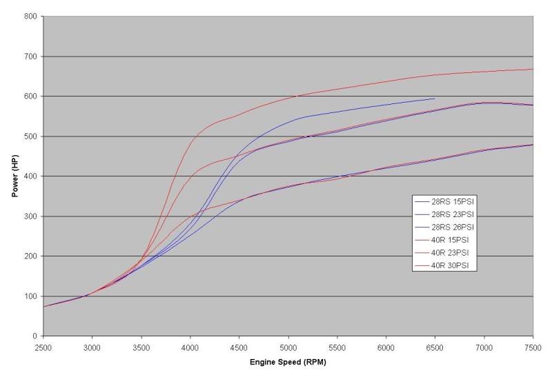

friggie thanks for response
here is a graph that i found digging for info. i understand the 1jz is at a huge disadvantage because of the displacement of the engine and which is why ive been going back in forth about what turbo or turbos to run ever since i decided to go with a 1jz in the fc.

nice find on the graph! what do you make of it though?
EDIT: wait, is that twin gt28rs's? it looks like the only difference is spool time really, otherwise almost identical. this is very helpful

I'll see if i can find the thread, but it shows the gt40r is producing power sooner in the rpm band, is alot more aggressive coming on and is also creating more peak power.. versus the twins are a little more linear don't create as much, but also are not as agressive when fist starting. which is what i think will be better for auto cross. its hard for me to make decisions because i only know one other person with a 1jz in the area, and only know one other person..my brother running a large single. so all the information for me has to found on the internet.
