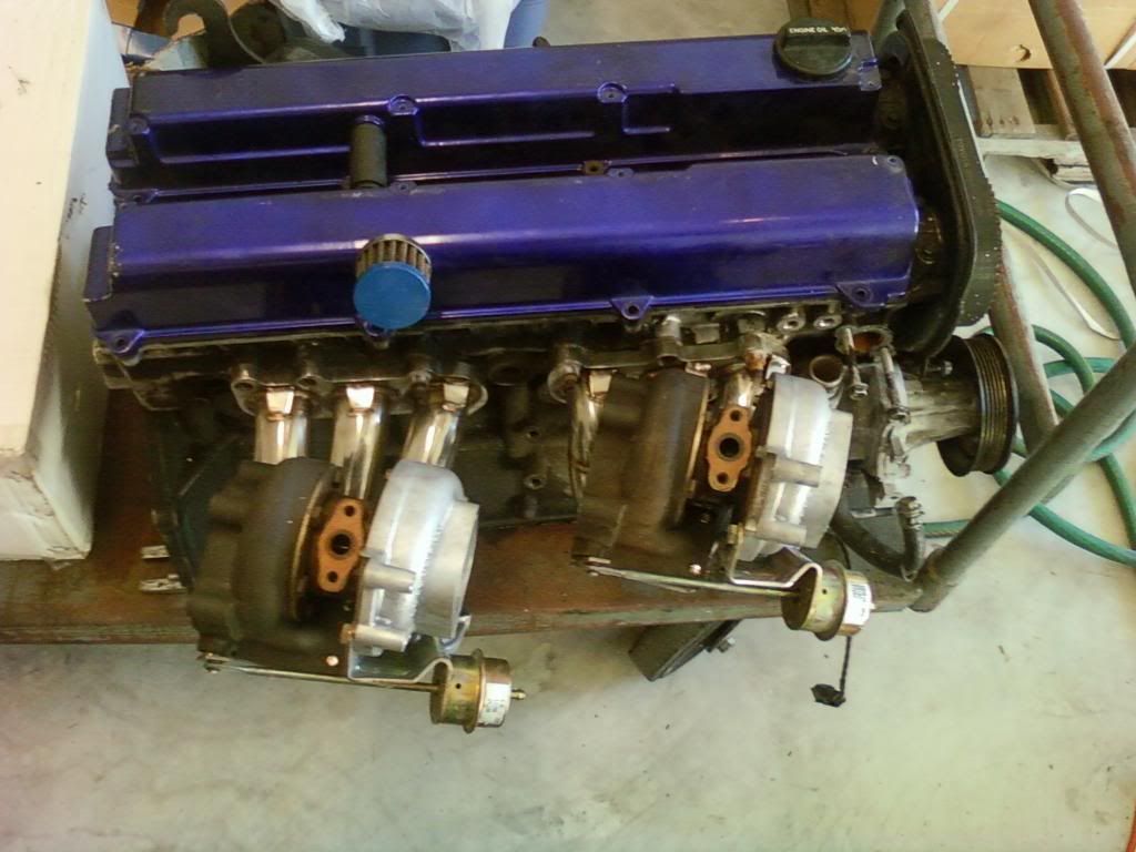

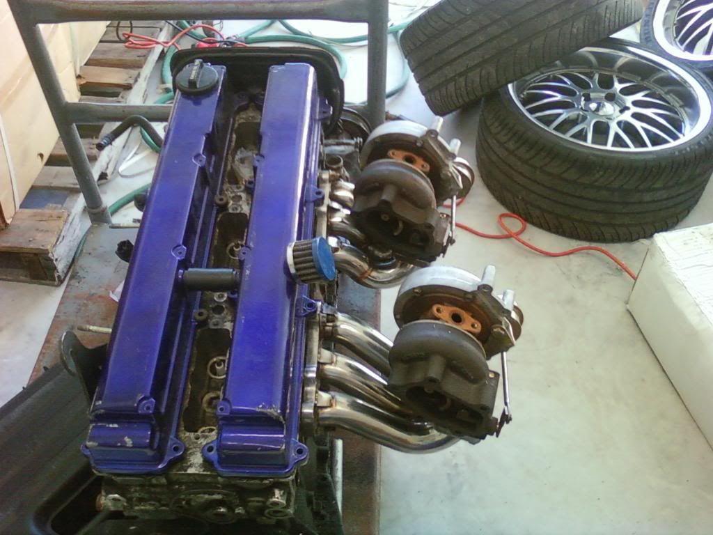

I am doing one as we speak. Should be fun..... I hope:x:
Can't deny it, twins do look awesome!! great work!!
