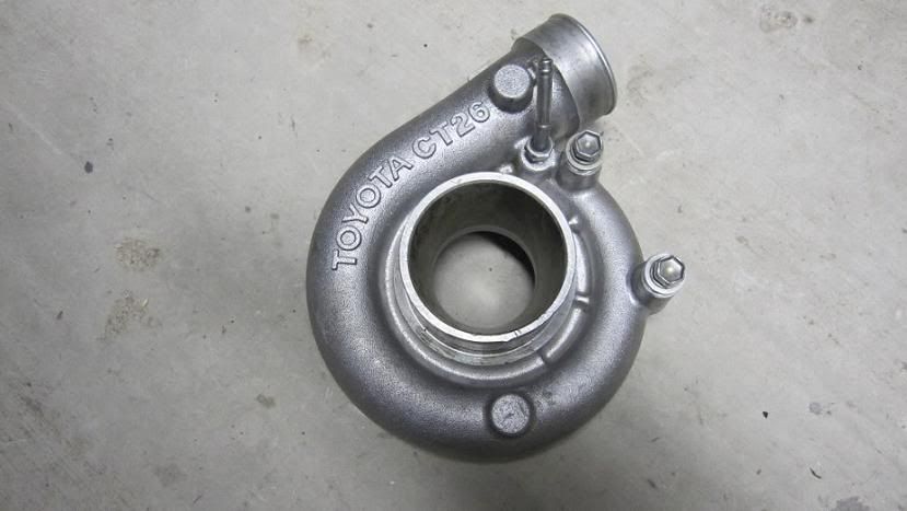

Devin LeBlanc
Apr 7, 2010
1,830
32
Las Vegas NV.
Heres the one that came off the 87 turbo parts car I bought.
