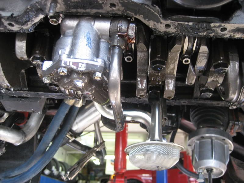

Yeah man. Need a freaking 1/8" BSPT to 1/8" NPT so we can verify oil pressure on a MECHANICAL gauge.
I'm not about to play games with a 7M when it comes to oiling ;)

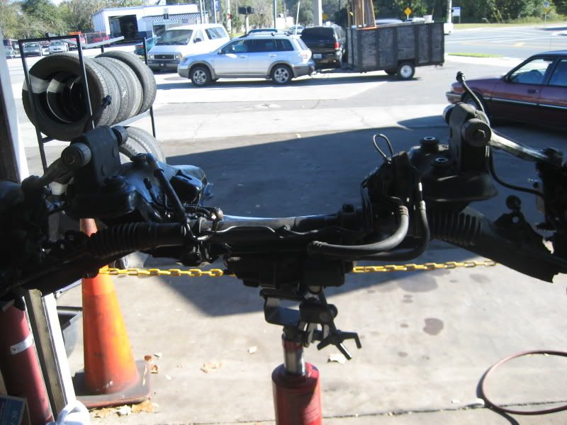

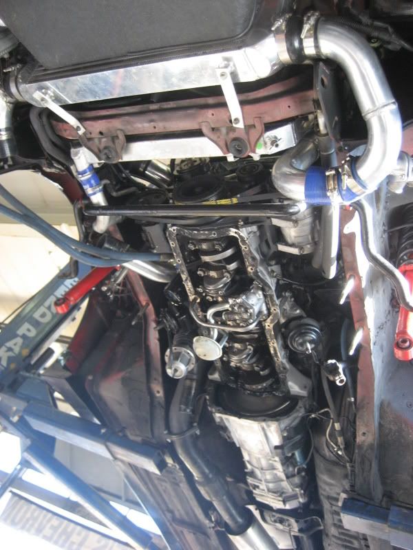

So much has happened since I last updated this thread so I'm gonna have to use cliffs in order old to new as the list goes down:
- Low oil pressure :3d_frown::cry:
- Oil leaks
- Drop subframe....twice
- New oil pump and oil squirters/bolts (Doward's) (baller) :)
- Still low oil pressure :(
- Bearing clearances.....standard on a cut crank....:(
- New bearings correct size :)
- Oil pressure good :)
- Blowing oil of the dipstick starting fire :(
- Finding PCV problem because of fire...priceless
Will do a full update when I have more time, but here's some pics.

Yep. Jeff's now toting one of my fire extinguishers around since we had fire on the side of I75.
Now to get that PCV system run right ;)
