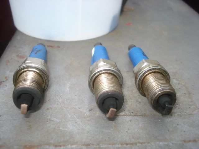

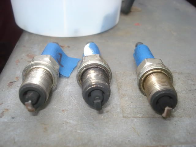

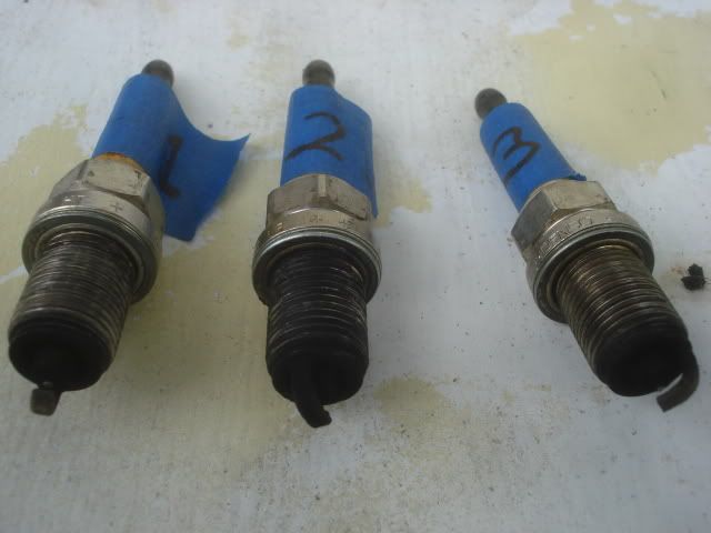

I pulled the plugs which ended up being pretty black, so they were replaced yesterday with another set of Platinums at no real advantage. Car still sounds like it has a misfire and doesn't idle too well. Also, there seems to be a few things the p/o has messed with which I'm unfortunately clueless to. From all the pictures I've seen of 7M's the 2 breathers out of the valve covers get routed elsewhere, whereas in my car there's just 2 rubber hoses that dump down along the sides of the block.

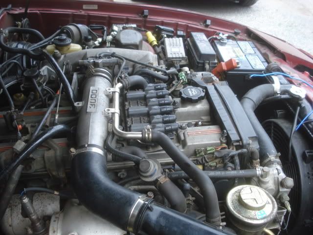

Also I took notice to this looking a little tampered with:

---------- Post added at 09:07 PM ---------- Previous post was at 09:02 PM ----------
Here's the old plugs that were pulled out of the car for reference.

does you car have the charcoal canister? take some more pics of the engine bay... and what is that plugged hose there in the pic above?
---------- Post added at 11:34 PM ---------- Previous post was at 11:33 PM ----------
or is that a plug in your accordian hose?

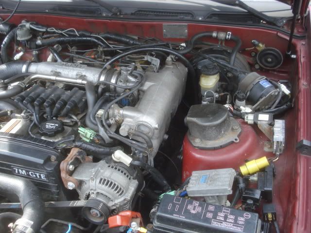

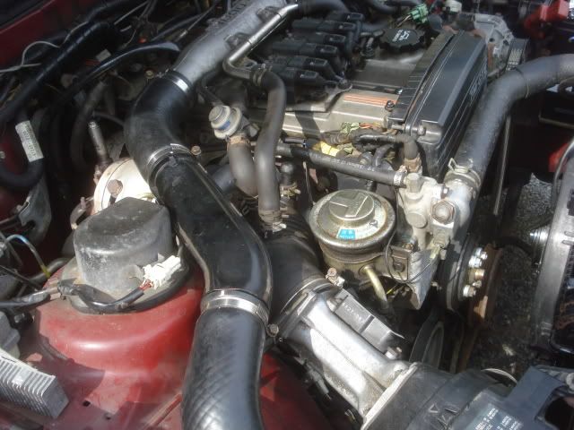

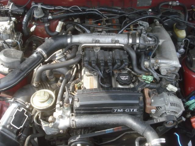

Its a little too dark to get anything substantial currently, but I'll grab some pictures of my engine bay in the morning here. Sorry, the car is at my parents home and I'm gone during the week and too busy / forgetful during the weekends. So far I've only had time to change out the plugs which haven't seemed to make much difference, but the old ones (eventhough the pictures aren't that great) benefited from being replaced. A set of NGK wires are on order now and won't be installed until next weekend now..
The previous owner unfortunately removed the charcoal canister and bypassed PCV.. I'm not sure what he did to reroute the EGR setup but as far as the second is concerned all that's left is 2 rubber hoses attached to the breathers atop the valve covers that just hang down along the sides of the block. I do however have the metal pipe that runs from the throttle body, into both breathers and back toward the accordion before the turbo. Would it be worth redoing this at the very least?
Also wondering what people think I should do about the altered thermostat housing.. Sorry for my ignorance here, I'm still in the learning stages here and would really like some input on sorting out all of these problems. Hopefully I'm not overlooking the obvious and making a fool out of myself here, so please call me out if that's the case :nono:

Still have yet to drain the oil and give an answer on that, waiting for a cooler day. Besides, parts haven't come in just yet so no real motivation to do much with the car just yet. Anyhow, here are some engine bay pictures, for those wondering whats still stock and what's been unfortunately changed around..

And here's some updated, forced flash, photos of the spark plugs that were in the car when I bought it.. they're probably still not the greatest pictures, but unfortunately the best I could take..
Swapped in a new set of NGK wires today, seemed to make a marginal difference but not enough. Threw on an extra set of coil packs I had and almost instantly ran fine.

1 It looks like you have a blow-by issue, that the previous owner was getting excess amounts of oil in the accordion tube and likely smoking. so he installed a "road draft tube". the source of the blow-by needs to be addressed, and the PCV needs to be put back stock.
2 Does that electric fan work? How is it controlled? I would suggest you ditch the e-fan , and get a good stock clutch fan, and fan shroud.
