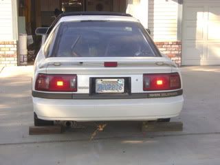

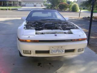

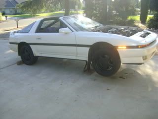

Heres some pics of mine build in progress tearing out sold motor and build thread coming soon..... :aigo: Those are mkivs on here just sprayed them black.... :biglaugh:

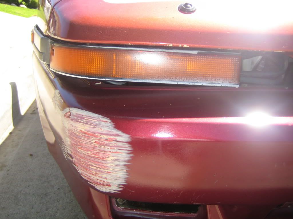

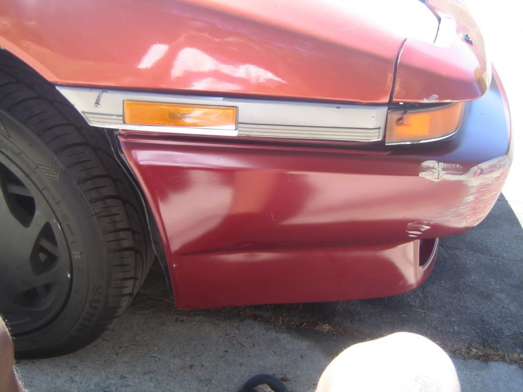

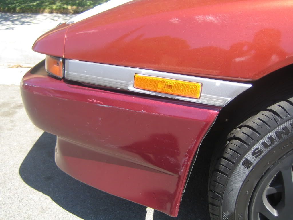

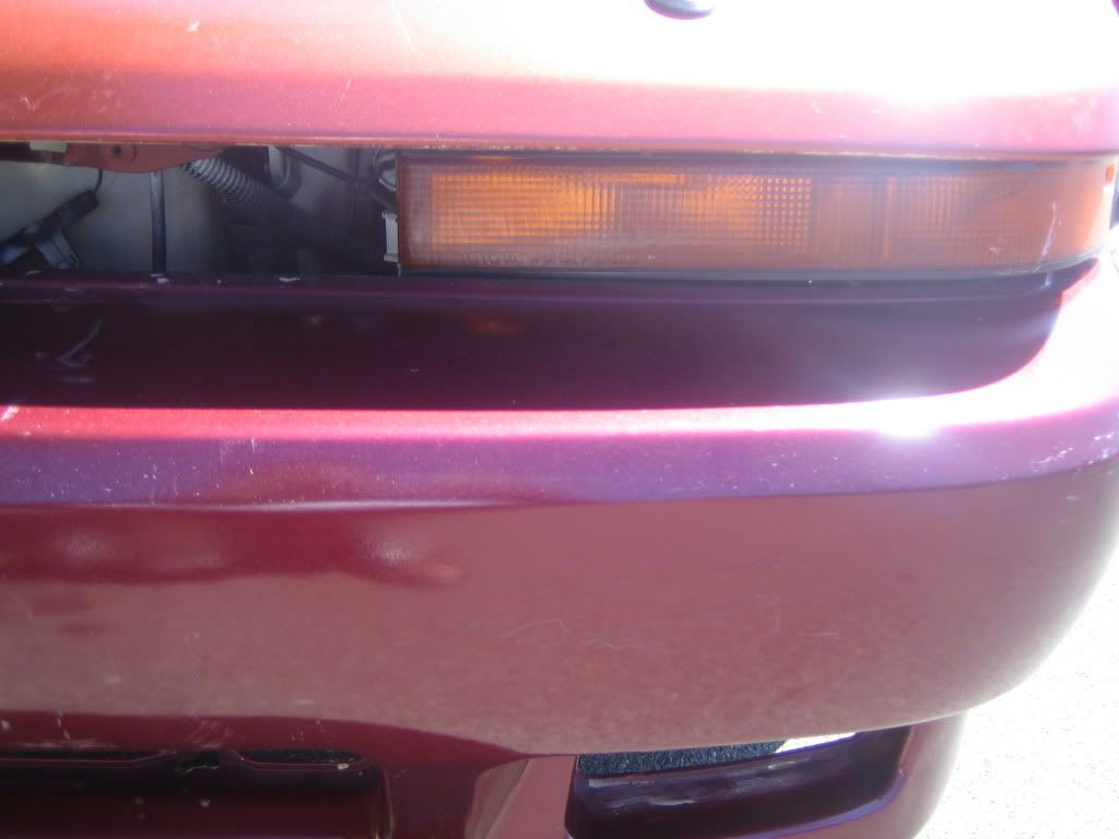

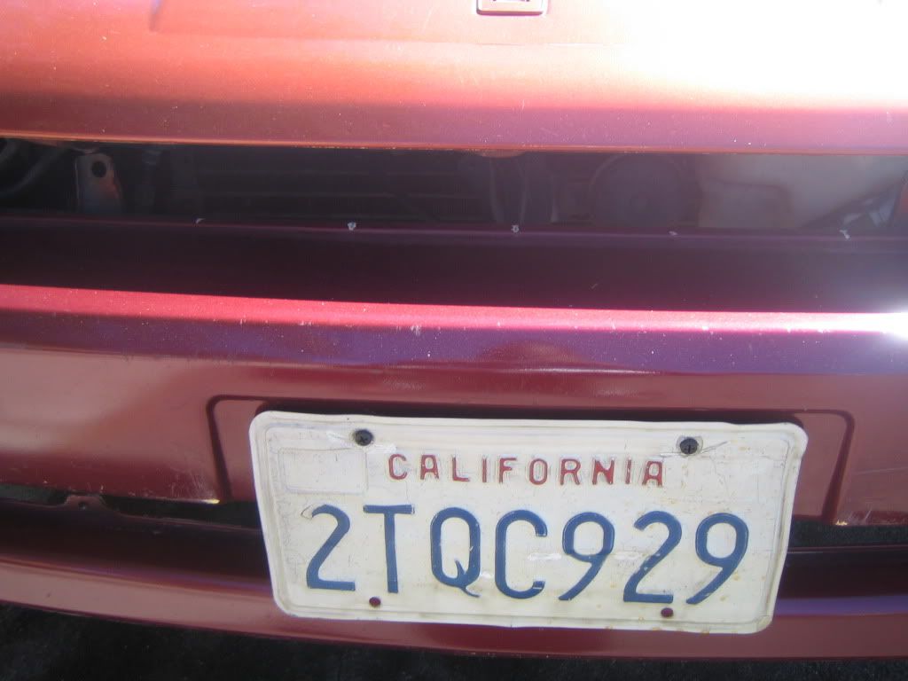

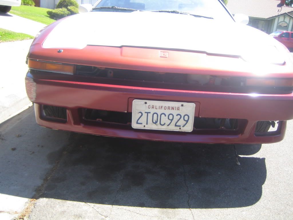

Heres some pics of my car, it came 100% this way, multicolored and everything but I cant complain for the deal i got on it haha. It came with the pre 89 bumper. I do have both the grills and fog lights, but havent put them in yet. Anyone who can let me know exactly what i need to do and buy to complete the pre 89 setup will be greatly appreciated.

yeah, you have an 89+ support, as it's impossible to fit 89 signals on a pre 89 support without cutting, as it'll hit (ask me how I know)...
so you have two choices
1: swap to an 89+ front, I have a set of nice condition signals and nose grilles, you just need the bumper and fogs...
2: swap your header panel support, and buy a pre 89 grille to complete the look..
your crooked bumper is caused by something else, as it should fit normal, regardless of the header panel support..
