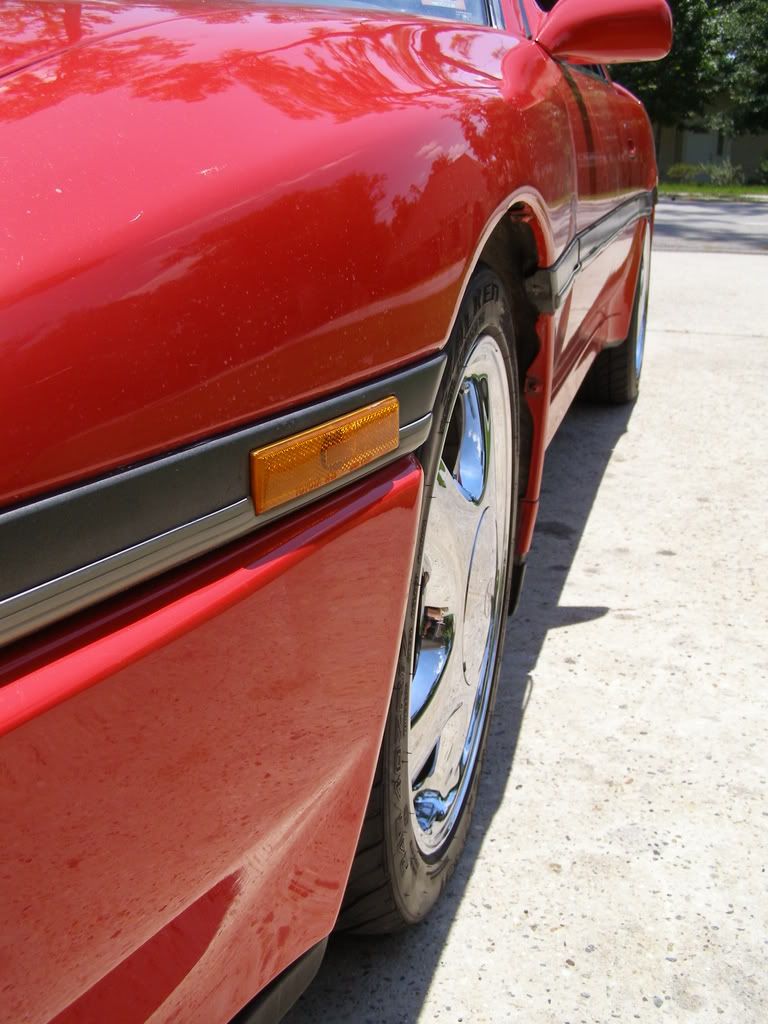

No adjustment here. Don't know about with spacers. My favorite photo under a hard corner. I am a picture whore I know.

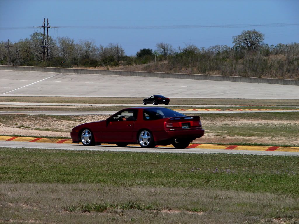

On Eric Varah's car, they were recessed quite a bit but that is because he was running MKIV spindles and brakes on his MKIII. Alignment was never 100% right and the wheels always looked like they were tucked in too far, and they were too far back in the wheel well as well:
I often wonder if it is a misquoted conversation about Eric's car that started all of this...
Compare my MKIII to those pics above - my wheels look normal to me:
Maybe someone is more picky about it than I am...

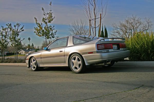

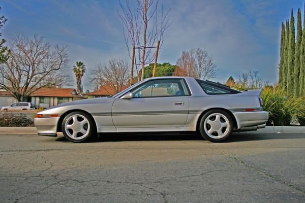

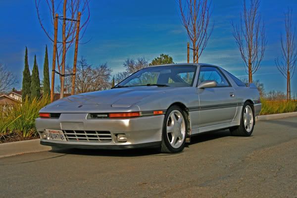

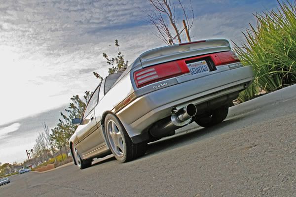

My car as it sits now
[thumb]http://i688.photobucket.com/albums/vv249/BoostedSupraMK3/1989%20Toyota%20Supra%20Turbo/SupraTurbo3.jpg[/thumb][thumb]http://i688.photobucket.com/albums/vv249/BoostedSupraMK3/1989%20Toyota%20Supra%20Turbo/SupraTurbo6.jpg[/thumb]
Nice car, that supra is real clean looking.
