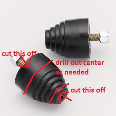

Just finished the front end bushings and found that the following 'generic' energy suspension polyurethane bushings work for our car.
Part # 7.6104G Bump Stops. (requires a small sleeve to fit over shock rod tip to hold it firmly. ID is just a tad bit to larger and wont stay at the top of the shock without the sleeve.)
Part # 15.6103G Coil spring isolator (replaces stock rubber piece between spring top and shock mount, also has relief cut out to fit springs that are not flat on top)
Part # 9.9484G Shock eyelet bushing (must have roughly .10-.15" from outside diameter to fit eyelet hole. Also needs small spacer shim to extended crush sleeve length or separate crush sleeve that is roughly 1/8" longer)
