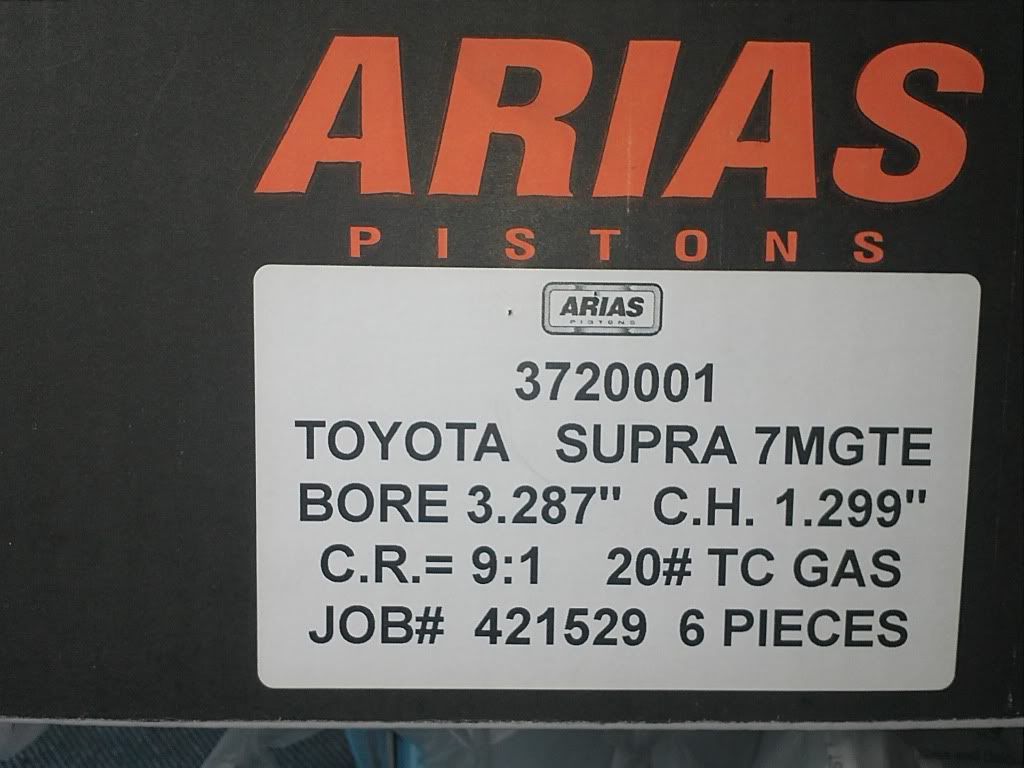

I bought the Arias pistons myself.
Haven't installed them, but the block is finished at the shop, anyway, I have to go pick it up, but waiting for bearings anyway.
