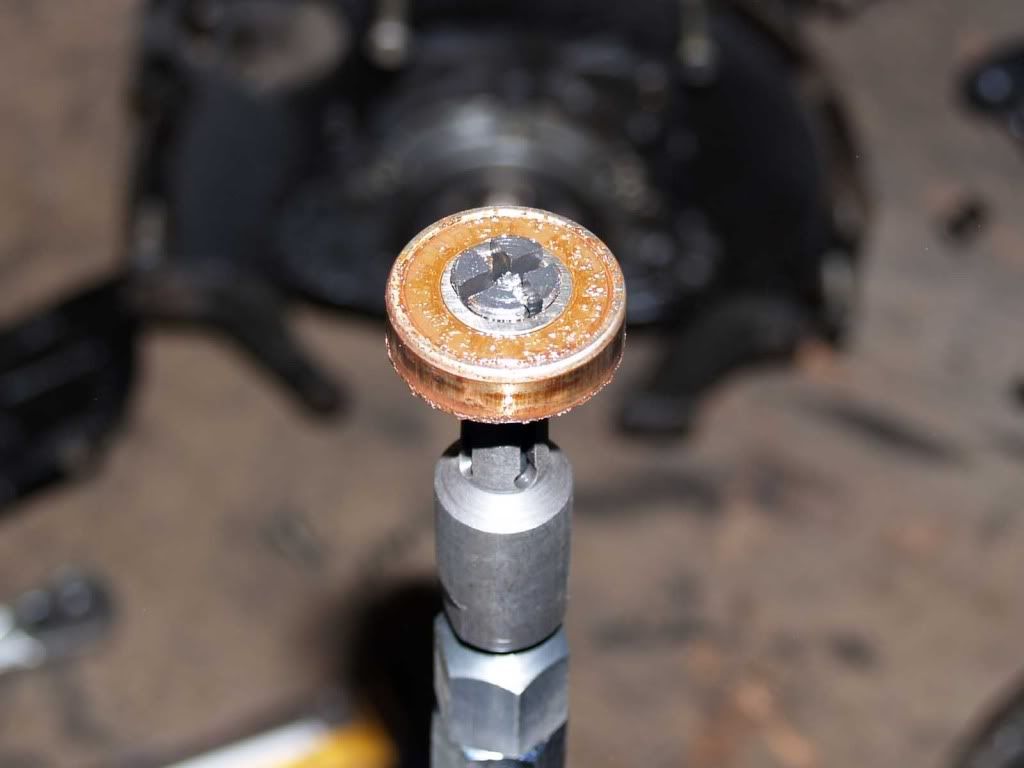

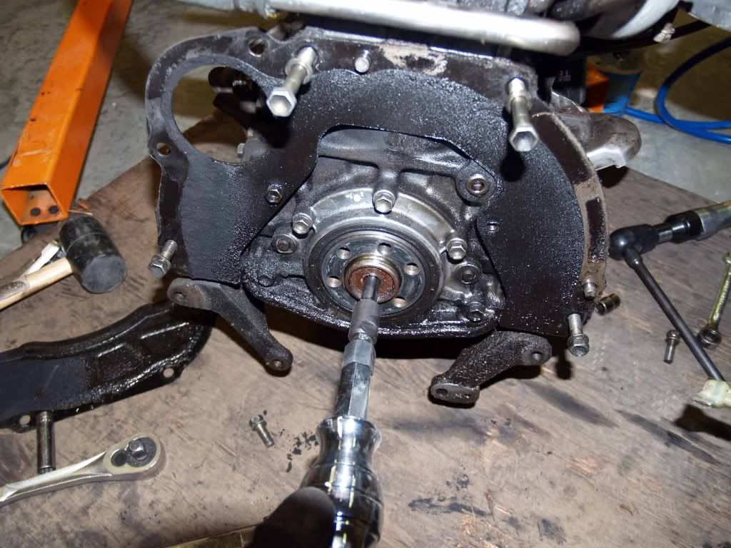

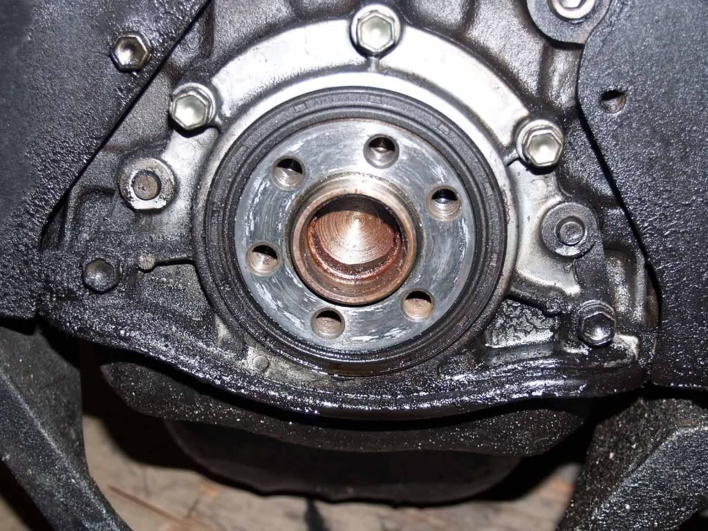

Here's my "no grease in the face" method... :biglaugh:
