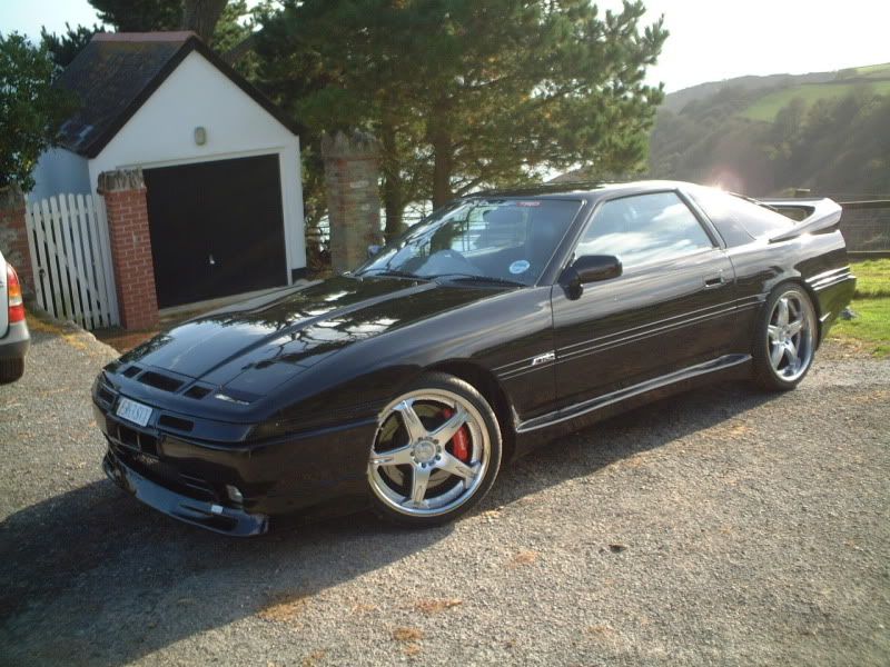

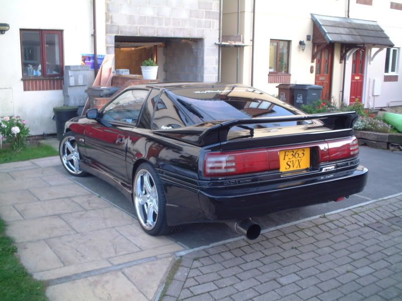

IIRC Kaminari and regulus are the only rear wings that look like the OEM one only a little higher / wider.
Search for pics of the Kaminari one, it has been posted a couple times

Im going to have to look at that regulus spoiler a few times before I decide if thats too high, or just right.First impressions Im alright with it
