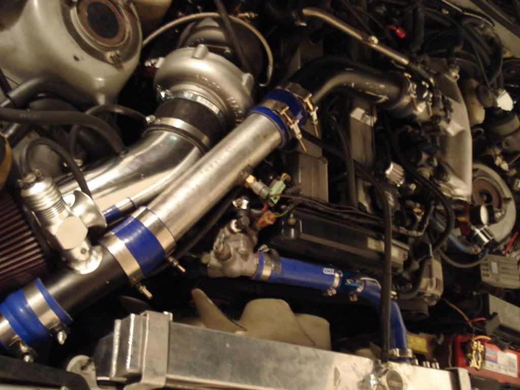

well heres what i have, dont have the complete but used a couple U-bends to make it.
in my 87

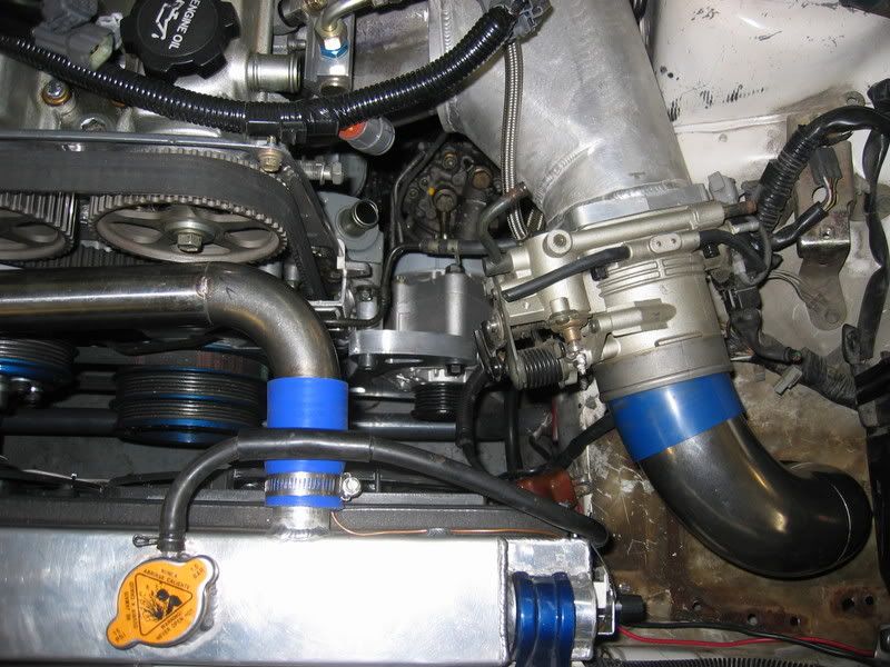

Here's my setup, used a $200 universal ebay 2.5" IC kit, but it's not welded up nice like Ian's.
BOV pipe missing, BTW
This bit hangs up higher, but the pipes are disconnected right now.

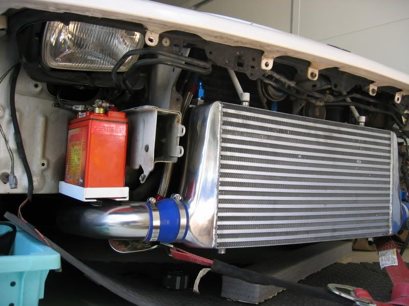

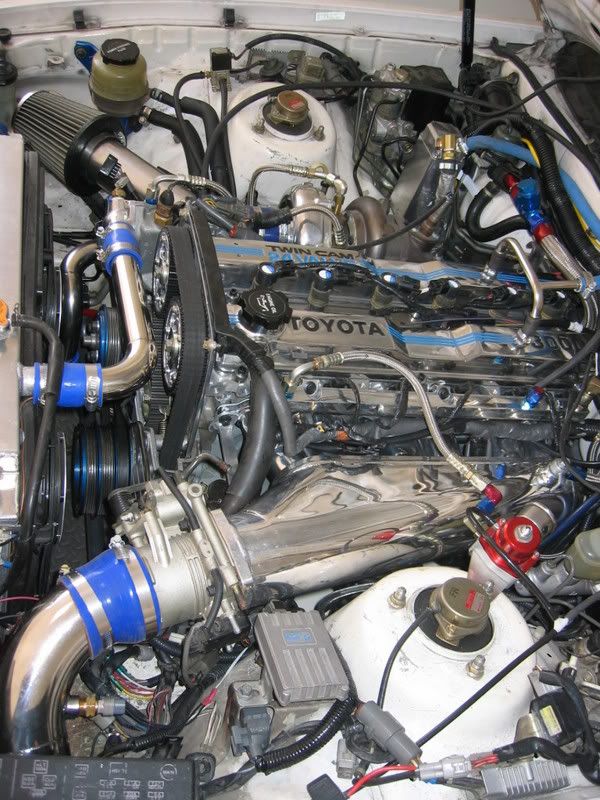

2.5" from turbo to IC, 3" from IC to FFIM. All polished stainless and now T-Bolt clamps throughout, only uses 4 silicone couplers total and IC to Manifold is very hard to remove from vehicle, so no other pictures until rebuild, paint job or part-out.

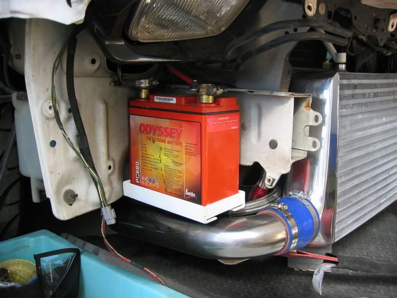

IC and PC680 battery location
Custom IC brackets

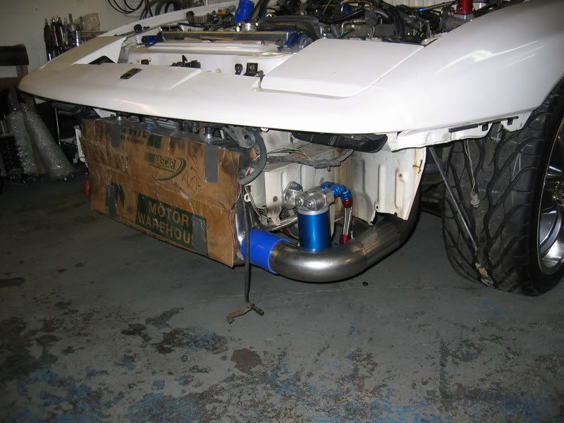

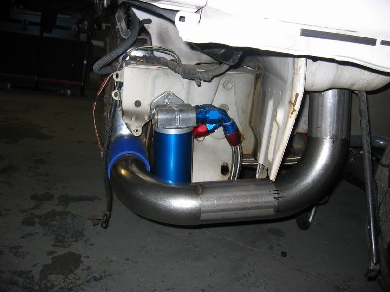

Test fit before final weld and polish

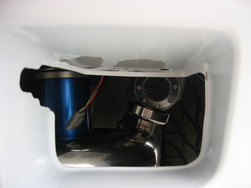

New style HKS SSQV on custom flange

Yep, it's too low for me too, but it was just a temporary thing so I could drive the car. I plan to have a ffim and welded pipes this spring. Ooooh, it'll be so nice!
