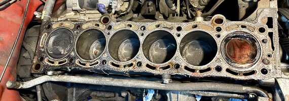

The Supra has run well since 2013 despite my rushing into things, largely thanks to many posts on this forum. However, something has felt off for a while and it looks like my luck has finally run out:
Machine shop will get the head once I can find one in the Columbus, Ohio area to do cleaning and timeserts on the exhaust studs that came out. I have my own cleaning to do as well on everything else.
The temporary goal is to get the Supra running again with a stock gasket, and wait for warmer weather to pull the engine to get it prepped for metal and ARP studs.
