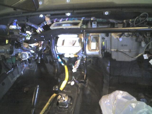

So I finally got around to start tearing out my interior for the color change (oxblood to black). Dash came out easy, carpet came out easy (found a diamond engagement ring (http://www.supramania.com/forums/showthread.php?t=97598) and finally it was time to begin the sound deadening process.
For those of you who have missed my other threads, the entire undercarriage of the vehicle, wheel wells, firewall end of engine bay and even the gas tank have been completely stripped, sound deadened with soundspectrum and painted over.

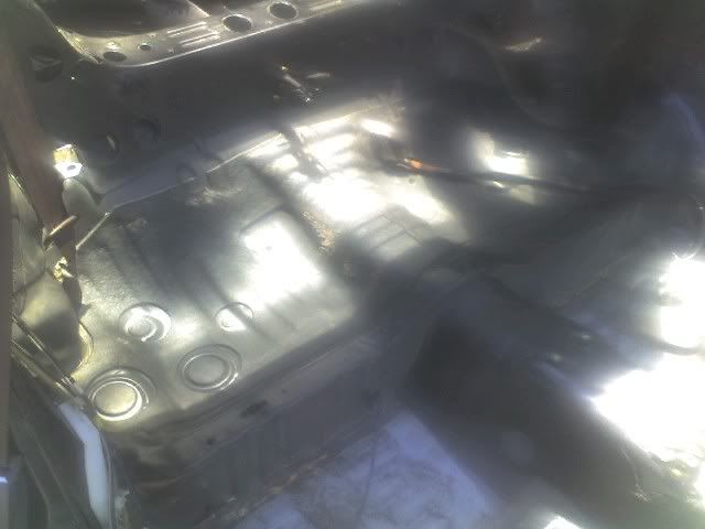

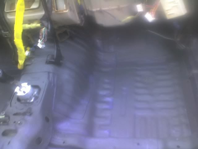

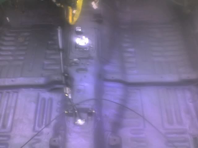

Once the carpet was up, I thought I could just leave the factory asphalt deadener on the car and just cover over it; so I cleaned it up real nice.
Unfortunetly, that factory deadener isn't just a single layer of asphalt based mat; rather a quesadilla of asphalt mat with foam in the center. Problem is, over the years the top mat begins to form cracks which lets all sorts of nastiness that has been spilled in the car over the years seep in.
The real problem being is that when I hosed the floorboards out, the water rested in the cracks and the foam sucked it up. It was raining the rest of the week so nothing evaporated. Days later I could still push on the mat and see black fluid dribble out. The choice was made, it's gotta go.

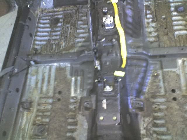

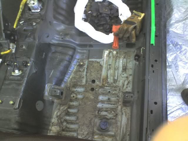

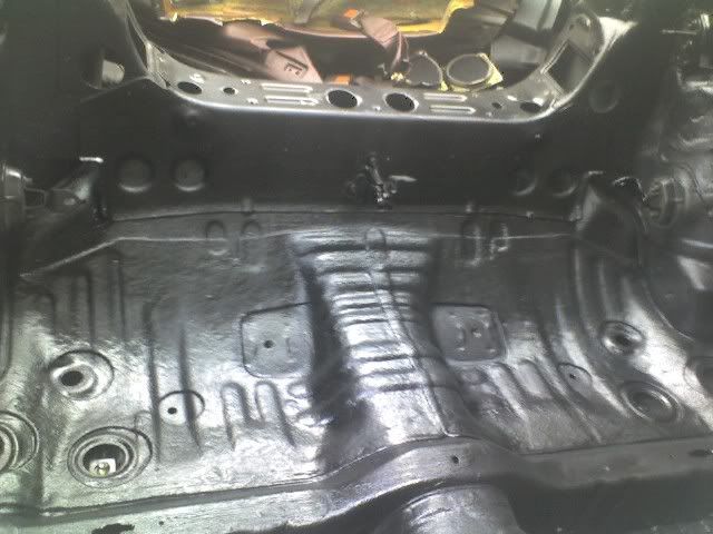

The top asphalt mat and the underlying foam came up very easily. However, the bottom mat was a different story all together. I real pain in the butt to get up. I had to resort to a heat gun and scraper.
Here's where 5 hours get ya:

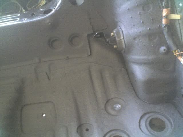

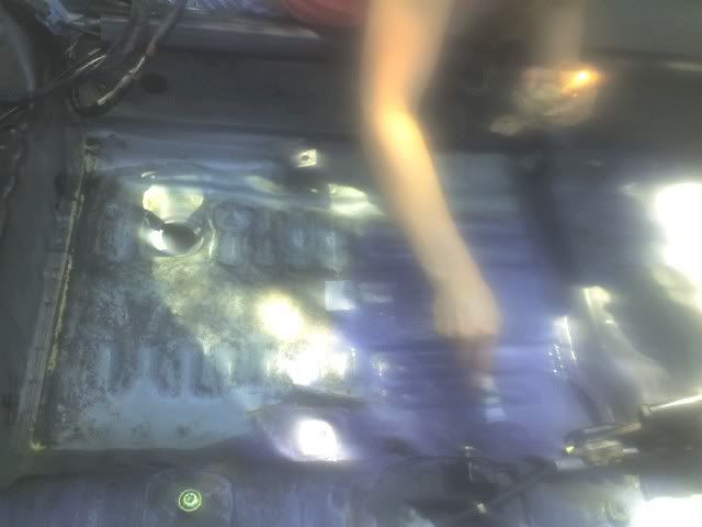

Once it all came up, me and my woman took a healthy helping of Comet powder to the underlying surface to scuff it up real nice for the sound deader to adhere to. Then all surfaces were wiped down with a clean rag and alcohol; thoroughly.
Nice and clean

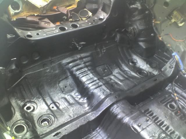

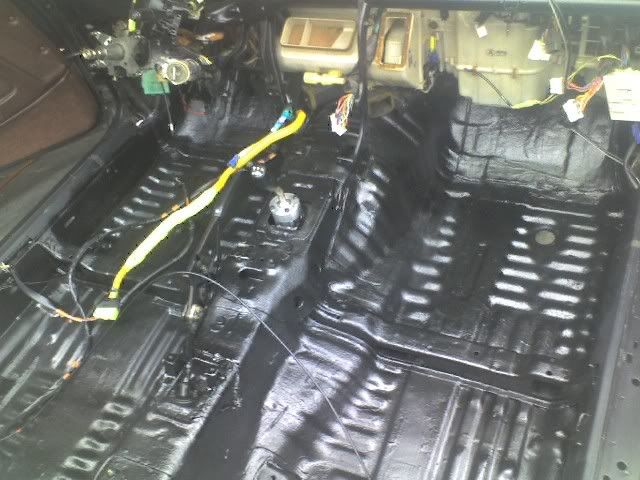

Finally the fun part.

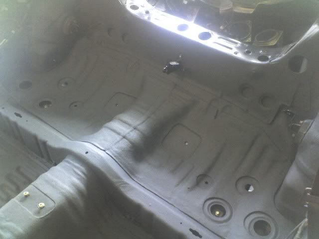

First coating of sound deadener (blue when wet, grey when cured)

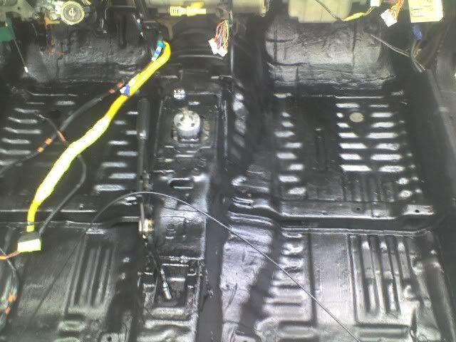

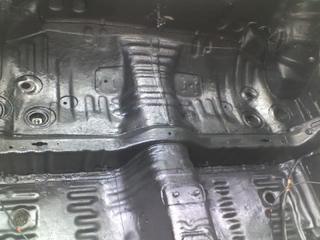

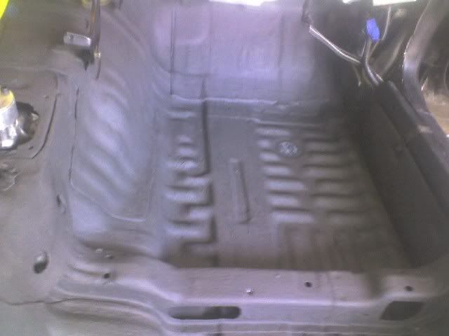

Put a good 4 coats on. This stuff does not weigh much at all since it is waterbased. I put maybe 4-5lbs of deadener on if that. Not much considering a pulled a good 15-20lbs of asphalt mat off.
Since the deadener is waterbased, a protective coating is needed. Some Krylon Gloss black paint fits the bill nicely. Used 2 cans.
All that's left to do is run the wires for the stereo and put down some plush black carpet. As you may have noticed, the trunk area is still not finished. It's currently full of everything that needs to be color changed to black. With the weather lately I've been falling behind.

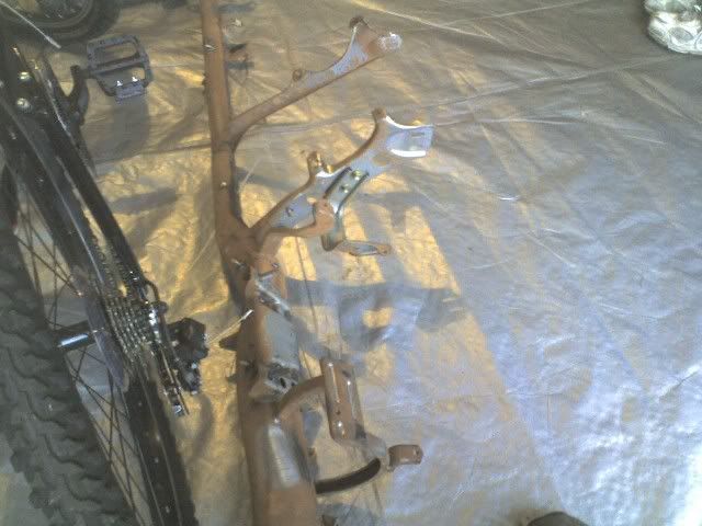

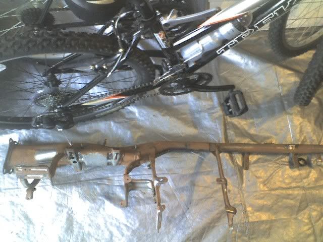

While me and my girl were at it, we decided to pull the rusty dash structure brace and sand, rust convert and paint.
