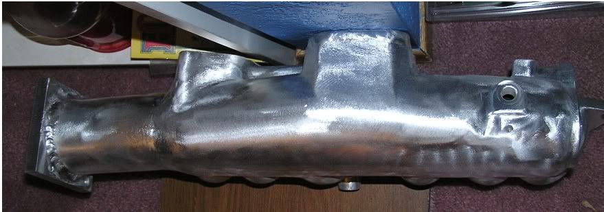

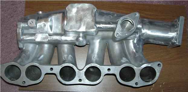

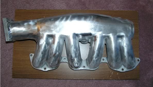

I will be getting a FFIM from Sethron71, It holds all the stock features and looks stock which is most important to me.
Pics:
It will be sent to jdub and ceramic coated!
The TB I will be using is a Turbo A TB (65mm).
I plan to run this setup for around 400hp for about a year to get familiar with the enigne itself and driving capabilities while my engine is capable of 500+. Once i decide to Up the boost on the JT61, I will most likey get rid of the Turbo A tb and slap on a Q45.\
I know the the Manifold doesn't look appealing compared to the Long runner or short runner FFIM, but this will do the Job for my power goals. Cleans up the engine bay and shortens the IC piping length.
I plan to run this setup for around 400hp for about a year to get familiar with the enigne itself and driving capabilities while my engine is capable of 550+. Once i decide to Up the boost on the JT61, I will most likey get rid of the Turbo A tb and slap on a Q45.
I also ordered J tube return line that has been drilled to remove the restriction.
