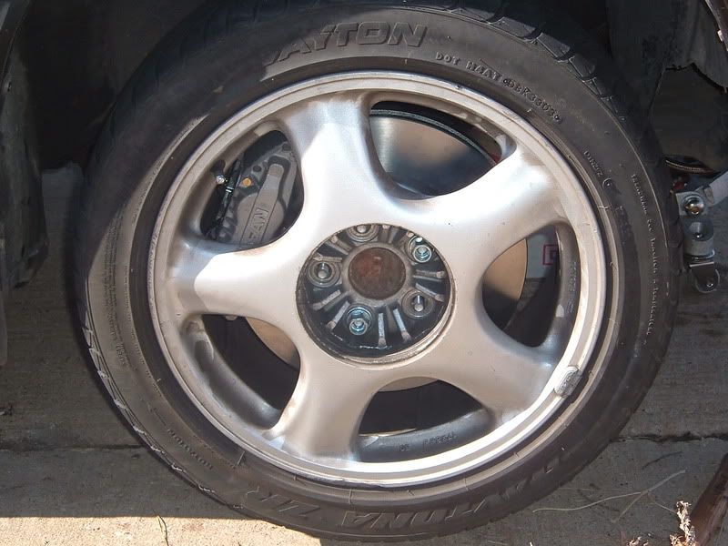

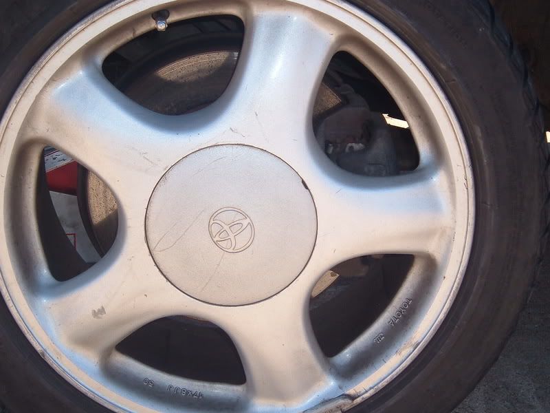

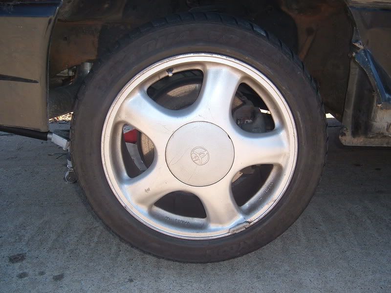

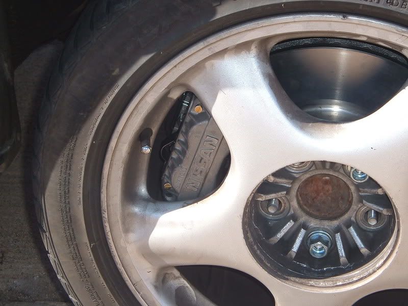

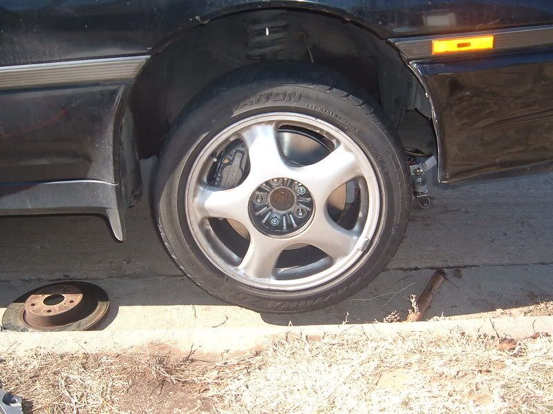

Something am Working on....
Long Story-short, i've basically added a pretty fair amount of boost and the stock brakes isn't cutting it. So trying to find improvements over the stock setup but for a Fair and Reasonable Price Plus I wanted it something to be more off the shelf parts so that you could piece it together rather than opening up the bank since we're all not loaded. lol
Anyways i got a few pics of what am working: Front Night Pager Brakes
-Sry not a good Camera Man-
Vs. Stock Mk3 Setup "wondering whats wrong with my fender-blow out at full boost on the highway...lol
Notes: using the 350z Rotors(12.75") but most likely switch to the mk4 (12.72") Rotors. I guess the only drawback is the Nissan Logo if your that picky but you can sand that off or just spray paint them black. Right now am stuck with going on the rotor choice either: 350z rotor needs a shim just like if you seen on the rear mk4 conversion or take some meat of the hub to bring down the total diameter to meet the mk4 rotor. Need to talk to my performance guy in the city and see what he can cnc for me. Anyways i hope you like and when i get everything figured out Or even be able to go with either option that suits you best I'll get you all the details for doing the swap successfully.
blackgamer16
Supra Driver
Apr 27, 2005
243
Sooner Country
Its pretty damn good... it should be just as good or better than the Arz kit. Depending on how good of deals you get, i got some killer deals since i work for Napa.
But an estiment:
Rotors: 40-50 or upto a 100 or so a rotor (i'll see if i can cut you a deal from work to get it cheaper)
Calipers: Ebay- you can find them at 150 or less shipped( you might be able to use the skyline calipers too; they have more surface area to bit down on the rotor, buddy of mine got em on his 240 and switching to the 300zx calipers so i might be able to test fit them out for you guys)
Brackets: Special order from Silverlineracing.com i think 280.53... takes about 2-4wks since he's in the UK. Good guy he's on the forums. Group A Supra i think is his s/n.
Hoses: I might be able to get them over at midwest Hose in the city- Not sure on that price
Brake shims(the preferred route) if i use the 350z rotors- not sure- still need to talk to my peformance guy.. am guessing 150-200 for custom brackets. Cheaper of course if i get more guys wantin this kind of setup.
And if you use the mk4 rotors you would need to get the hub brake lathed down to meet the inner diameter of the mk4 hat. That price depending on your machinest and also if your machinest is willing to do the job. Most won't since it has to do with brakes since thats a safety issue so they'll avoid those kind of jobs- BAH!
It just all depends on how good of a deal you can get.
So far am $567.01 includes:
brackets: 280.53
rotors: 95.92 if you can wait 2 wks or 20.04 reg UPS extra calipers:brand new(reman) from Beck Arnley: 190.56 ( really am prolly putting the Beck Arnleys on my 240 so i'll pick up a set used for 100-150)
Am shootin for 750 or less.
