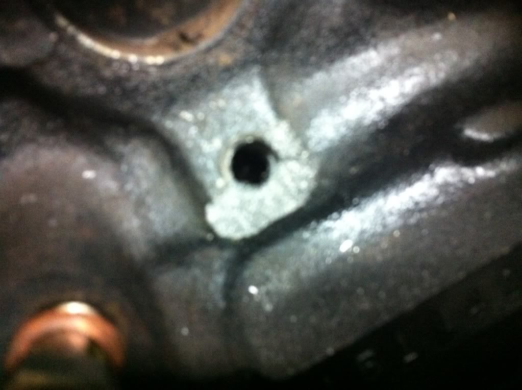

BAD news!!!! So i walked away from the problem to think about it for awhile. Went to work on pos z32 lol. While working on it my father comes over with a smile on his face saying i got it OUT!! So im thinking sweet. Then i go over and take a look ya he broke the FUCKING block!!!!!!!! He broke the bottom half off that holds in the oil sending unit in ( the part that has the threads on it) Any ideas what to do now? or is this Block screwed? Can i weld it shut and relocate the oil sending unit? Any help would be grateful im scratching my head and pist off at the same time.

Block is now junk... next.
Man that sucks. Anyway Am i allowed to FIRE the old man lol.
---------- Post added at 09:10 PM ---------- Previous post was at 09:05 PM ----------
HAHA really man thats such a bad idea. My cus is coming over Saturday to see if he can weld it up.
---------- Post added at 09:13 PM ---------- Previous post was at 09:10 PM ----------
Heavy D;1751892 said:
A pics is up now man.

well thats not to bad
idk how ghetto you want to go with it
but here is the 2 things i would suggest
1. either fill plug will jb weld or have someone weld shut
then find new oil passage
2. get a bspt fitting thats the same size as your old oil sending unit
screw into block
mix some jb weld up(mix it really good)
now slather the jb weld around the broken piece
build up jb weld enough to where it looks good enough
let sit for a few days to help cure
remove bspt fitting and tap the threads for whatever gauge your going to use
hopefully it holds lol
if tractor motors can have a hole fixed in the side with jb weld then i dont see why it wont hold
