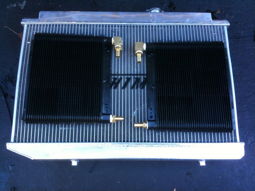

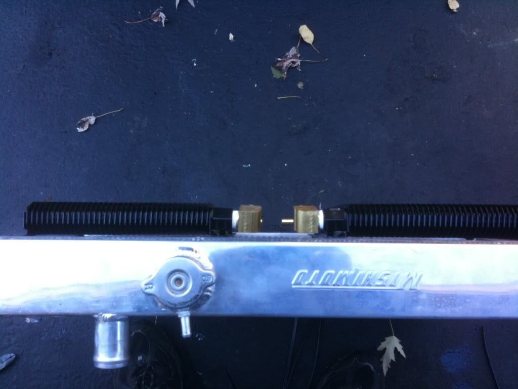

Hey all, where have you guys mounted your oil coolers?
Anyone mount directly to radiator? I have two B&M Super coolers 10x11 to mount in front of the radiator (No condenser) and thinking of mounting them actually to the radiator with tie straps.
Anyone mount theres this way or have a different way of mounting the oil cooler in front of the radiator? :1zhelp:

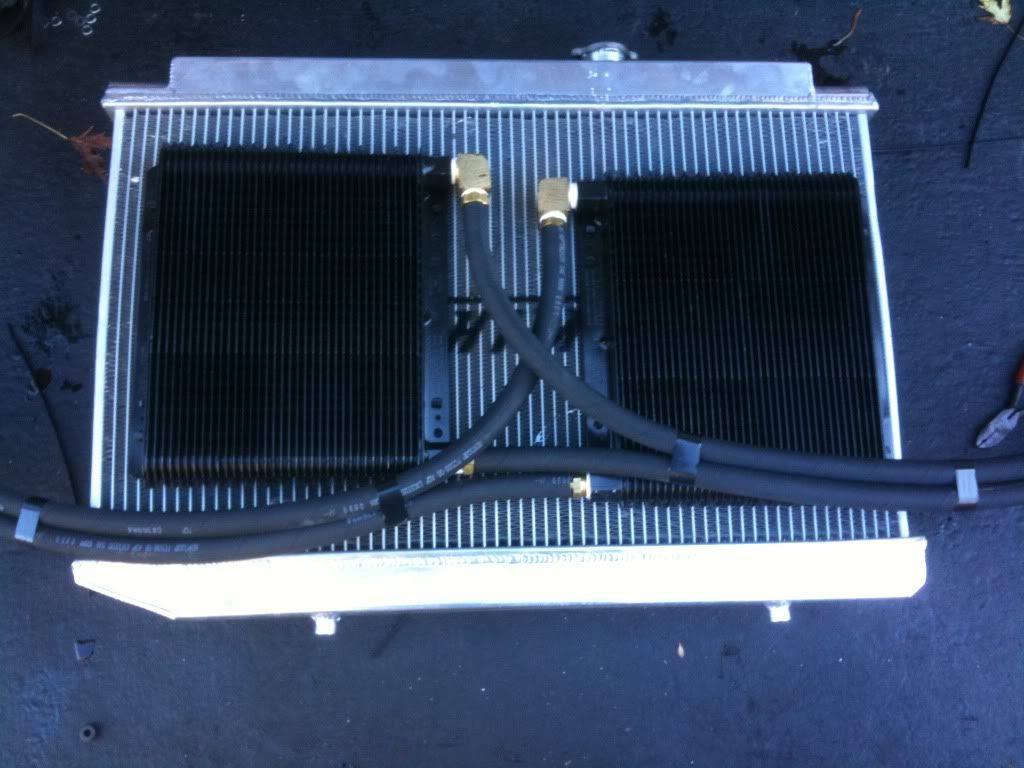

Oil and Tranny, Guess i forgot to mention that haha.

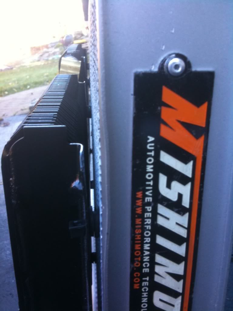

I think im going to just mount it to the radiator, i still have some rubber pieces laying around from when i trimmed the radiator mounts for the mishimoto, ill just stick that between them.

I will eventually be ducting the entire front of the car to the radiator opening including a lip under the lower radiator support to guide all the air from under the bumper up into the radiator like how corvettes have the radiator opening in the bottom of the bumper. So im not that much worried about airflow, also the Mishimoto radiator is F'ing HUGE!
Also as Adam said, the condenser would cause similar effect, though i think the fin spacing on the condenser is a little more open as compared to these coolers.

garebear1319
Jul 7, 2009
82
MA
The only problem i see with the set up is corrosion over time metal to metal contact usually results in such a thing faster then just metal alone, and espcially since they are soft metals. But i mean i have mine right in front of the condensor so it goes rad, ac cond, oil cooler, intercooler and have had no problems with air flow and still get really good cooling. Good luck with this and LOL to the redneck hot tub.
