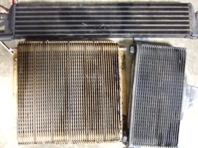

I picked this up at the wrecking yard the other day, its almost idendical to a B&M stacked plate cooler and measures 11X11
which should barely fit with my new intercooler location.
This is the only concern I have with it.

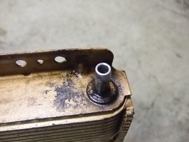

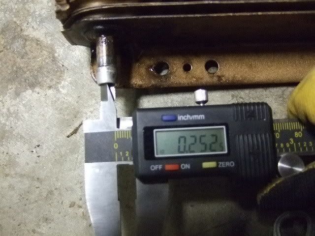

The ports are quite a bit smaller than the 1/2 inch lines I will be running but the cooling capacity should be more than enough.
Im debating on wether I can just live with this as it saves me $70. Or will it cause problems having ports that small???
Any input would be greatly appreciated here. Good enough or spring for the B&M ...66 8.5X11 cooler???
