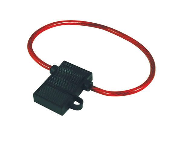

If you plan on using the Flex-A-Lite Kit, the first thing you need to do is throw the supplied in-line fuse holder in the trash and spend $7 bucks on one of these.
