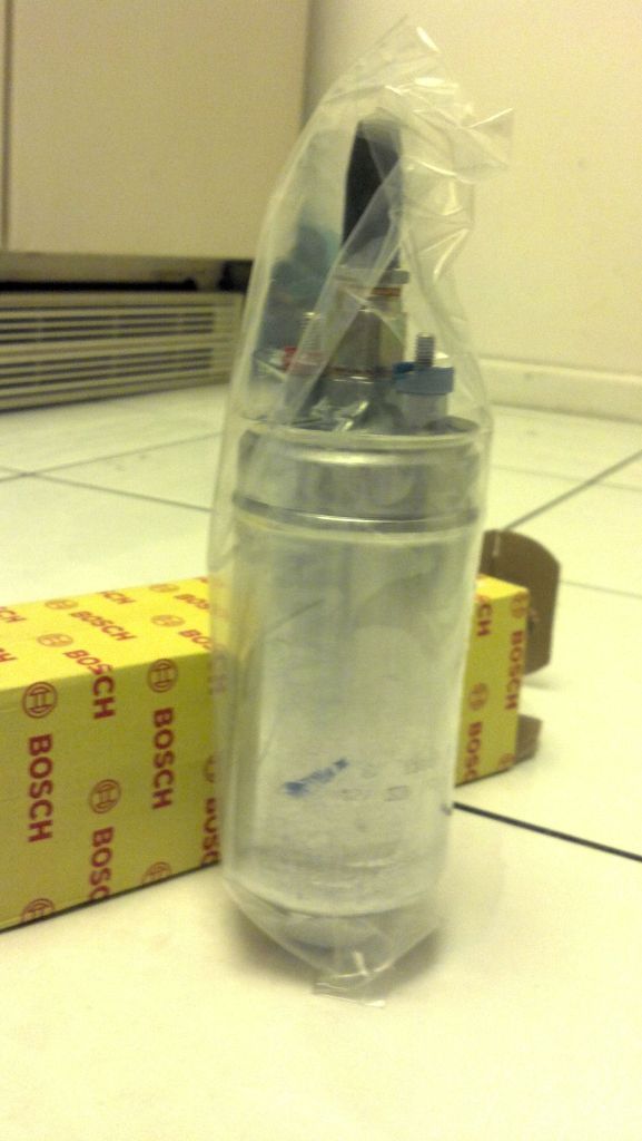

A component of the single turbo project arrived today. A pair of Bosch 044 fuel pumps will be used:

IBoughtASupra;1800675 said:
One intank and one outside?
The current Walbro inside the tank that will feed a surge tank, then the two fuel pumps will be inline with the surge tank.
IBoughtASupra
Mar 10, 2009
4,455
Queens, NY
Great ideal. The Walbro can run at 9V all day barely doing any work a d the two Bosch will have all the fuel they need from the feed line. I assume you are running the return line through the tank as well? It's what we did on a customer's car and it works perfect.
Good comment about the return line. I'll have to look into that. Thanks!
It makes sure without a doubt that the surge tank will not run out of fuel no matter the RPM, injector duty cycle or boost level you choose to run. Definitely look into it!
