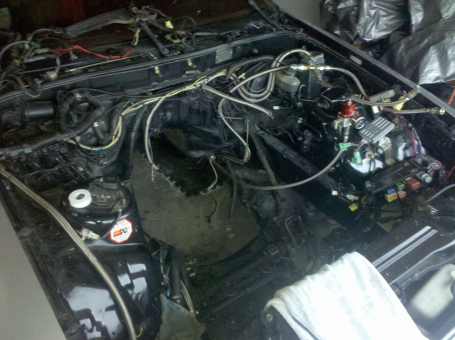

ok so im very very lost in the electrical in the car now. my mission is just to get interior power. what i have hooked up
ground cable to engine and fender
ground for ecu
alternator power
battery to starter
brown connector on starter
test i have done.
checked battery voltage 12.3V
i did a conductuity test on under hood fuse box fuses, they are all showing as grounds, but nothing on positive.
i checked voltage on fuses, nothing.
so i basically gave up at that point, i jumped the radio fuse inside the car, because thats what i wanted anyway. my police scanner turned on but radio didnt, i figured this is because it has ignition power wire hooked up. so i jumped both the ign. and raidio. and then the scanner turned off. well then i noticed that when shaking the scanner and radio that the clock would dim and come back on.
so now im starting to think wtf.
so i hook the battery to the charger to a 12v charge while im trying this crap out.
i tried to jump the ign and radio again i got the ign jumped and then get ready............. the window wipers turned on. and may i put that scared the shit out of me because there arent any wipers on them lol so it was metal to glass so all i hear EEEEEEEEEEEERRRRRRRRRRRR. lol so im like wtf. then i jumped just the radio and all the interior lights turned on and guess what, the wipers. and may i put the wipers are on the off position at the switch the whole time.
am i missing somthing here? or is there just that bad of a short

Did you mess any wires up moving them under your fender? I feel you on time. I really expected to be farther along than I am. I just keep getting distracted with Motorcycles. But I was in the shop today dealing with wiring inside. I still have to put my motor/tranny in. Starter will be here tomorrow so maybe tomorrow I can drop them in. ONLY I have to beat the trans tunnel for it. Keep it up and I would make my next big investment in the same thing I said before. FFIM. It is tax time. And there are a few in the classifieds.

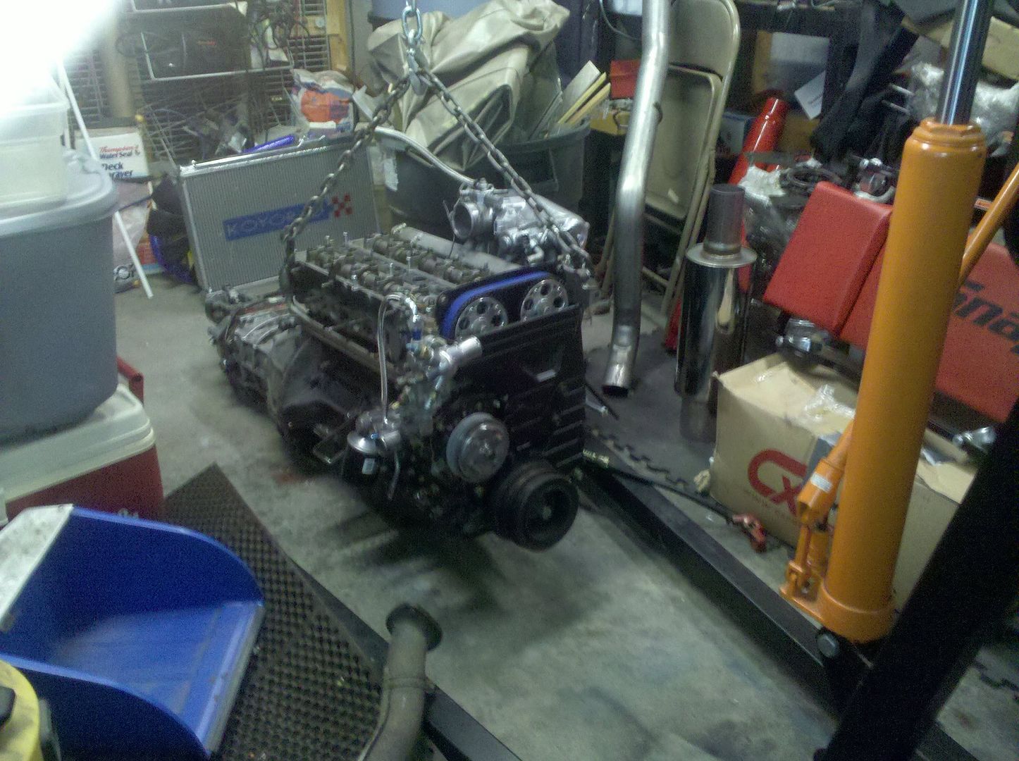

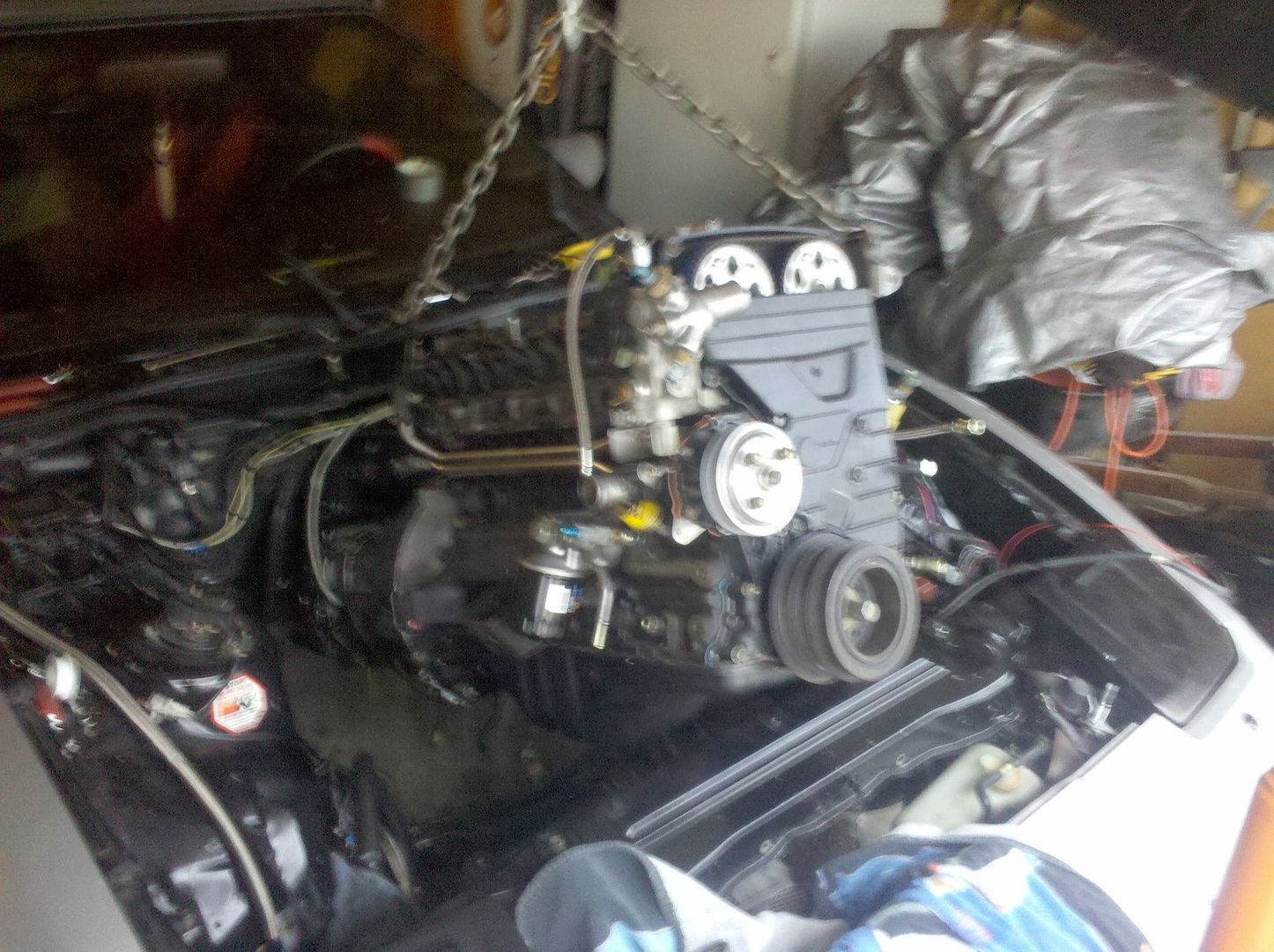

Trevor, pics of your engine out of your engine bay? How long til your entire engine is apart enough for your inspection?
northwestsupra
Sep 19, 2006
1,166
Washington, Marysville
adam update your sig, your not running 400RWHP with a NEO lol uploading pictures now. i havent ripped into it yet. but will today soon

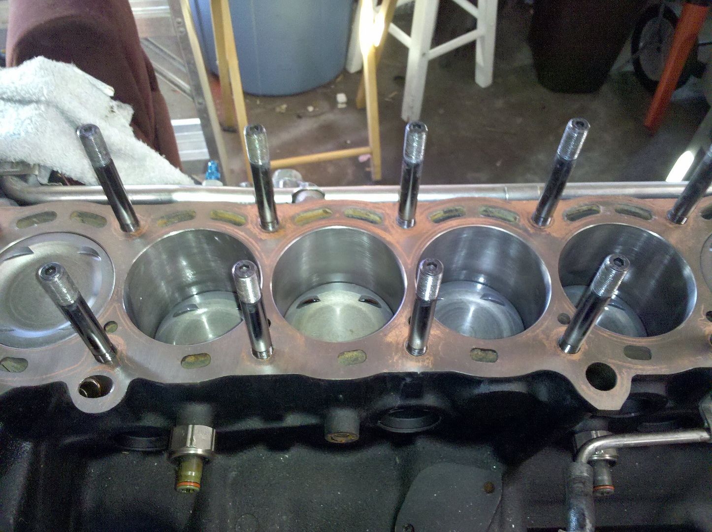

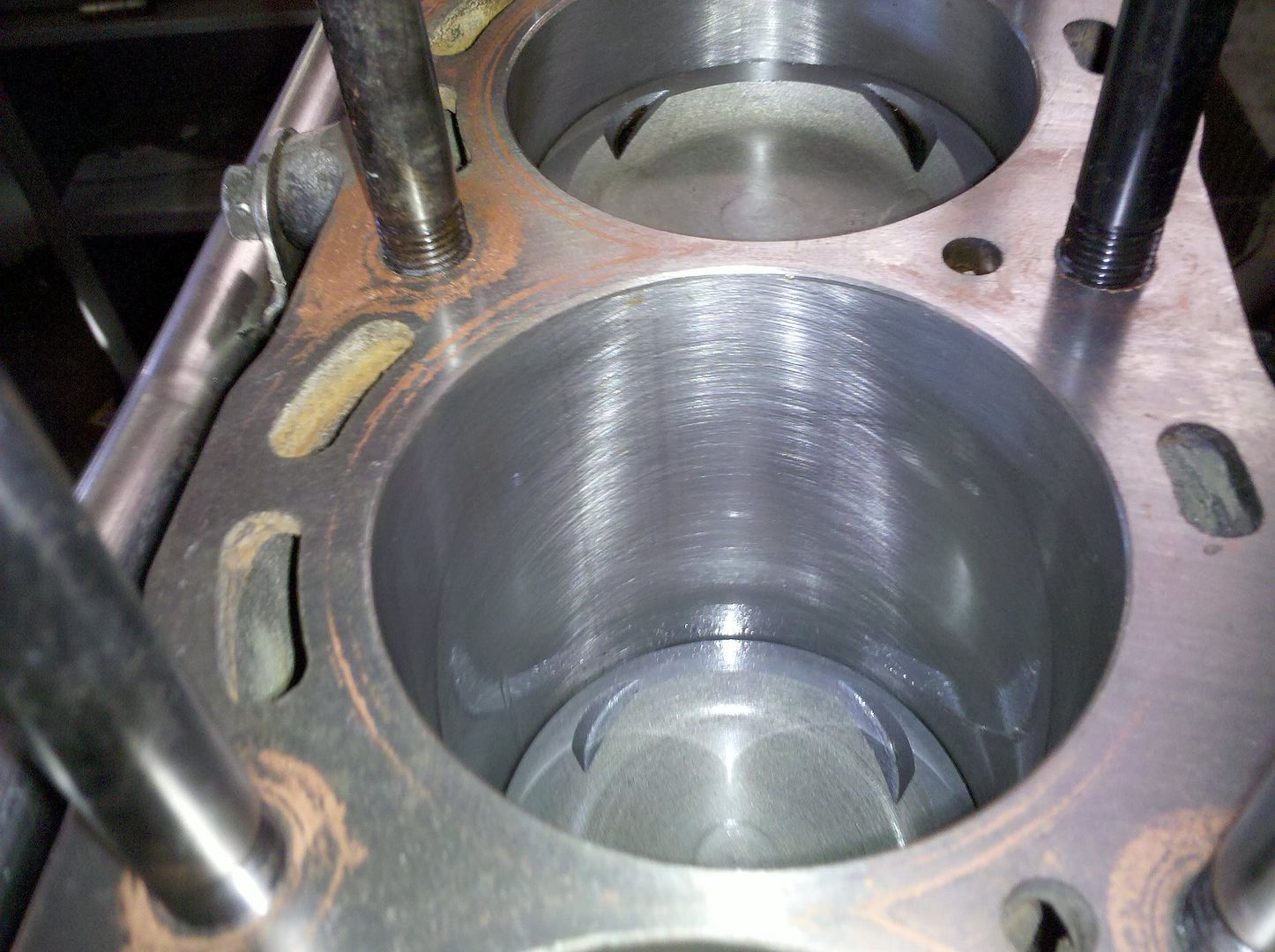

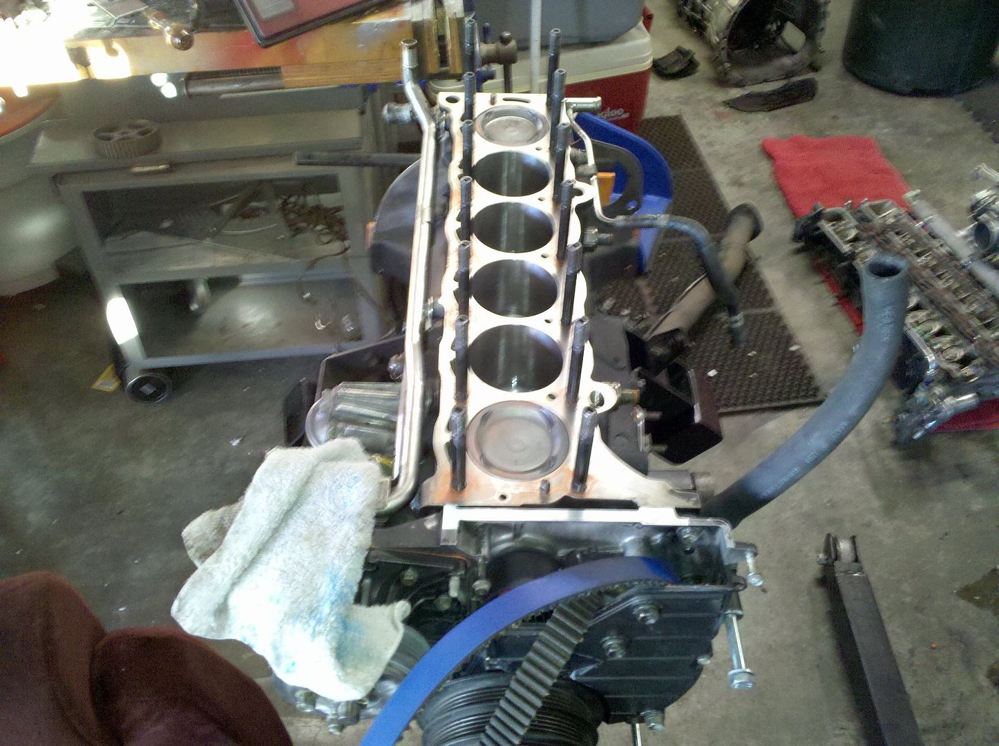

so i have finally finished pulling the head to see the damage, guess what NONE!!! WOOOO clean as day. all of the rusty colored crap on the surface is just copper spray "easy to take off" tomorrow i will pull the bottom apart and see whats going on in there, if anything.
the reason i am looking is because its pretty hard to start turning it over manually. it sticks at the start, but once it starts to move its very free moving "not like its on ice but its got a little resistance" but if i let it sit still for about 1-2 minutes it freezes up again. anything anyone thinks i should looks at, the mains are coming off so i can put some oil in it but thats about it. then i will spray the surface and walls with wd-40 to keep it rust free, then i will place the engine in a corner where it will sit untill i get my parts lol
