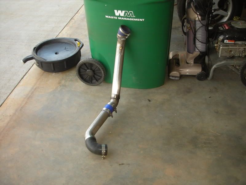

.84 AR, besides I connected the vac line today and took it up to 6,000 and still no boost. :icon_conf
As for the wastegate I didn't place the curved adaptor plate on, which may help the valve on the wastegate seal. I just placed the wastegate directly onto the pipe with no adapter plate so that's probably what's causing it to leak since I can hear the turbo spooling around 2,000 rpm it just doesn't build boost.
:nono:
ummm...
yeah, :nono:
edit: << see my avatar.

LordLo said:
Luckily, my stupidity saved my engine. :biglaugh: Hopefully, this adaptor plate helps.
thats a good point...but hardly something I would advertise, lol
if what you have is the HKS style gate and an ebay manifold...then yes you need the plate. It is in fact the seal. do not put a gasket in there either.
