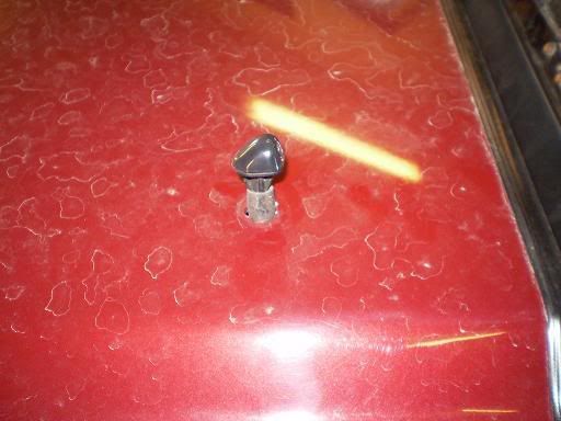

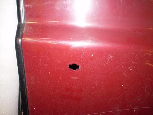

Difference...
My 87 hood
My spare 89+ hood
Fuck.....don't want to mess with the paints :S :S

You shouldn't have to modify the hood in any way to put these in, if you have an 89+ that is. If you have a pre-89, you can get a newer hood (what I am going to do), or Dremel out the holes.

Mine was different on the bottom, the way the hoses went into them were different. That's why i had to dremel them slightly to fit. The hood was an early 89 N/A so that might have something to do with it, i don't know.
