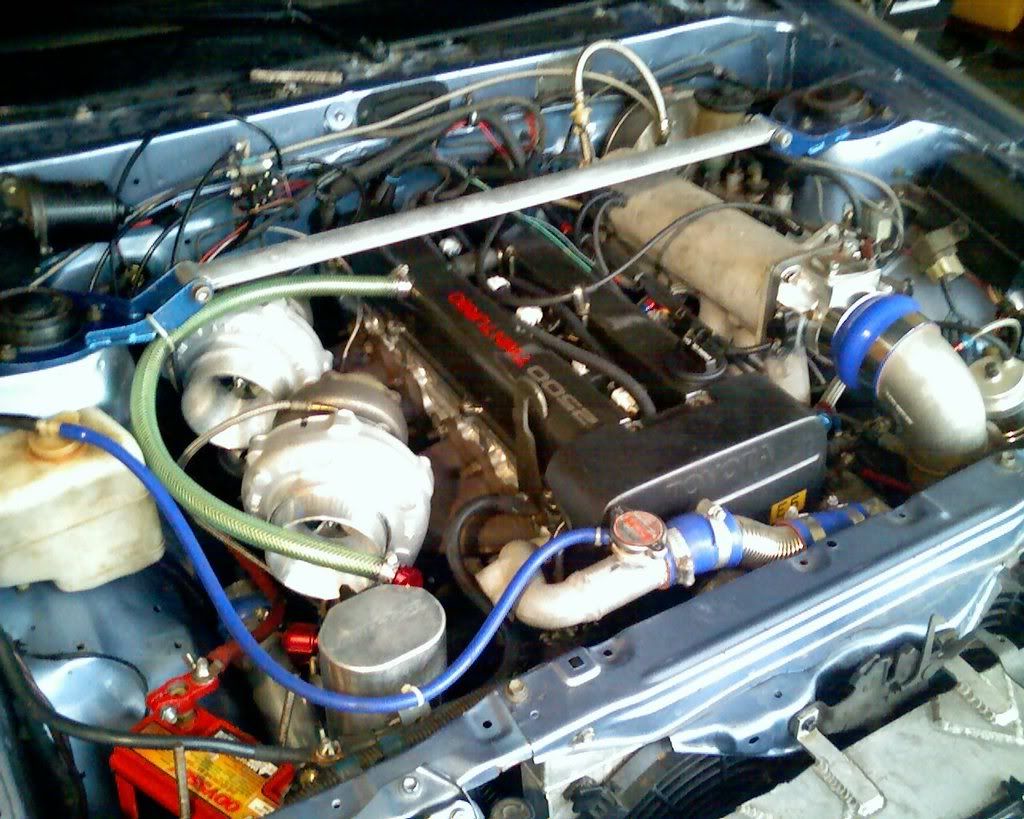

I will post some pictures of the car later on. The block has stock pistons with crower rods. I managed to run 8.97@150 on a 100% stock internals engine, but looking for more power, be safer down the track and take better the higher reving engine with cams that were installed I had to put the rods in. Cams are crower as well as the rods and spring & retainers. Microtech engine management, 800cc injectors and twin gt30's. No work on the head, 2jz head gasket and arp head studs. That was my first full pass with this set up. It didn't hook up as it should have. Go to streetfire.net and search hiper racing and see corolla 1jz launch and some more passes. Thanks guys!

Here are pictures of the engine.
