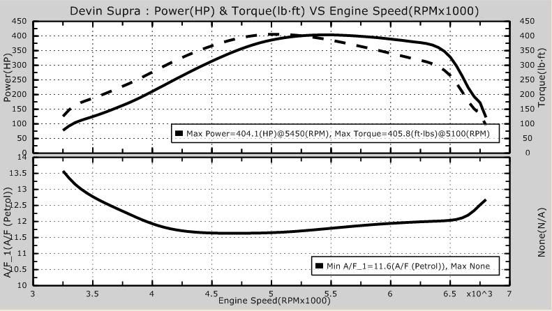

New power!!!! 404HP 405ft lbs @ the wheels CT26 on 17.5lbs

You will go well over 400rwhp with the added comprssion.
Lower temperature alone should be enough to break the 400whp barrier...

The way I yielded the higher compression is by going to the thinest head gasket available 1.2 compressed and removing as much material off the head and block possible without making it an interference motor. It has a 12 thou positive deck height and just enough piston to valve clearance to get by. The car is making some breathless now!

17.5 psi not bad..

Nice numbers Devin, knew you'd clear 400 pretty easy. You still haven't done cams or any head work, have you?

Stock head and cams, however the cams have been degree'd to help with top end power.
