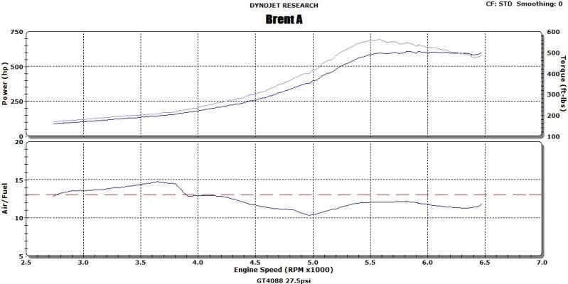

New dyno results: (627hp / 574tq) GT4088

MK3Brent;1372026 said:
Built engine.
SSAutocrome manifold, modified for TiAL F38 W/G, and a turbo riser.
2.5" IC pipes
Spearco bar and plate IC
TiAL 50mm BOV
Sethron FFIM
VPC, AFC, EVC.
2x Walbro 255 pumps
680cc Precision injectors
LIPP fuel rail (dual feed)
Aeromotive AFPR
MSD DIS4
Gauges and stuff.
Probably about it.

Yessss, that DIS-4 definetly went to a good home!!! Awesome numbers Brent, now lets see this thing on your makeshift anti-lag.

4800ish rpm on the street, little later when on the dyno.
Base timing was like 10ish I think. I don't remember.

very nice numbers!!!
whats the inside of the motor look like? full build or stock"?
JE's, crower rods.
As for injector duty, I have no way of knowing for sure as this is a VPC car.
I'd imagine the 80+% would be reasonable.
I'm using 2x Walbro intank pumps dual feeding an aftermarket rail.

Brent, you know what rpm the torque peak was at? I would try and estimate by the speed on the dyno, but I have no idea what your tire diameter is/was. TIA.
