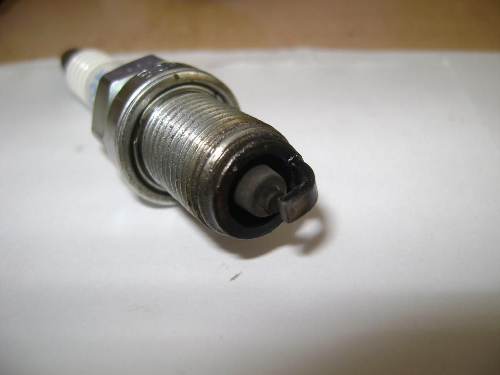

Here are pics of the plugs.
Plug #1 (300miles)
Plug #2 (150miles)
Plug #3 (100miles)
Thanks

That's what any plug that's misfiring looks like...
If it was all of the plugs, I'd say they're too cold. Generally speaking though, if you replace plugs and you still get the misfire, you check the rest of the ignition system. If all the parts there check out, then fuel system. If that checks out, then mechanical condition with the engine.
As we have a wasted spark setup, and you don't have any issues with the corresponding cylinder, I'd be looking at the wire...

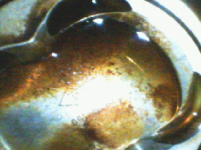

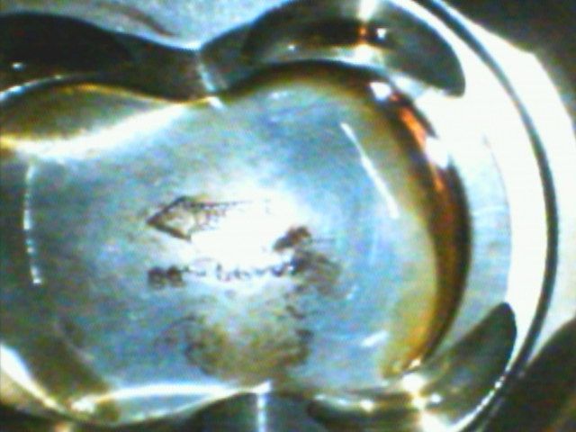

Ok Im too tired to do any of the testing tonight, I will post tomorrow with my findings. Here are the picture of inside Cylinder 4 and its neighbor Cylinder 3. Just like the spark plugs only Cylinder 4 looks like that all the others have a nice tan colour on the pistons.
Cylinder 4
Cylinder 3

Both pistons look like they have oil on top of them. Try running the car to get rid of the oil, pull the plug and inspect, if there is no oil on top then manually set the number 4 cylinder to TDC and let it sit overnight(or several hours). Check it again in the morning, if there is oil on the top(assuming there wasn't any the night before) then you have a leaking valve. Hopefully that makes sense.

Its not oil confirmed it this morning. Its fuel on top of cylinder 4 piston. I'm checking the injector wiring.
