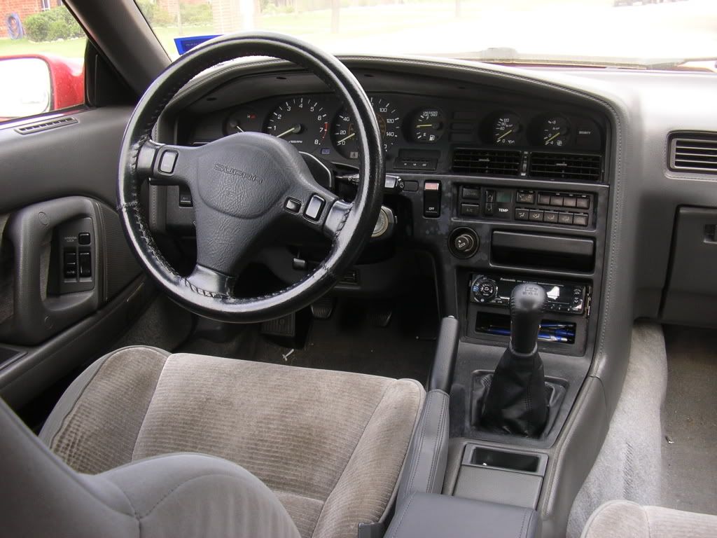

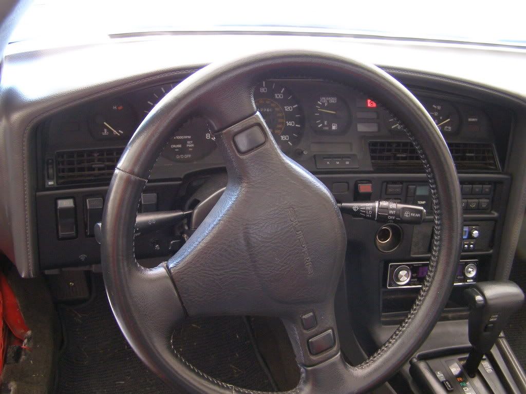

I recovered my '88 wheel myself. It takes some work, but at least you have the satisfaction of doing it yourself. I carefully cut the old leather off along the stitches and made a template out of cardboard. I went to an auto reupholstery shop and got some nice perforated black leather. After cutting it and stitching it I had about 7 hrs into it. I'll send you a pic if you like.

on their way... their we go. Pics not the best, but all I can do with camera phone.
Looks good, but the wheel is a little thin...I think there is a layer of padding underneath the stock leather...it makes the wheel more cushiony, and thicker...I've been debating if I should find another steering wheel with the original leather still there (doesn't have to be in good shape) and putting the wheelskin over that...so that it isn't super skinny, with almost no cushion.

Jonathon1 is right, there is a layer of rubber underneath the stock wheel. I went with two layers of perforated leather on this. It has some cushion, not alot. It's nice in the summer, breathes good. I made a few of these, this one's a spare. I'll try the '90 project car's wheel next, while the motor's getting ripped.
