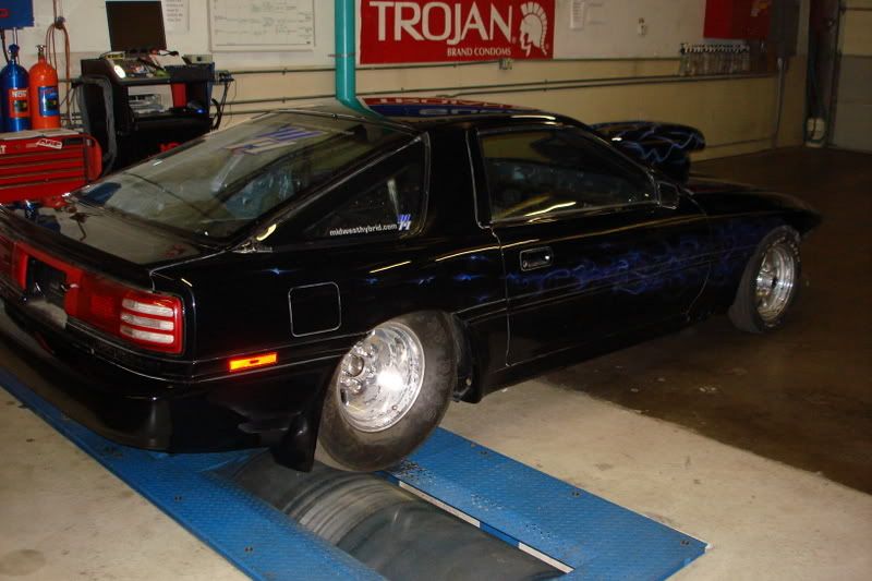

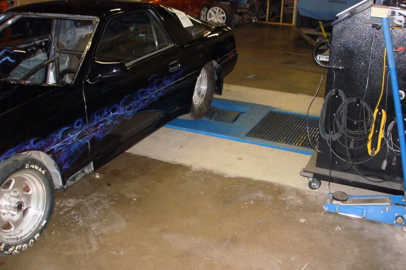

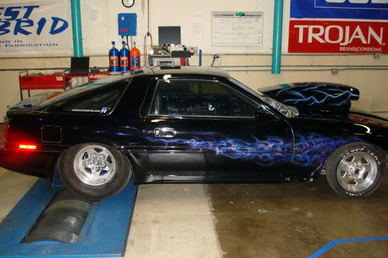

since i have no updates on my supra and i like to give you guys somethin when i post here, here's a civic i tuned today. it's a '92-5 civic hatch w./a stock internal honda crv 2.0 block, integra vtec head, ebay turbo kit at @ 8lbs of boost. it made a consistant 312hp/240lbft, all under 6,000rpm. not bad imo. i used the simple crome ecu stuff for management. i was seriously impressed.
sorry i didn't get better video. : ( we were so damn busy i just had no time. i didn't even get the cam out for the second car we tuned today...

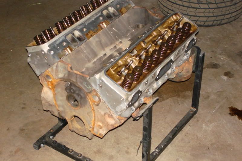

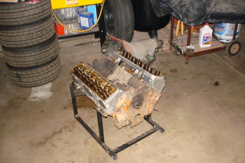

anyway, since my part buyin' budget has been low i have been researching my engine build a bit more seriously, and i have made some recent ebay purchases. first to arrive (today) were these aluminum lt1 heads. they are '93+lt1's w./53cc combustion chambers, reverse flow cooling, etc...
i didn't take pics of the new stainless manifolds for some reason...
i set the heads on my old 4 bolt 400 block that came out of my '86 4wd toyota pickup (took the 400 out and put a 305 in before i sold it). i plan to put the eagle 8:1 forged rotating assy in the 4 bolt 400 for sure! not sure on displacement just yet tho (custom crank'd sub 300cu.in.=lotsa revs?), thinkin' de-stroker 300cu.in.=9,000+rpm... next to show up is a complete '95 lt1 intake w./injectors, rails, reg, t.b., etc... i'm gonna have lt1intakes.com do the mods so i can use it w./my gen1 block/lt1 setup, and i have already researched the required head mods needed to use everything on the gen1 400 block. this of course should get along well w./two properly sized turbos...

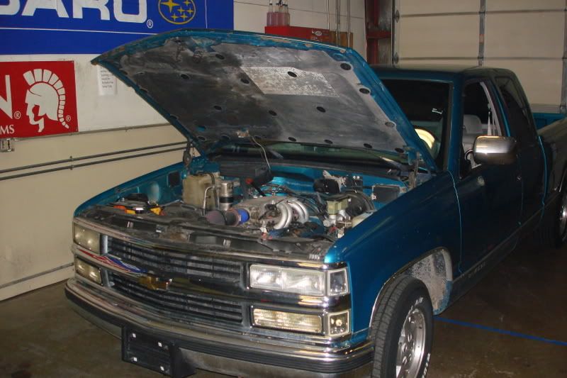

this is my old shop truck (upgraded to a lowered big block crew cab dually last fall). i was thinkin' about takin' the l98 out of it and putting the forged rotating assy' in it for the supra, but i think tpi is just a lil' out dated... anyway, peeled all the shop vinyl off today so it can go up for sale soon. if anyone is lookin' for a nicely done truck let me know, it will go cheap.

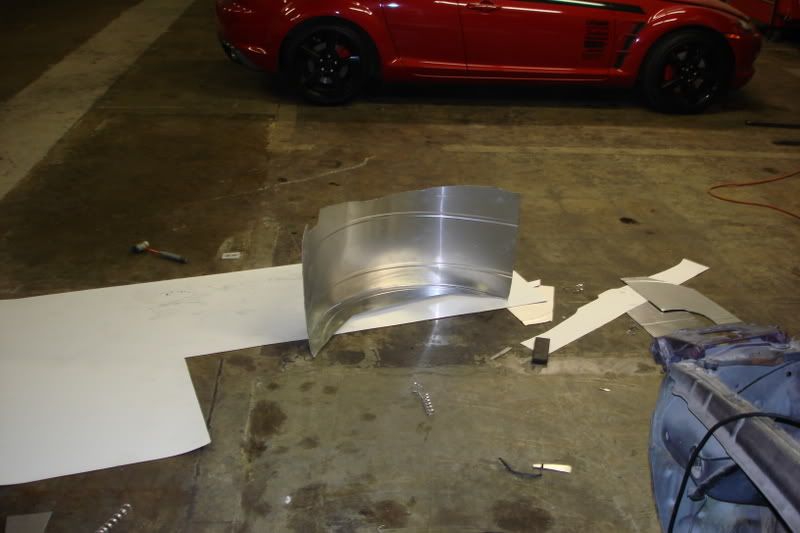

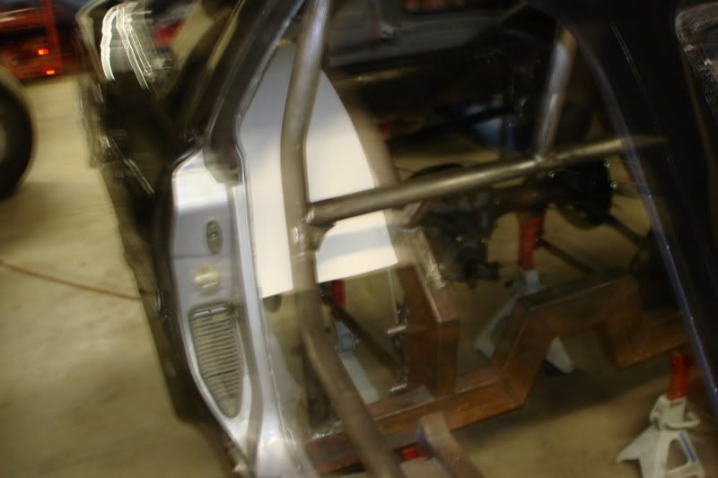

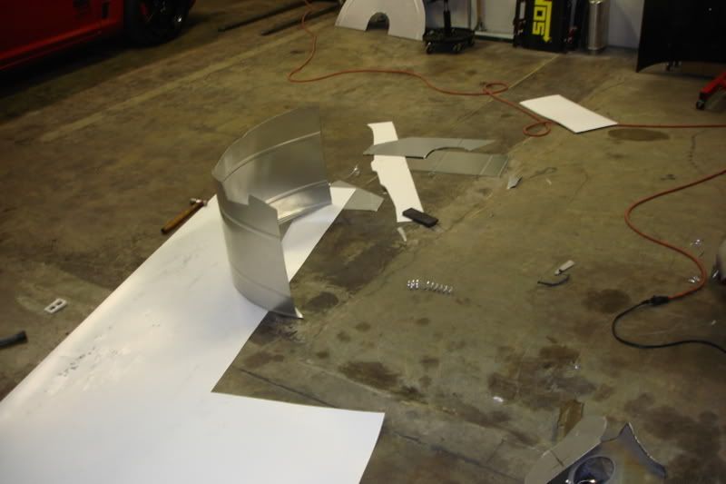

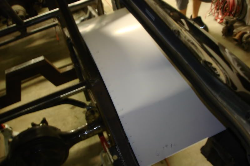

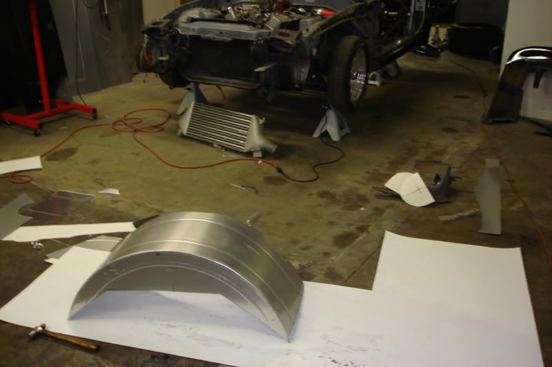

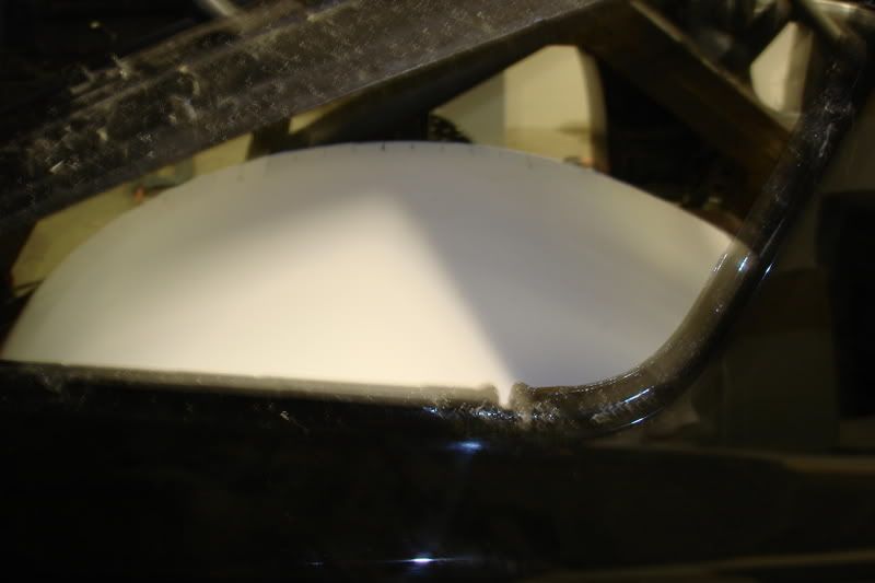

last nights progress, in reverse order...
not bad for my first time playin w./sheet metal...
