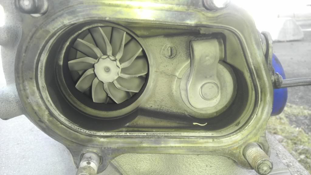

I have a 92 Toyota Supra Turbo and yesterday I found out that I have a small crack on the exhaust side of my turbo. I heard that you can destroy your engine even though you have a tiny crack on your turbo. so was wondering what I can do to repair it. I also notice that this is also a common problem with ct26.

Cracks on CT26 a common problem? That sounds new to me.. i never heard of it being a common problem.
I myself have tiny cracks around my wastegate but its never been a problem for me!

I don't see why you couldn't just weld it back up! Thats what I am doing to mine once they get worse, And I have done it before with great success!

Mine has a crack and I run it really hard mine is also a 60-1 with a big exhaust side clipping. I push 17psi through this thing with no problems.
Only issue I have is boost drop off witch shouldn't be related to this tho.
