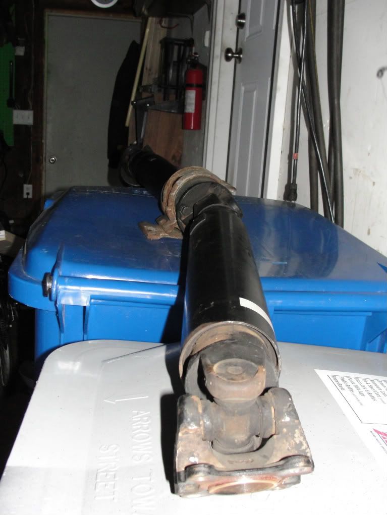

Sight along the Uni joints they should be perfectly in line o---o---o if not there's ya Vibes.
(common fault with these cars)
How do they go out of phase anyway? I know my carrier bearing is shot to hell, as well as the bushings in the rear, but it's not a constant vibration in my case, merely a 'thunking' if I'm not smooth.
64
Last tube that bolts to the Diff is 2 pieces rubber bonded, over the years the bond fails and slips.

Like this:
6,626
toyotanos;1778787 said:
Like this:
I see what you guys mean now, I didn't know that about the diff. Will have to look at mine next time I crawl under there. Thanks for the picture Steve, I had the right idea in my head, but this helped confirm it. :)
