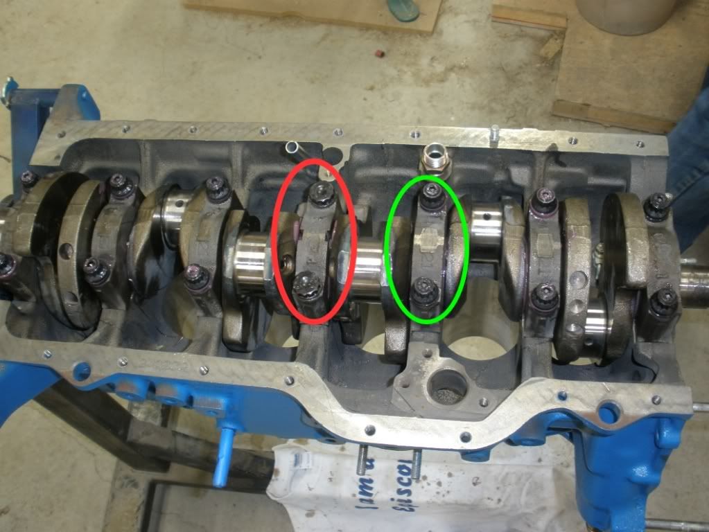

IBoughtASupra;1660464 said:
Did you call DriftMotion and ask about the ARP Mains not fitting right? Aaron will answer your questions with no problem.
yes! well i contacted him about something else and sent him a link to this thread and he read it and told me.
I guess there are two ARP bolts and i was suppose to use them on the main the the oil pump didnt fit by. but instead i had them installed in them in the middle.
The red circled ones need to go where the green circle is...damn :: angry :: my mistake.

So got the cover off today and down to the shop and the bolts all switched. Cover will go on after i get my new gaskets for the front from toyota. then ill put the oil pan back on too

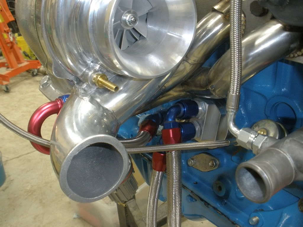

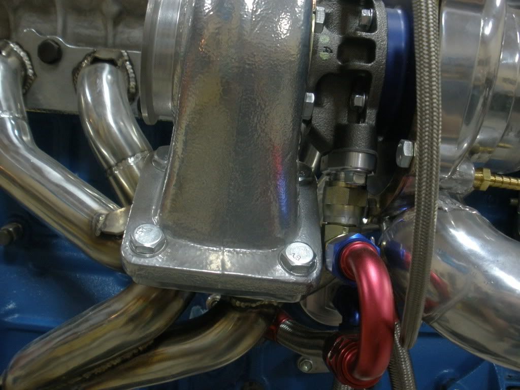

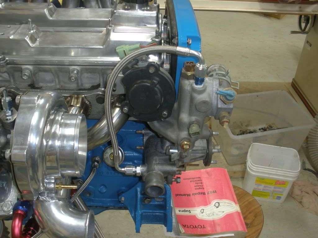

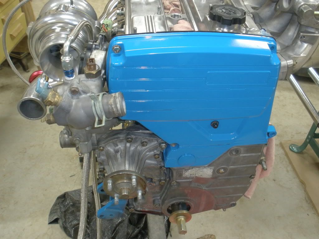

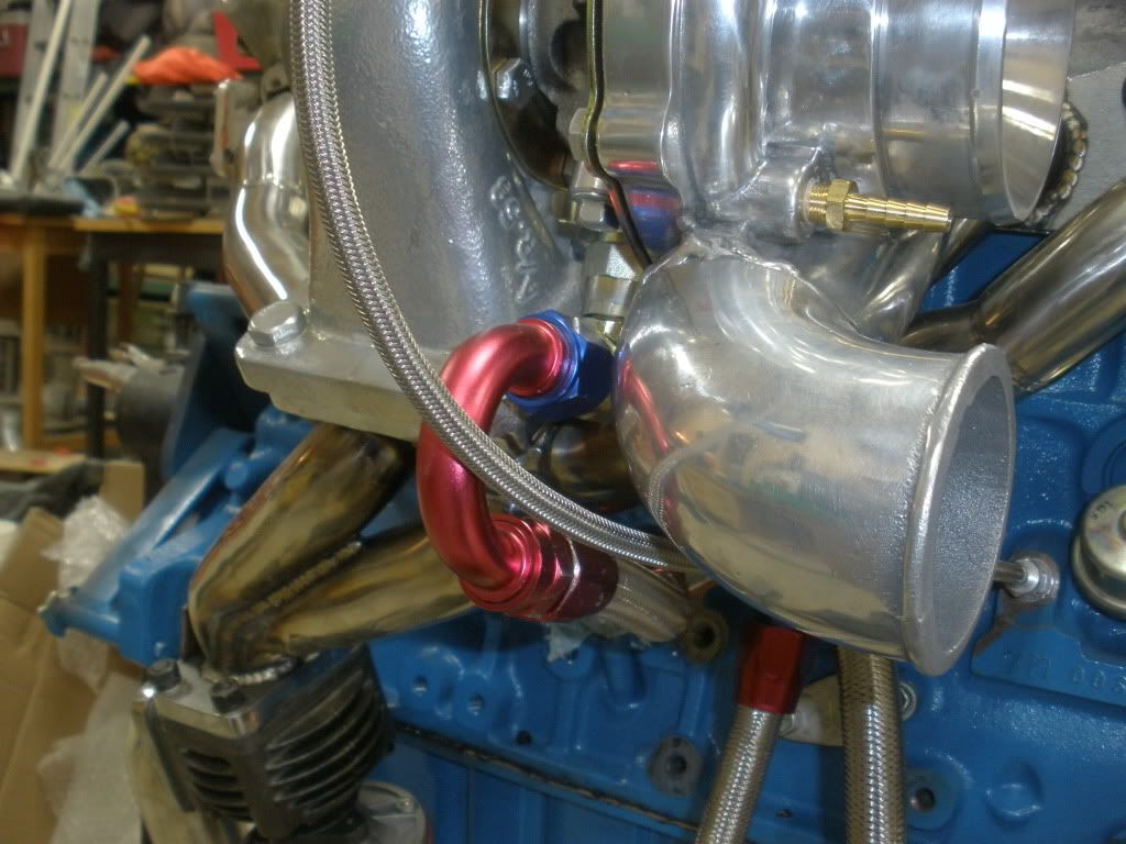

Hey guys. I have some new pics. Like stated above everything that was problematic is now fixed :)
redone oil drain
redone oil lines with 90 degree AN fittinges..just on loosly
CPS in! and the coolant bypass hose

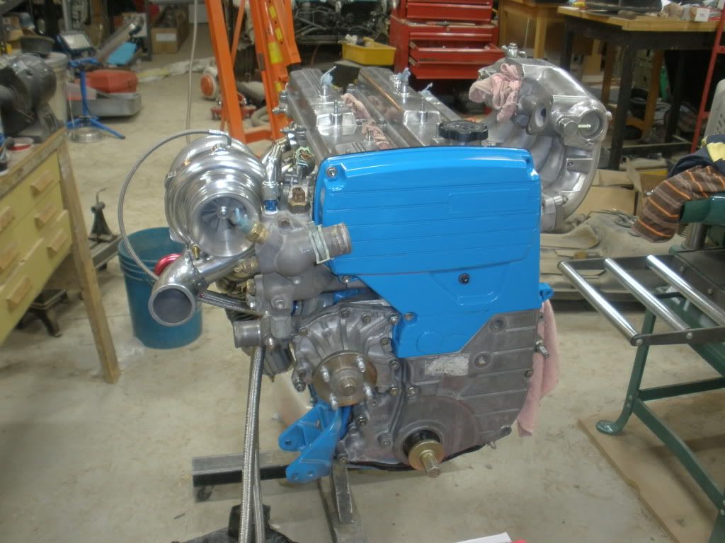

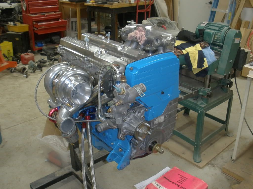

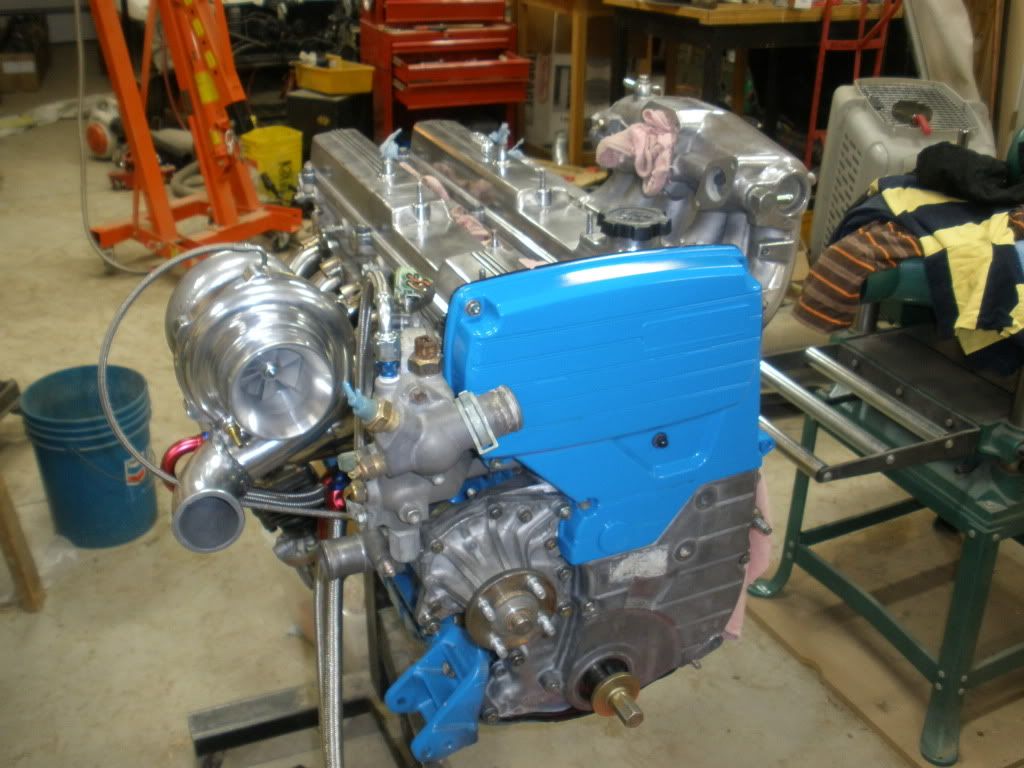

painted cover...thinking of leaving it off tho..
beautiful
IBoughtASupra
Mar 10, 2009
4,455
Queens, NY
A few question,
Is your compressor housing on loosely, it look like that in the pictures? It is okay for now but remember to tighten it before starting the engine.
Is that a new waterpump? If not, why are you not using on? Get one from DriftMotion. I believe it is only 55 dollars.
You should paint the timing cover in aluminum. Clean and sand it just like you did with the other parts, prime it and then paint it with aluminum engine paint. You will like it like that.
Lastly, how come you didn't polish any of the thermostat housing parts? If you want to paint them, you still can. I did paint the whole thermostat section on the 7M with it bolted on the engine when it was on the stand.
Just clean it with a cloth soaked in gas or break cleaner, let it dry. Get some masking tape with newspaper and plastic, tape everything around it including wires and sensors, basically everything that will not be painted and then start painting.
It will look a lot nicer, trust me. Make sure to get high temperature aluminum and primer. Duplicolor Engine paint works very well.
