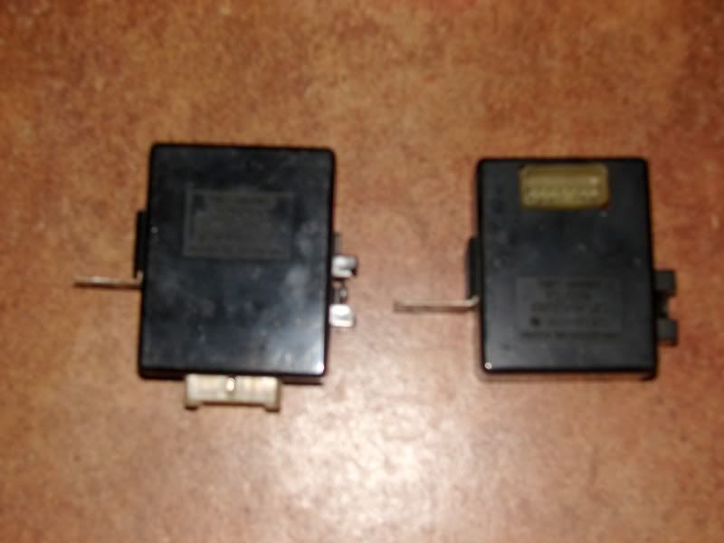

Look what I found! There are two different types, and I have never noticed that. The two have similar but different connectors. I've never seen anything about this, so I felt the need to post the picture, and give some info on those connectors.
This is what you are looking for to disable the alarm.
