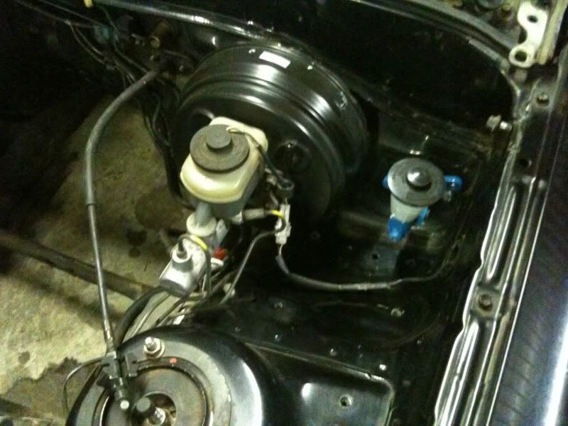

Today I got clutch/brake pedals for the car including the clutch line to do the auto/manual swap, started to do the fog light rewire so that the fogs come on without the head lights. Also sent my flywheel off to be machined/resurfaced. I think I can reuse the pressure plate so I'm trying to look for just a disk to replace it. I'm not sure if anyone sells the disk by itself for the Exedy Hyper Single Clutch. I had called Aaron from Driftmotion to see if he has anything that I could use. He said that this clutch kit is special so I can't just use any disk. I have to use the kit. Can anyone confirm this?

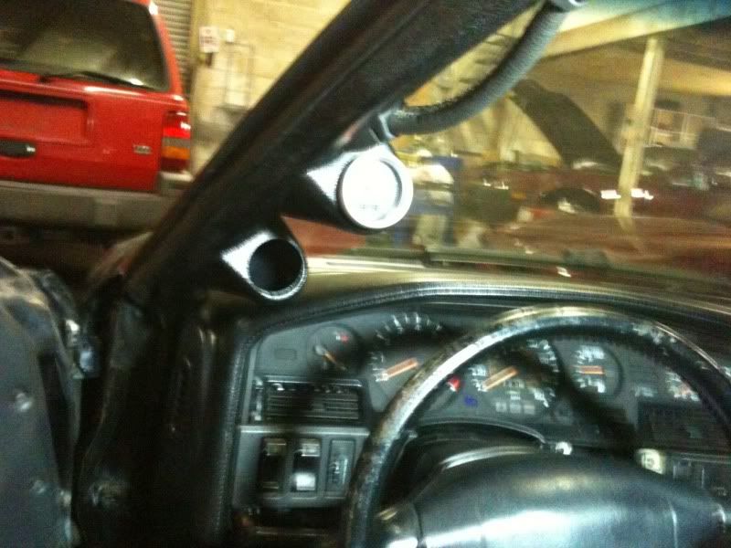

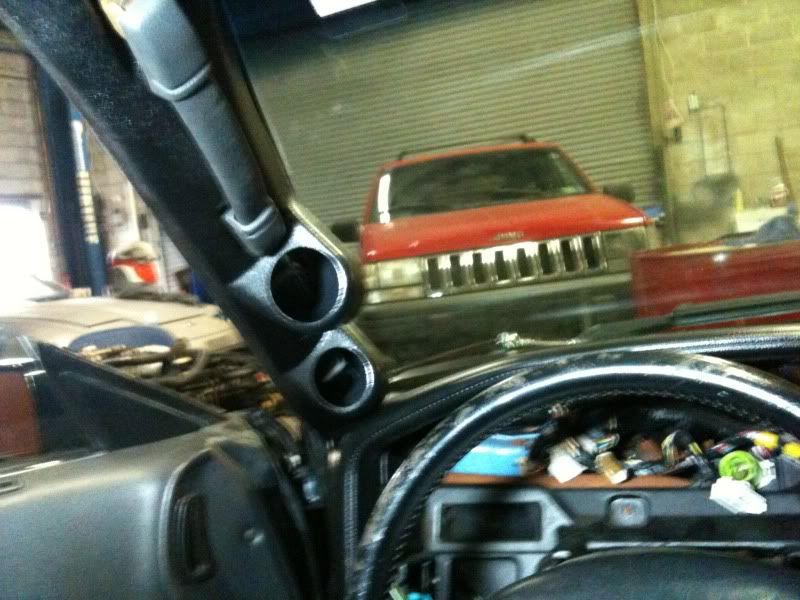

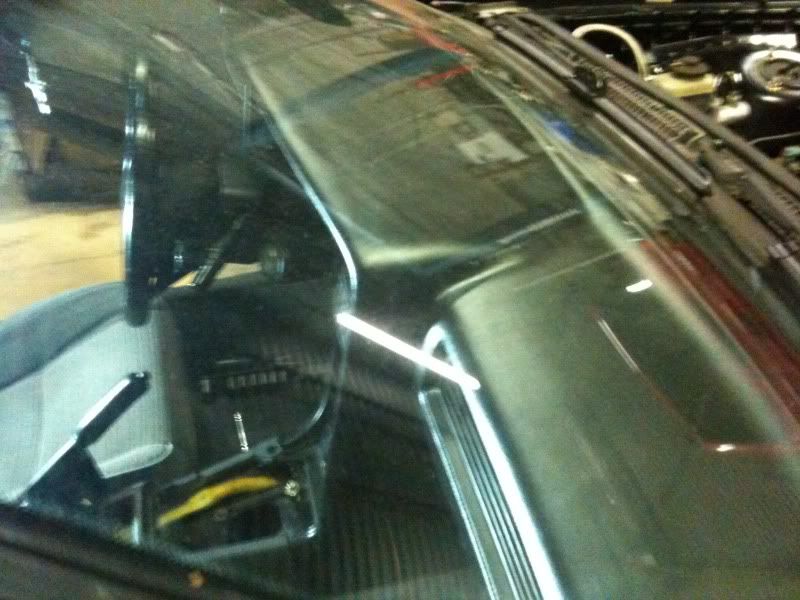

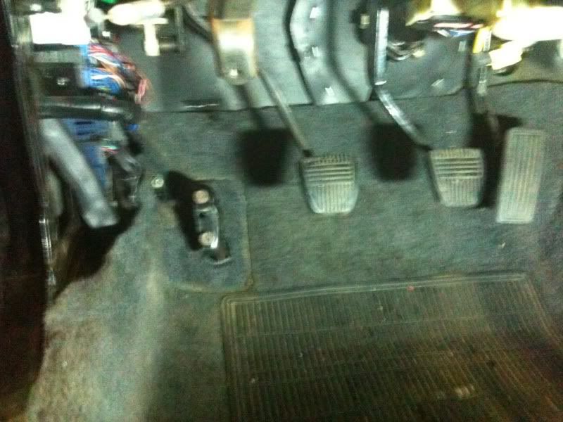

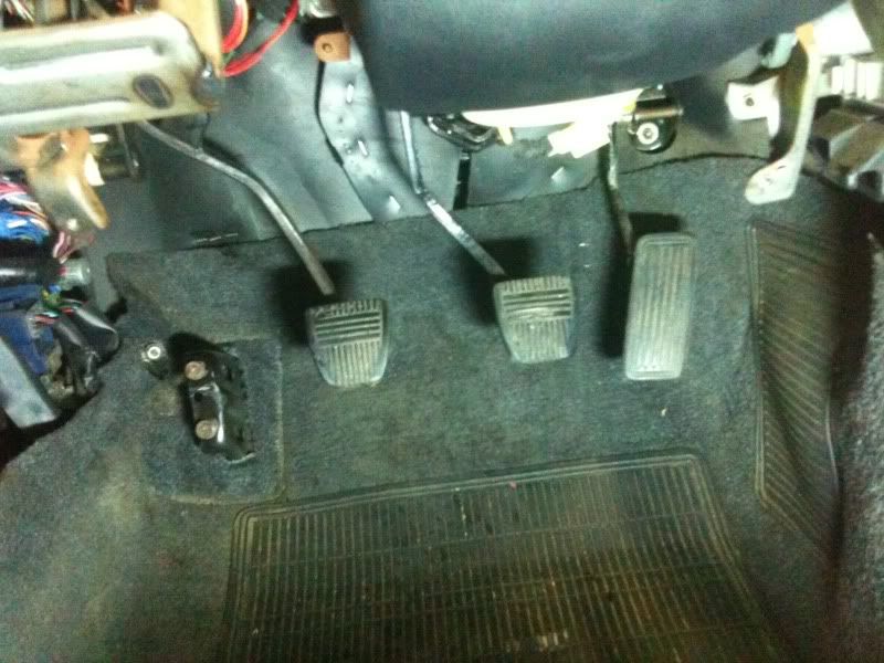

So today I thought I'd put the pedals in so I can get the dash back into the car so it doesn't get damaged,scratched or dirty sitting outside in the garage. I also dyed the dual pillar gauge pod. I'm going to need a couple more cans of the dye so I can finish the rest of the interior.
some pics...

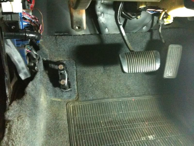

I went to go look at this car it was nice but now it looks a lot better.Keep up the good work.I'm buying a 90 auto tomorrow.How hard was the pedal swap?

The manual pedal swap is really easy. just pull out the pin from the brake pedal and the pedal will come out then just slide the manual one in place and put the pin back in. For the clutch pedal pull out the perforations on the black foam shit, and then the pedal bracket will bolt right in with three 12 mm bolts I believe, then when you put the master cylinder in just bolt it in and put the pin in that attaches it too the pedal. Very simple took me about a half hour to do it on my old 87 turbo.

yea the pedal swap are easy on our cars like he said^ For the brake it's justpulling the that secures it to the master cylinder. Use two 14mm wrenches and take out the bolt from the top of the pedal that holds it to the bracket. Pull the auto brake pedal out and put the manual brake pedal in. Secure it to the bracket and pop the pin in For the master.
The clutch pedal u need the bracket and the pedal. Remove the "foam shit" lol and you will see pree drilled holes up top and on the fire wall. Put the master in the hole;) and line upthe bracket. You'll need two 12 mm nuts and one 12 mm bolt.

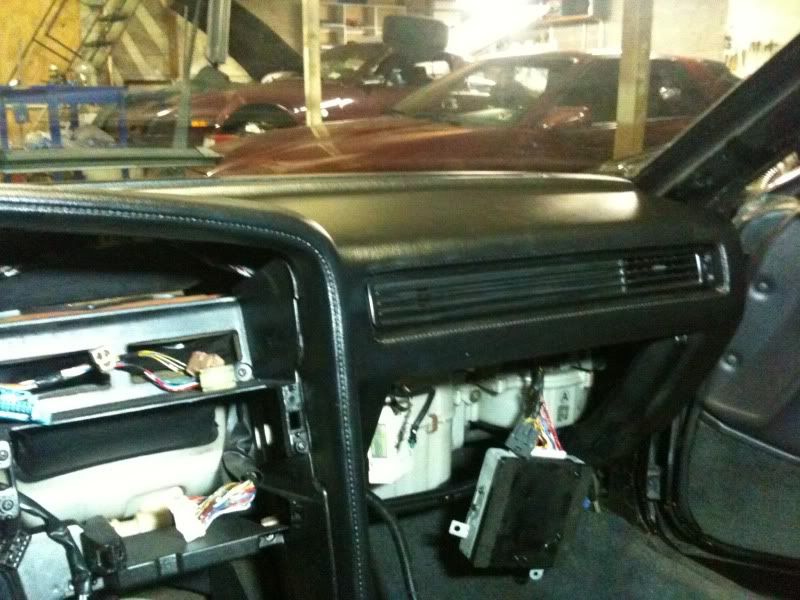

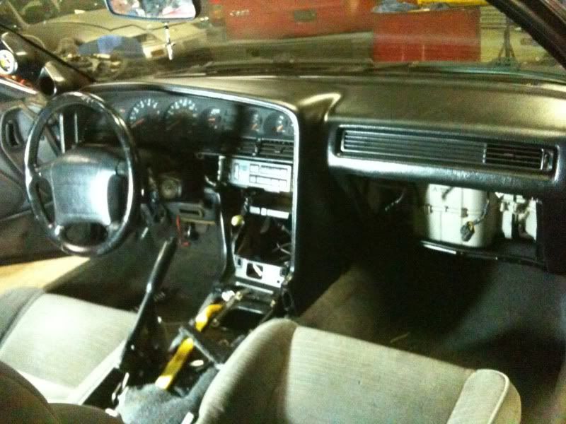

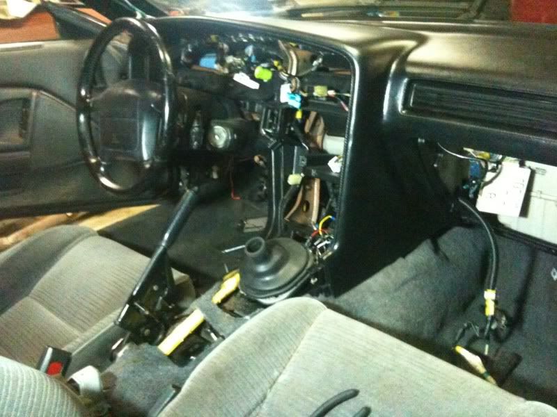

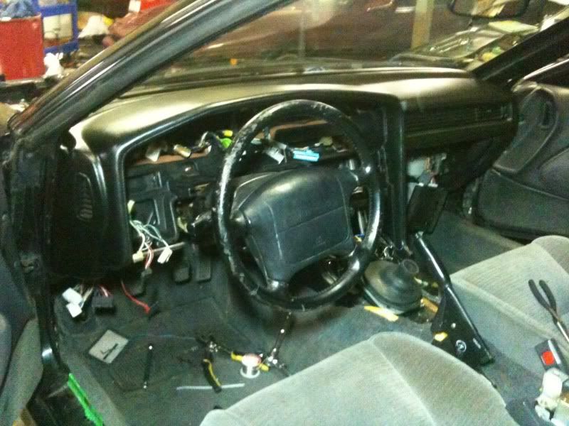

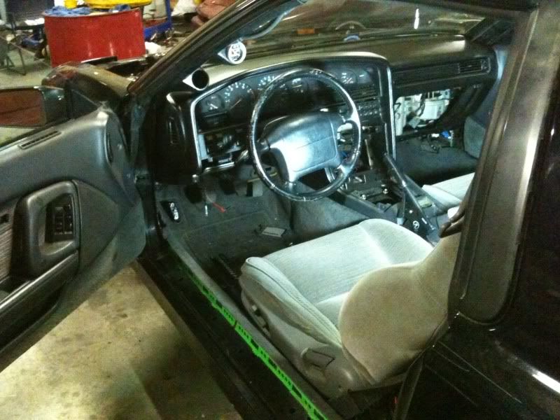

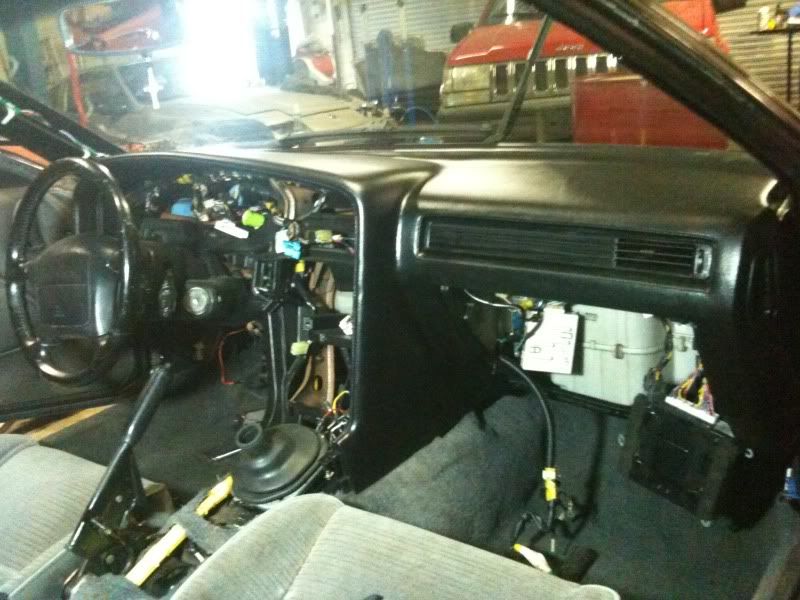

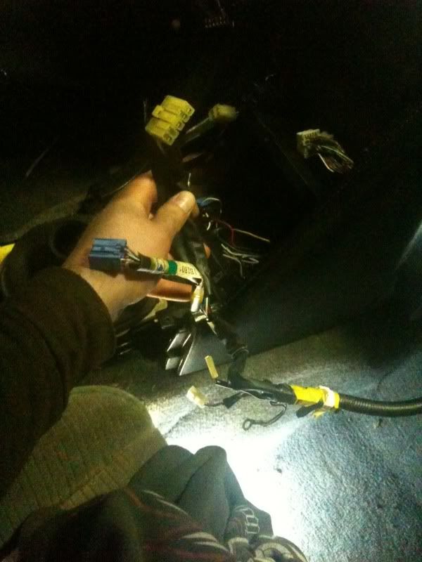

Yesterday I had to take the dash back out cause I couldn't figure out where a couple plugs went. No one could figure out what the plugs went to... Then I realized i'm an idiot and I routed part of the dash harness wrong.
These go to the ebrake, mirror switch and lumbar switch on the arm rest.LOL!:nono:

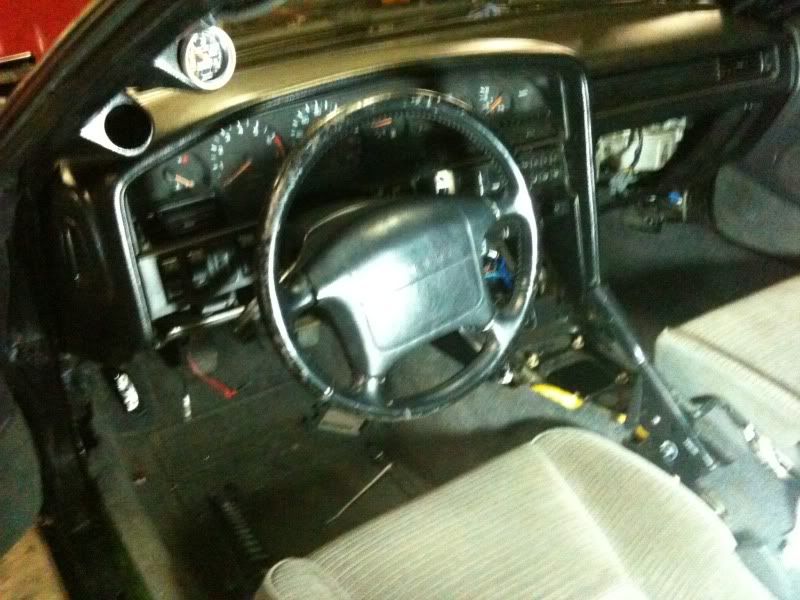

So I put the dash back in and started to put some things back together. I still need to get more paint so I can put the rest of the dash back together. Then I'll work on door panels and the rest of the interior...
for now... some pics. Starting to look like a car again:biglaugh:
