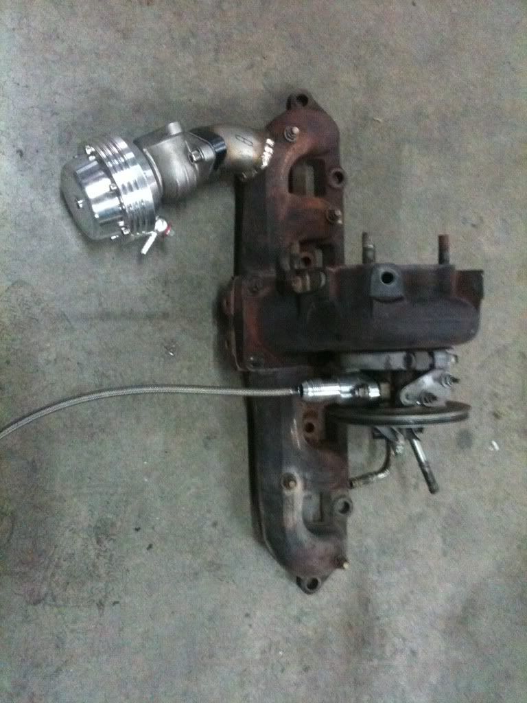

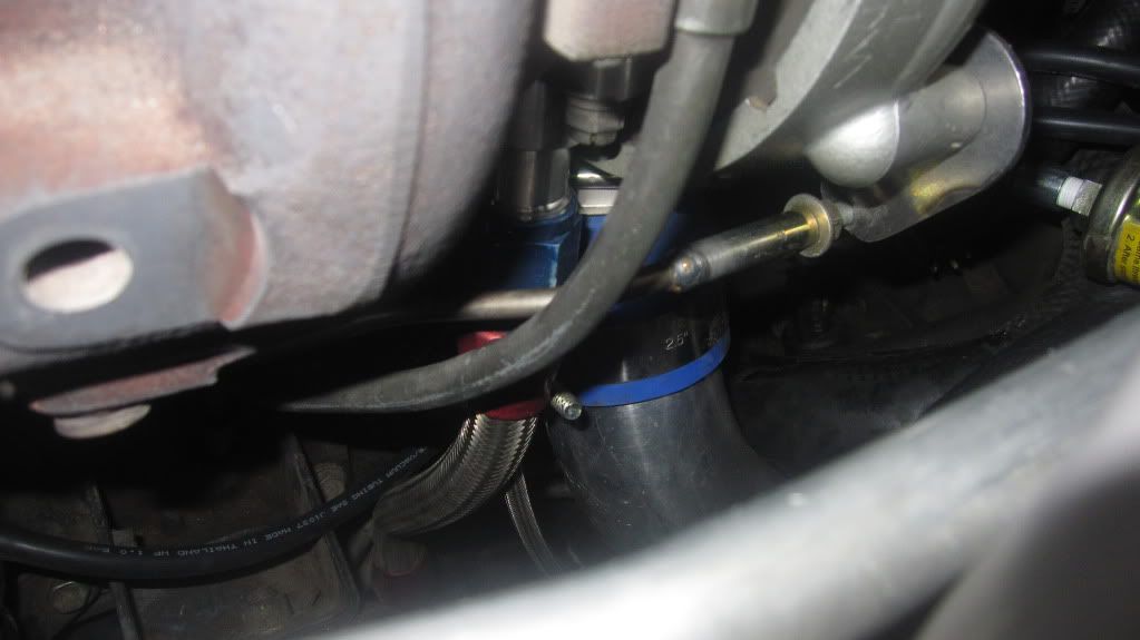

Hey guys thought I would do a small update so everyone can see what's going on. Recently finished the external waste gate setup:
Works great, Bring on the hating,:love: No it doesn't have to be off the collector, Yes it is better but it still works fine. Think of a pool filled with water, now if there is a hole water is going to leak right? doesn't matter where it is, can be all the way at the end, or in the middle, doesn't matter its still going to leak out. ;)
Bracket to hold the stock flapper closed.
Old WG rod and threaded coupler welded on to hold the flapper closed.

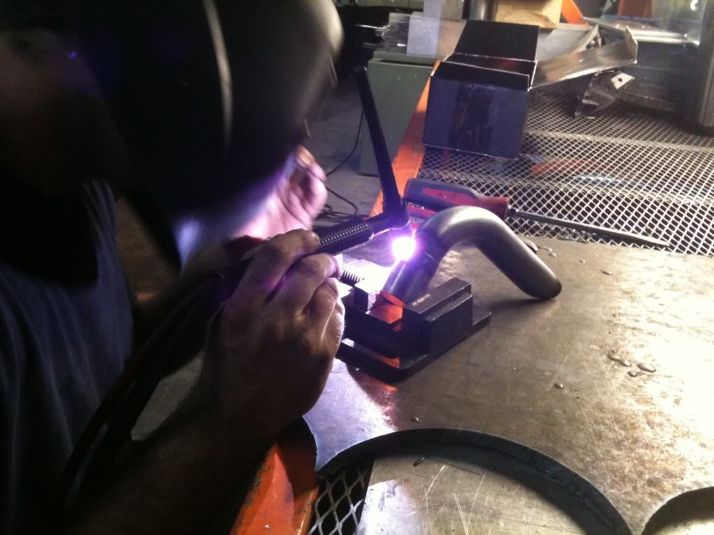

Brother tig welding the dump tube.

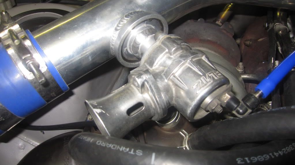

Took the old HKS BOV and cut off the flange part of it. Tig welded on a blitz flange! I love the way this BOV sounds..

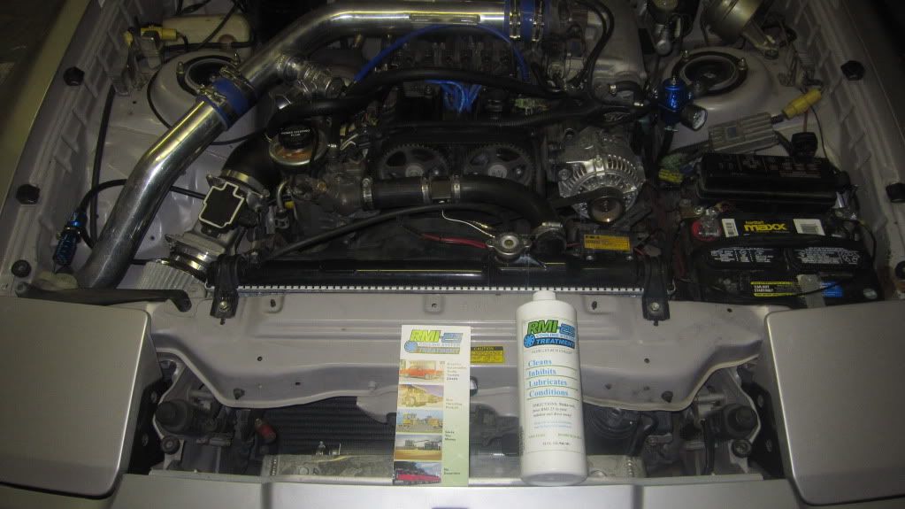

Flushed the block and radiator out and replaced it with RMI-25, Stuff works awesome :)

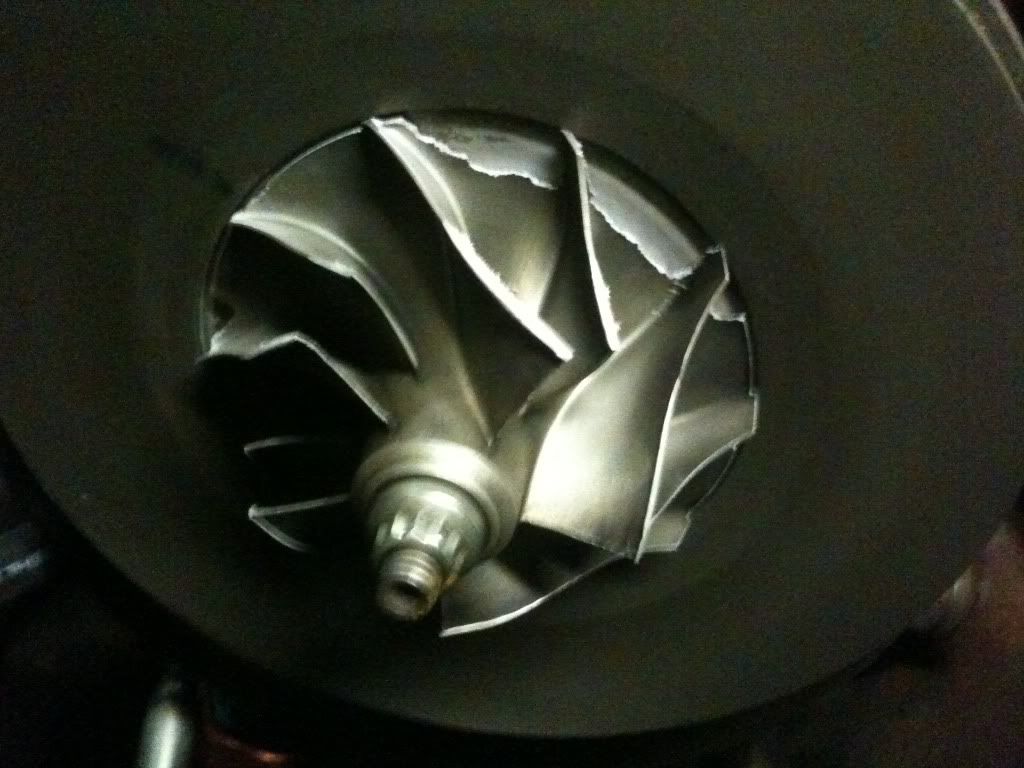

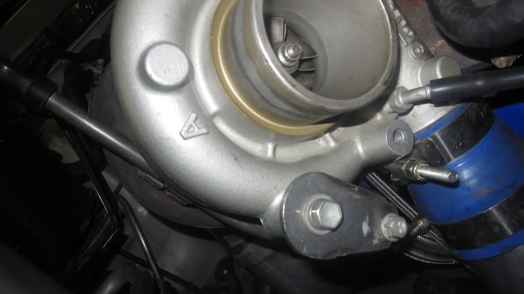

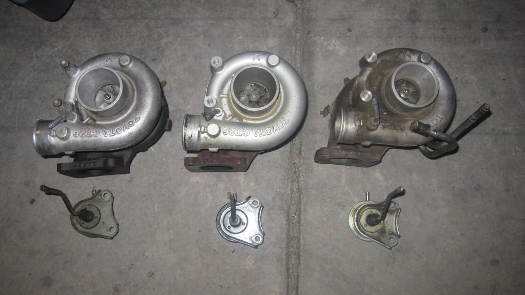

My Stock turbo blew, thrust bearing wore out from the driftmotion blow off valve failing causing compressor surge which wore down the thrust bearing enough for the compressor wheel to hit the housing and bend the shaft and chew up the wheel. I've decided to scrap the stock size CT and go to a CT26 57 trim.
Got a few cores im sending into driftmotion.

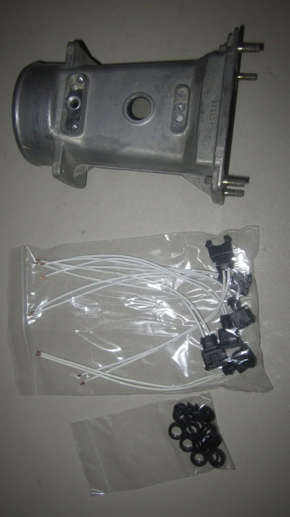

Got the Lexus AFM, Injector O ring set, and EV1 Injector Clips.

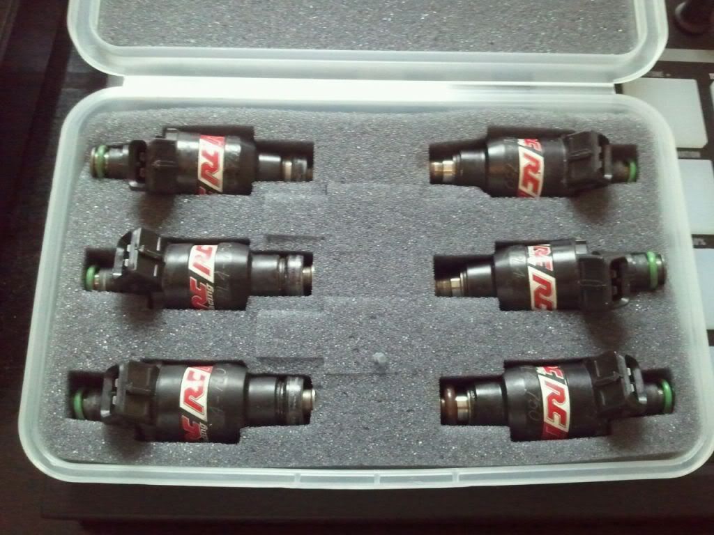

Got some used RC Engineering 750CC Injectors, Should be good to about 450 WHP on E85.

So the plan is to get the new CT26 57 trim on with the new injectors and lexus AFM, with the external wastegate setup and E85 its going to be a lethal combo with the motor being NA-T. Planning on putting down some good numbers, hoping for 400+ but we might get lucky and go more :) We'll see :D
