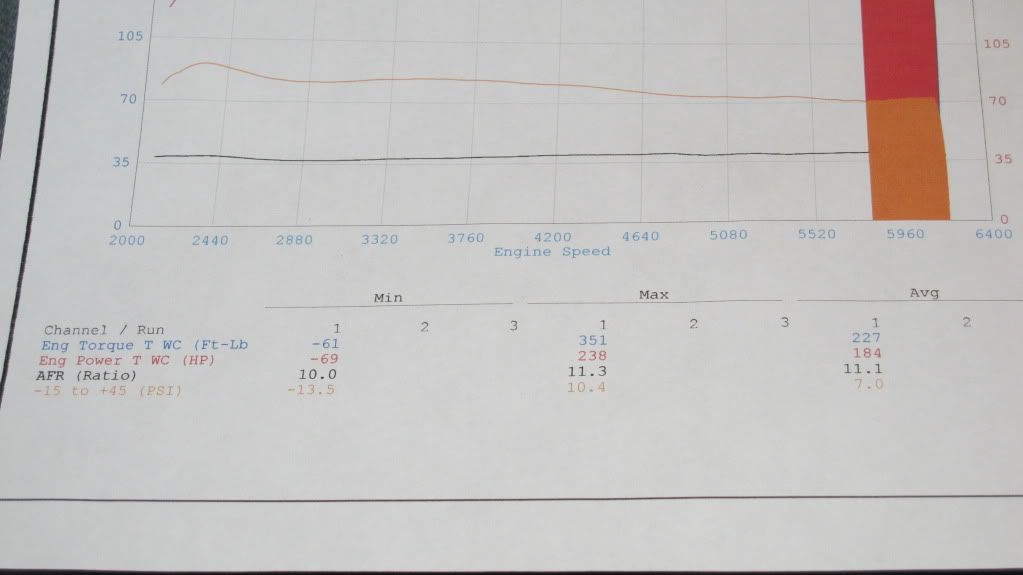

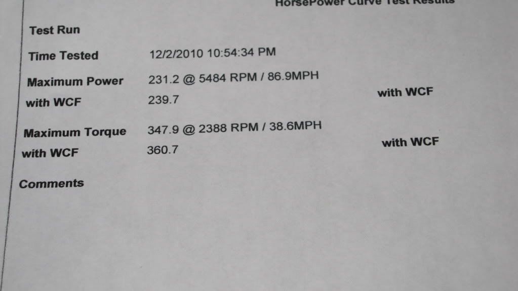

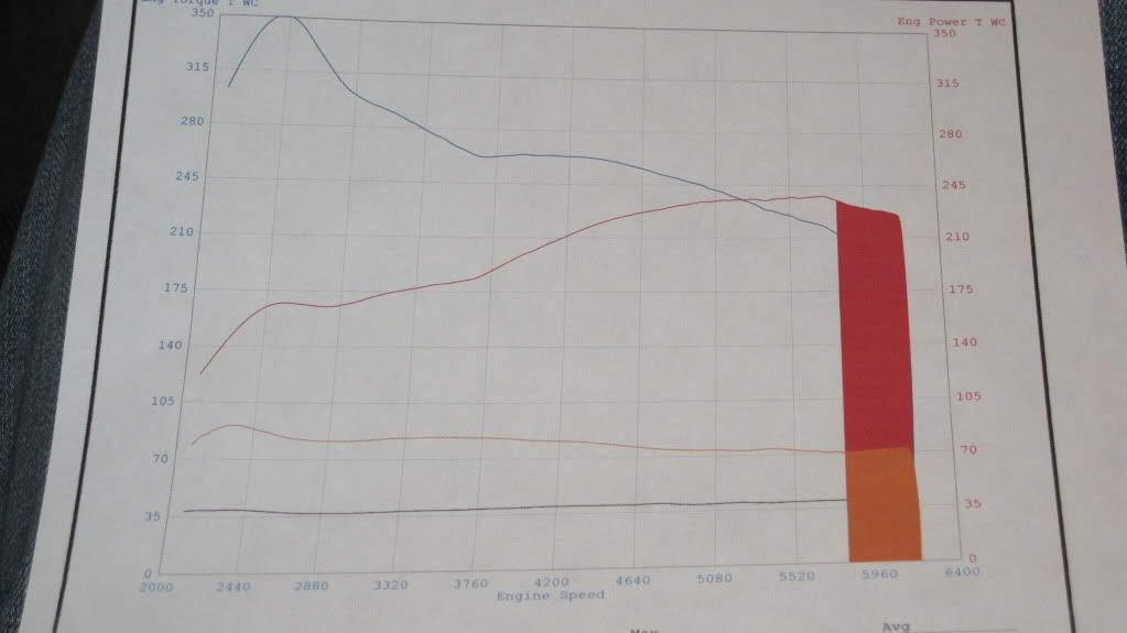

no, 360 torque 240HP, something is wrong.. since I have pretty much have a dyno at my disposal I will keep playing with it... The reason my HP doesn't follow is because my boost drops off like crazy.. I hit 10.4 lbs and made 360HP then as the boost dropped off I only made 240HP because my peak HP comes in at the higher RPM where my boost has already dropped off to 8.0lbs

I had 2.5 inch exhaust on at that time with the stock elbow and down pipe.. With the cat cut out.. But I had one cat and then 2.5 inch.. I need to go to a less restrictive elbow and then 3 inch exhaust.. I still think there is something wrong with the numbers
