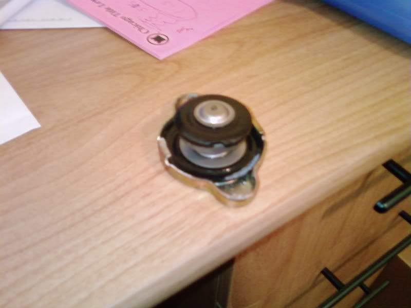

Today I was going to go meet a friend for lunch about 35 miles away in Granbury. I was on the phone with him at a traffic light when I happend to look down and my temp gauge was damn near pegged. I immediately turned off behind a gas station and killed it, popped the hood and could see where the overflow bottle had, well, overflowed down onto the intercooler. I waited a while and then popped the radiator cap off and and let steam for a good five minutes. The radiator was just about empty. My friend came and picked me up, I borrowed his truck and went to the parts store.
First I got some antifreeze and put in there it took almost the entire gallon. I let it run for a while, temp gauge was normal. I was examining my radiator cap some more.
So I decided to go get a new one. Anyway I made it home ok but did notice my overflow bottle was again teetering on boiling over again. So I'm concerned. I hate to use the term "boiling over" because it doesn't do it in the typical fashion. It seems like it ever so slowly builds up in the bottle. It doesn't ever just boil. No other symptoms of BHG either. Runs great, no smoke, no miss. I believe I'm going to have to pull the motor and reseal and replaced the HG a lot sooner than I thought.

kotu100;1156047 said:
dont ya think you should check out the thermostat before you rip the motor out?
Thermostat is brand new. I changed that a couple of weeks ago when I first noticed the overflow bottle starting to fill up on it's own.
