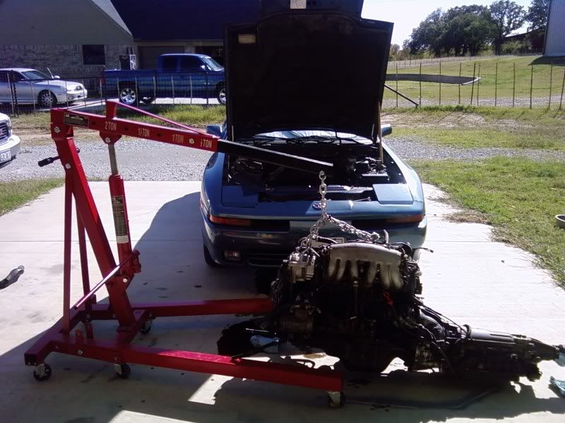

Well today I got the engine out...by myself just like last time. Yeah!

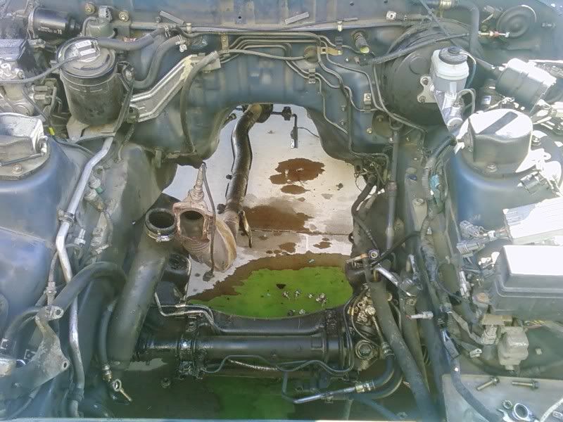

Here is the nasty ass engine bay. Don't you just love how fast antifreeze spreads?

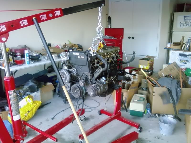

Sitting outside of the car finally. It's an oily mess!
Hmmm
And this is how I had to leave it today. Didn't have long to work on it since I had to pick up the kids from school.

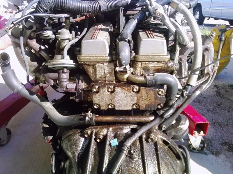

I am happily under the impression that my valve covers are probably the sole source of all the oil everywhere and not the seals.

Engine bay isn't that bad, it's more dusty that anything...
How's the IC pipe off the turbo, that's usually the first one to go. The oil could also be coming from the third valve cover gasket (that thing down the middle of the head) as it seals the oil galley plugs.
I think you got the Toyota gasket kit, but if it's felpro, DON'T USE THE STUPID EGR GASKET. Mine is blown and someone else on the forum had their's blow as well, and it's definately one of the worst things to fix in the car.
After looking at the pics, the engine is indead 100% original, even has the stock clamps on all the hoses (reuse them instead of the crap worm gear stuff from a parts store).

Thats a clean bay compared to some that I have seen and owned. Someones been into the valve covers at least, there is a hex head bolt on the back of the exhaust side cover.

Your bay looks cleaner than mine! I have a thick layer of grimy oil on the walls lower down. My Tranny looks like your with oil everywhere. Is it easier to pull the engine with the transmission or without? My mech said pull it without but that looks hard.
5
Depends, if you have a load leveler it's easier with the tranny...
And good catch on the cam covers, had to look again. Probably means they where overtightened or not installed right causing the leak...

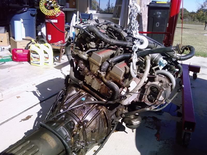

Today I took most of the stuff off the engine, wiring harness, intake. Seperated the tranny and put the engine on a stand.
This is all to familiar. I really didn't want to have to do all this, this soon.
Yeah, the valve cover screws are very very loose and one is stripped.:3d_frown: I'm thinking maybe when they replaced the timing belt they pulled 'em for some reason.
Pull it with the tranny. I don't have a load leveler and just used a chain. It worked well for me each time I've pulled/installed an engine. Probably safer with a leveler though.;)
