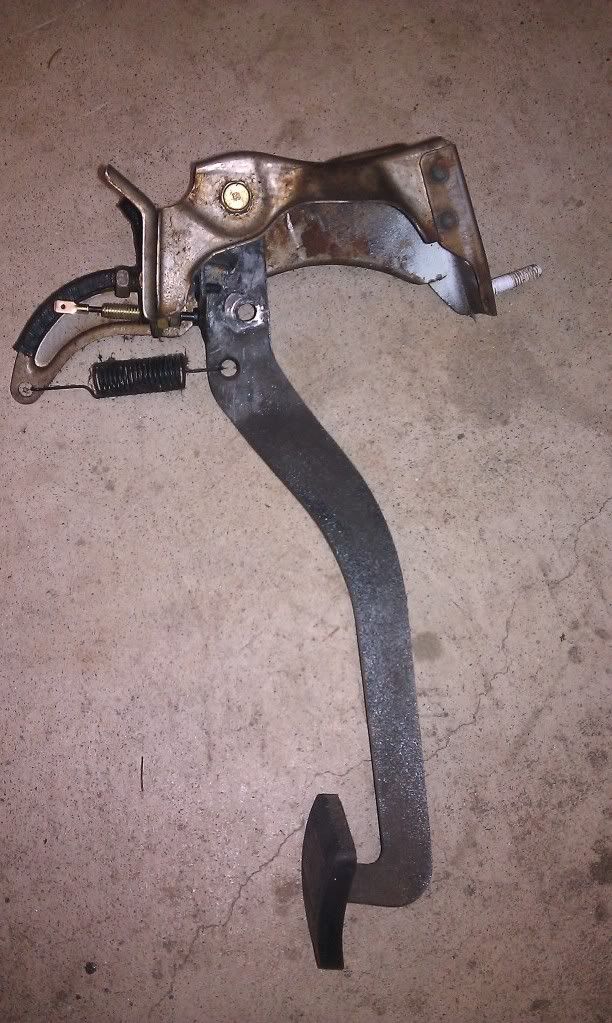

I removed the clutch pedal assembly last night so I could add a pin switch for the launch control. already reinstalled back into the car
Pic:

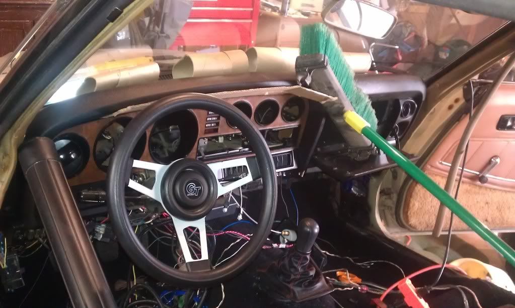

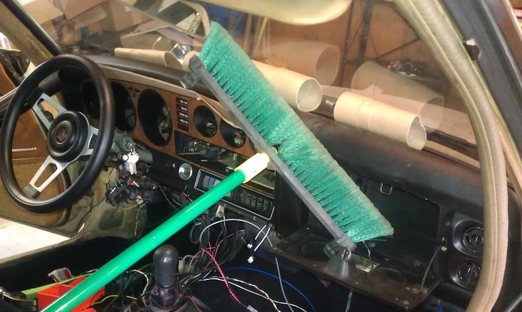

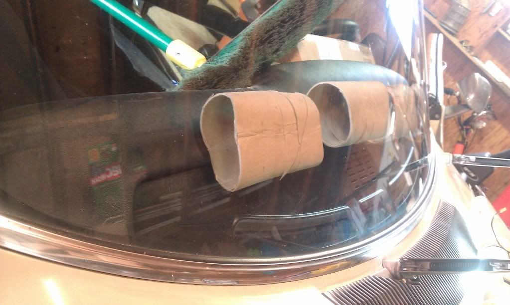

So I recieved my cap and installed it yesterday, it was quite a process preparing for install, but I didn't take any pictures, and it's boring anyways.
I had to get a lil creative to hold the cap on while the glue was setting up In comes broom, cardboard tube, and vacuum cleaner extension tubes and some regualr cardboard
and after... it's still dirty, becasue the broom made a mess of course, but it looks great, expecially compared to what it was before!

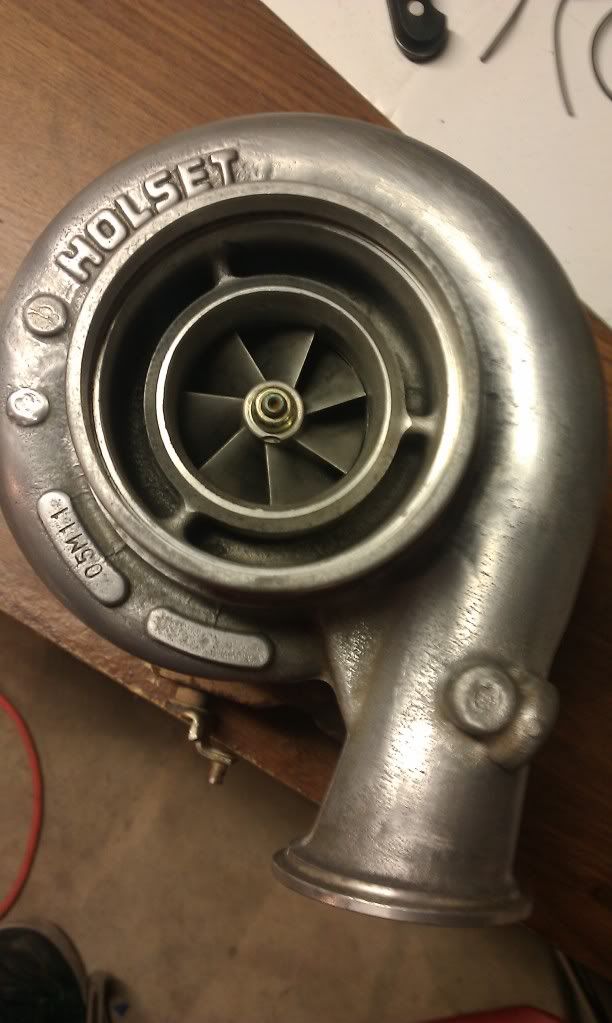

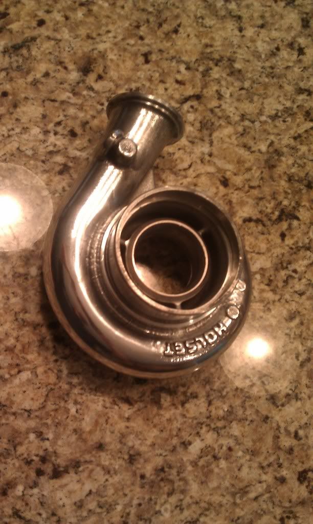

Oh, one more thing... I purchased this lil guy. Haven't decided, if/when I will install it though
HY35

I am leary about throwing that turbo on, it's only about 450WHP capable, so I don't know if it is worth changing from the ct26 57 trim until I blow it up.... which may happen in short order with 2-step launches :lol:

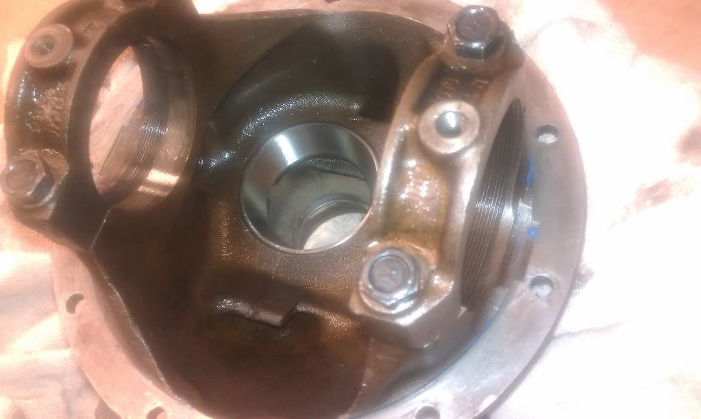

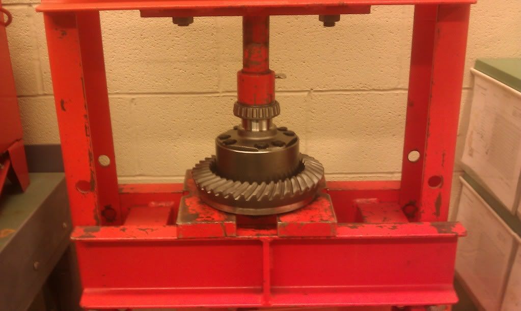

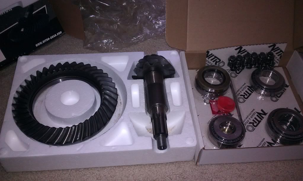

I recieved my 3.55 R&P, and master rebuild kit... ya know, bearings and such
Started to put it all together last night, I will be doing this myself of course.
How can you learn and educate yourself if you just pay someone to do it for you?

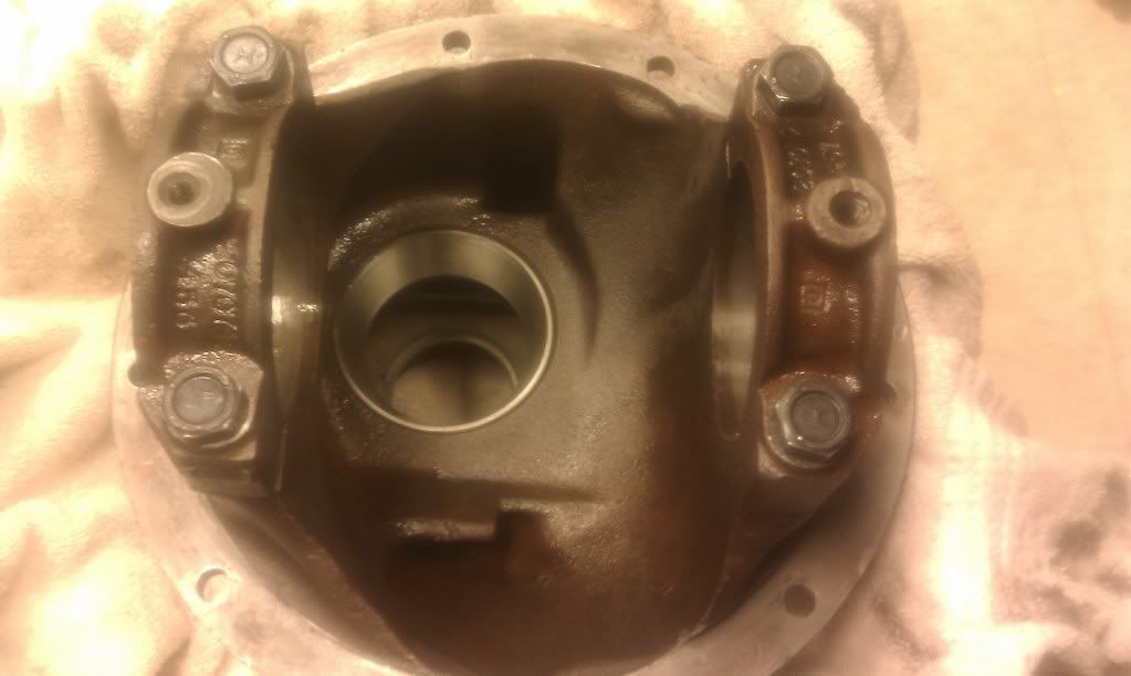

Pressing on the new bearing after getting the ring gear on there. Having some issues with the company I got the ring gear bolts from... they are useless garbage, so I will be delayed on getting it completely together until I can get some good bolts

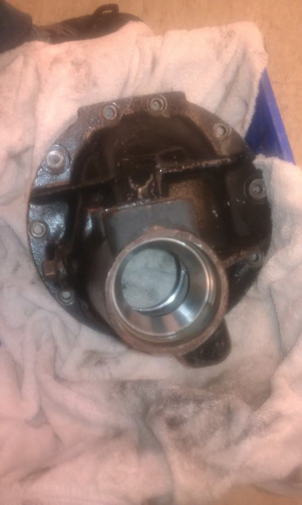

Drove out the old races and pressed in the new ones.

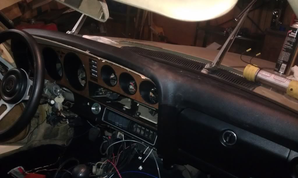

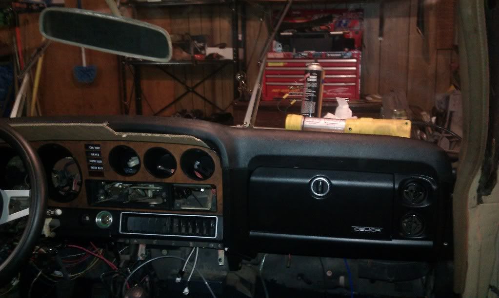

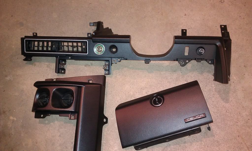

Also repainted the dash parts the way it was from the factory, with some silver. The part around the air vents, and the "CELICA" lettering
diffs are cake to rebuild it the tools not every one has like a a press/barring splitter/pion depth shims/torq meter and dail gauge on and marking compound
ps run the cage's tight to help prevent deflection but only if run brand new barrings

Dash is looking nice, like it belongs that way in the first place... and good to know on the justdifferentials.com guys. Hope things get straightened out for you. Word of mouth is enough to sink a business...

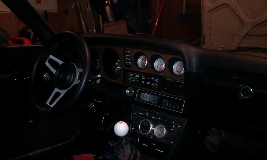

I have finished the dash up, got some new gauges installed, including a fuel level gauge because I could no longer use the stock one.
It's been quite a process trying to make all of the interior black. Still not quite finished, but here is my progress.

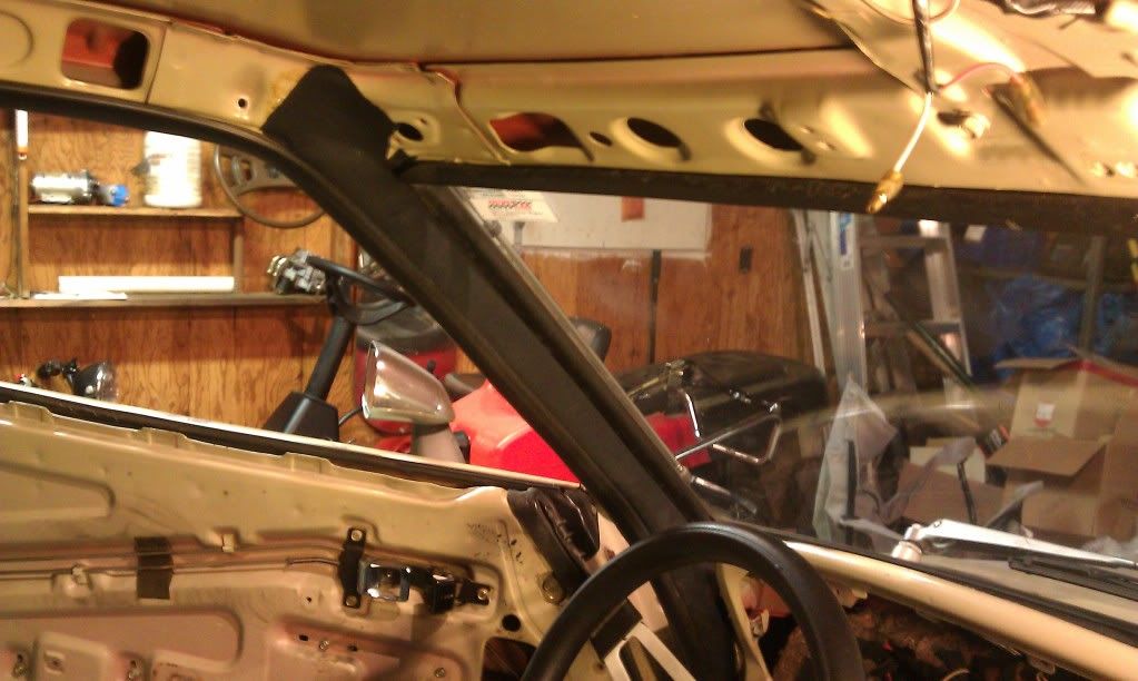

I used black cloth to recover the inside of the A-pillars. Before they were covered in vinyl that was ripped from when I messed up while installing a new windshield gasket. Looks much better now.
Mostly ready to go.

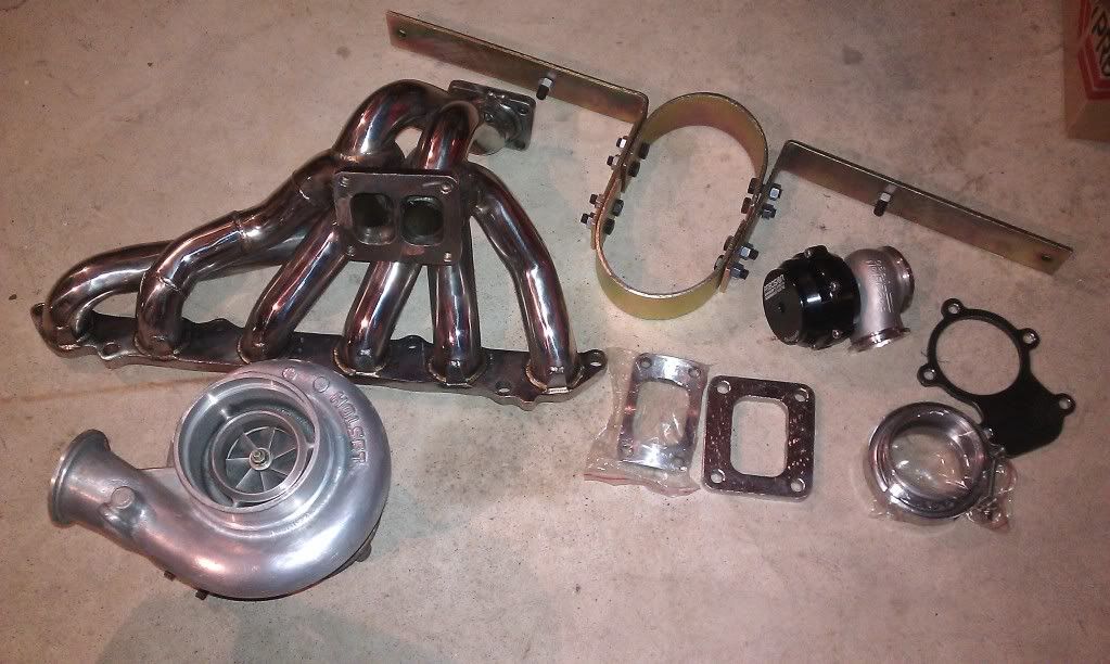

I also purchased some goodies to get ready to install the holset turbocharger, and a driveshaft loop for safety.

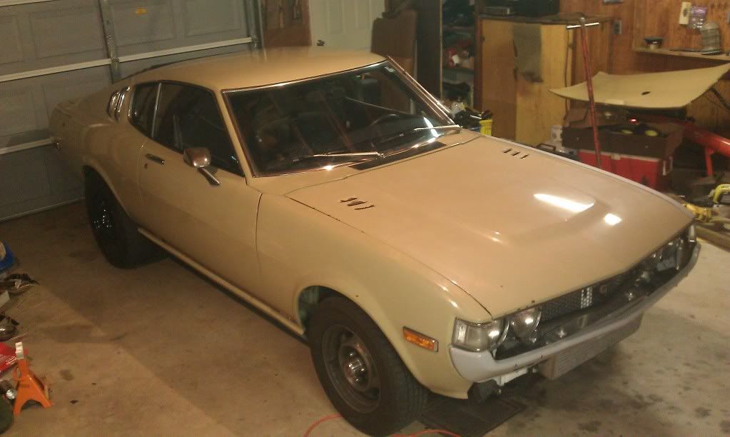

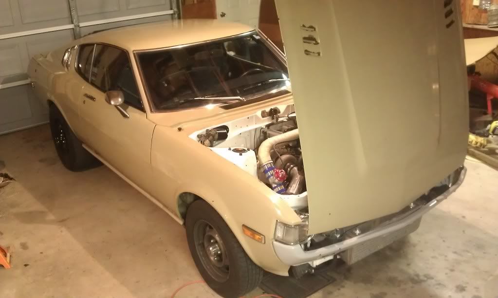

Here is the car back on the ground. I have been having some fun with it the last few days.
6,625
My guess, the clutch... but the driveshaft might let go too, if it's stock. I don't think I saw what you're running as far as a driveshaft.
By the way, I am loving the paint scheme. Who said beige can't bite? :evil2:
