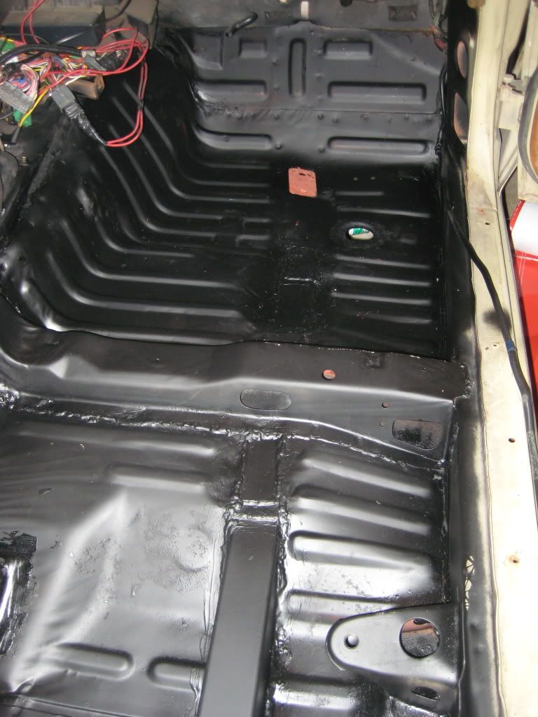

I Finished the Subframe connectors
Just about finished, final Welding
Primed then used seamsealer to stop the welds from rusting
Made a *Temporary* spacer for the right side spring perch to prevent the shock from getting bent again
Oh yeah.... Drag shocks too, 3 way adjustable
(Mopar 8 3/4" Rear axle)
Frame ties painted and done
Underside
Inside the car

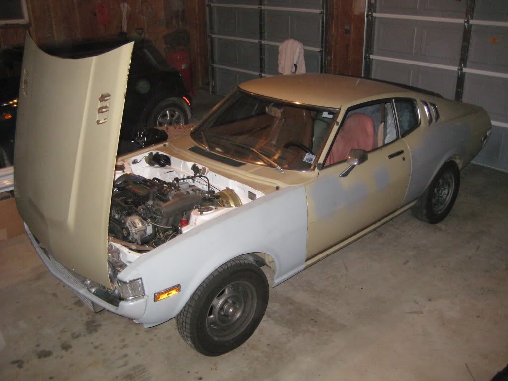

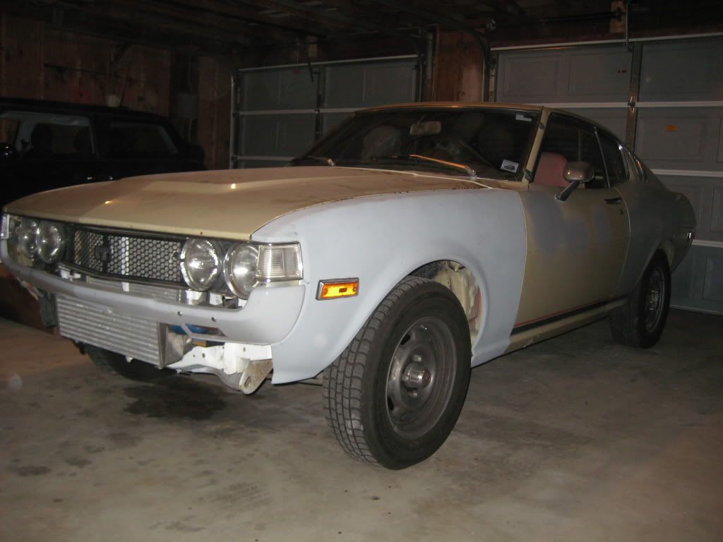

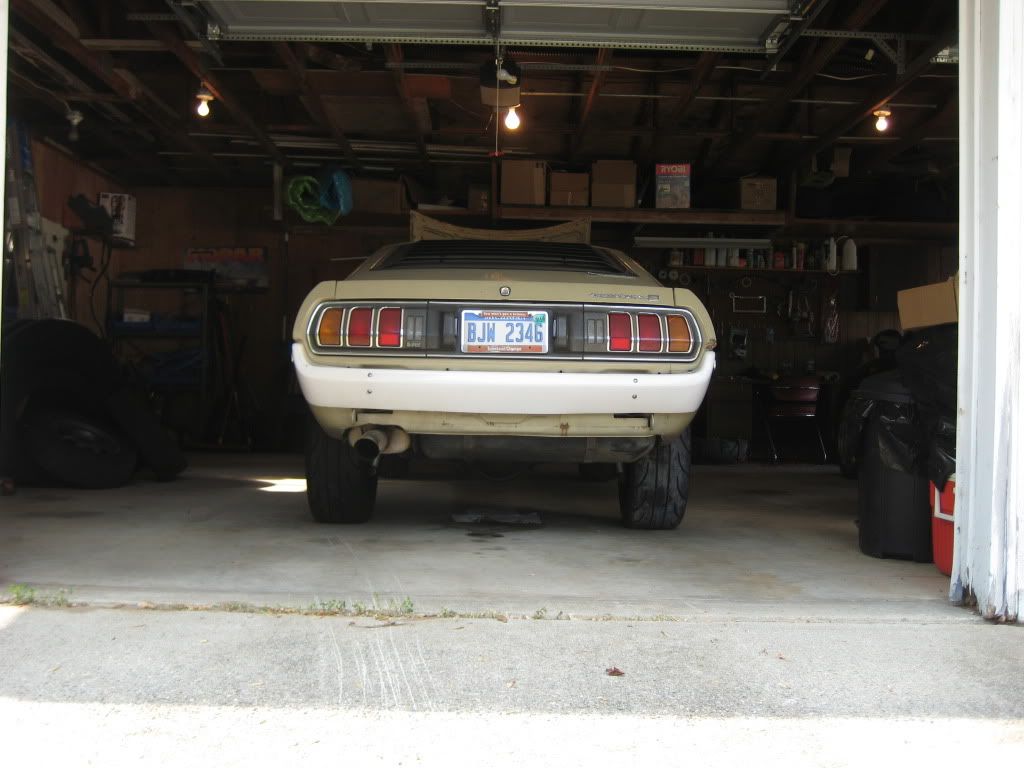

Sleeper stage
Still going to look like this for a long time with my current budget, but I love sleepers, so it's all good :)

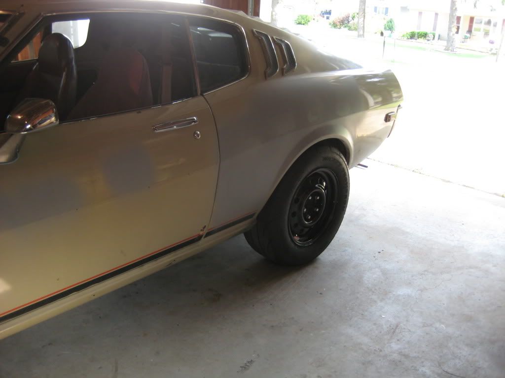

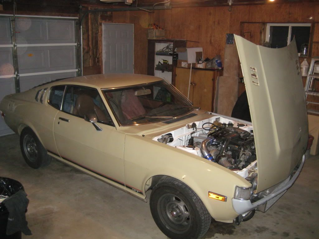

Pulled out of my dad's garage to bring home, post subframe connector install
Went out for a weekend drive with the GF

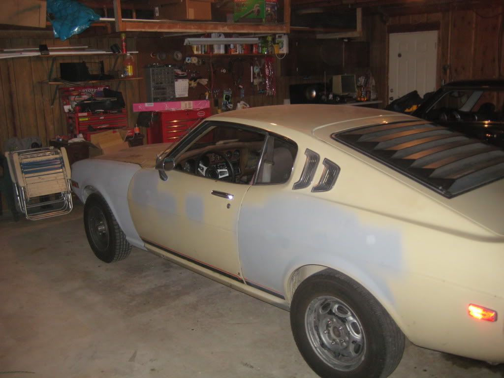

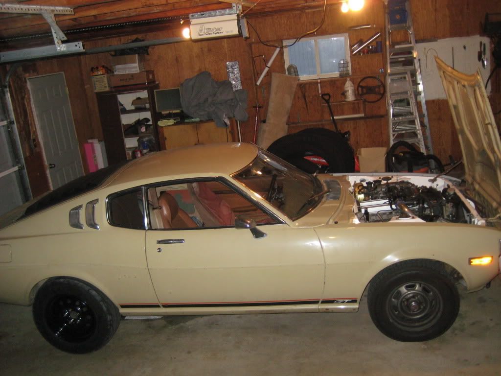

Now back in my own garage, took a few pics

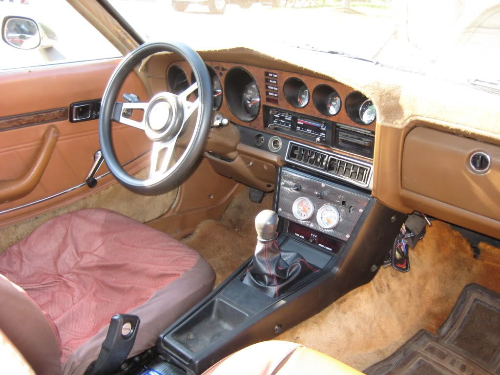

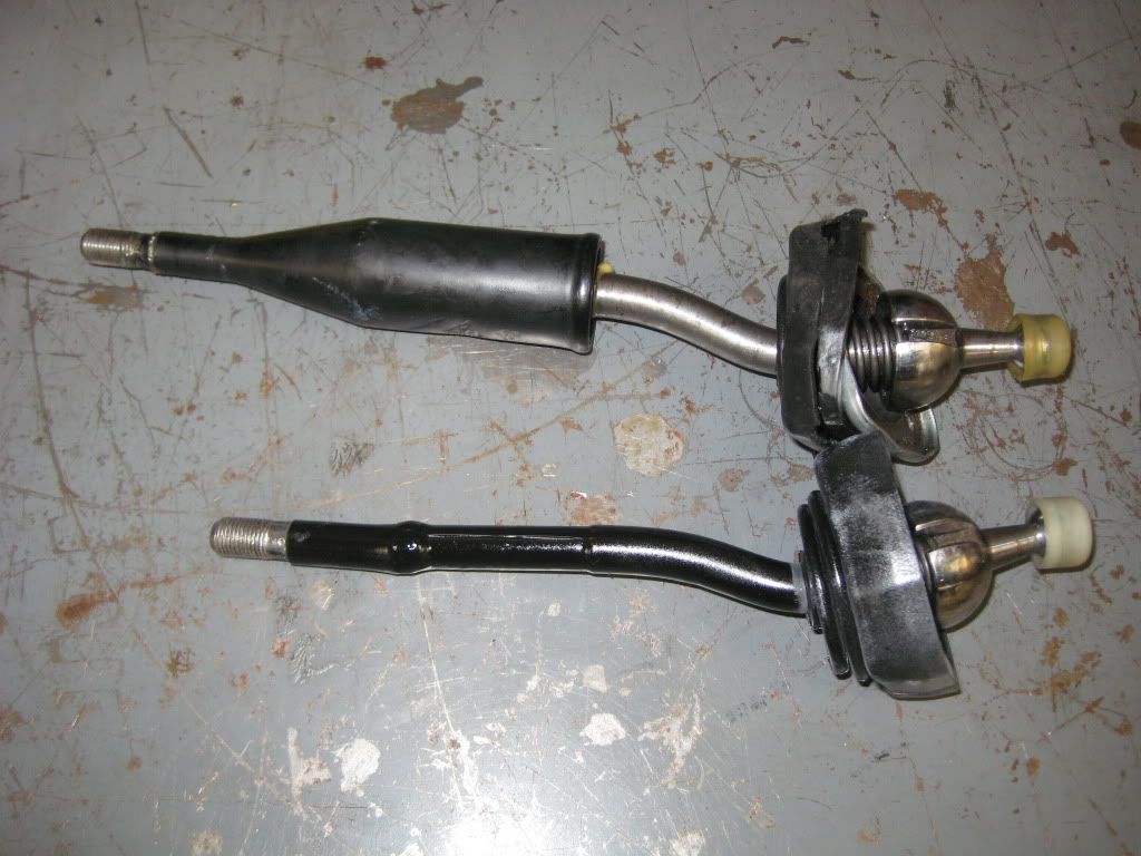

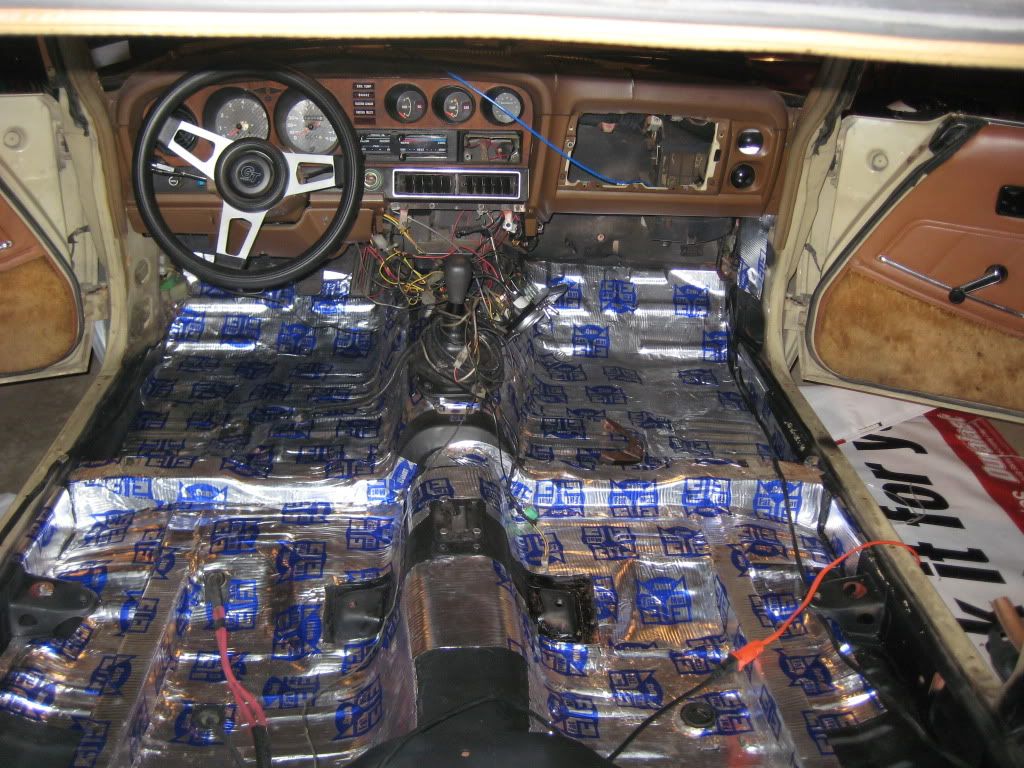

Shortened the shifter a tad so I don't feel like I'm rowing a boat anymore

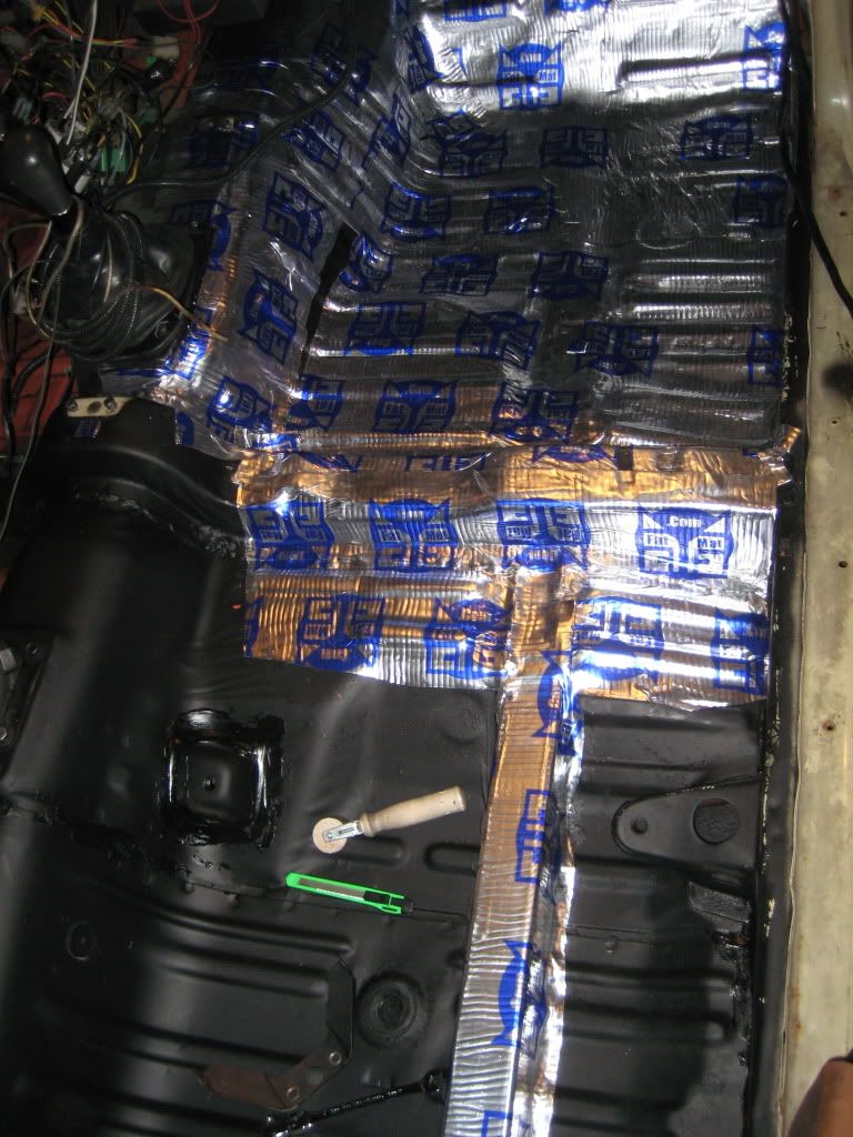

Painted interior floor in prep for sound insualtion
FatMat
Interior mostly back in

"Shortened the shifter a tad so I don't feel like I'm rowing a boat anymore".
Oh no! You have destroyed your car! haha. no just kiddin man. I actually just did the same thing. So much better now. But don't let that "SuperMod" with 39,000 posts know that you have done this, else your post might end up in the "Wall of Shame" lol. Plus several other members here on Supramania might give you grief about this too, since your stick shift is not close enough to your steering wheel to race anymore, instead of telling you how you have a sweet car and welcoming you to the club (very cool project that you did here by the way). I bet nobody suspects that you could leave them in the dust with this thing. Major sleeper. How does she feel on the road?

I don't really care what anyone else has to say about the shifter not working right.... becasue it's not in a supra, it was way higher up in this thing. The shifter works amazing and I am very happy with it. Watch the video on the end of my previous post, then tell me I can't shift with this thing! haha, spin into 4th...
Thank you for your comments! I really appreciate it, especially after all this hard work!

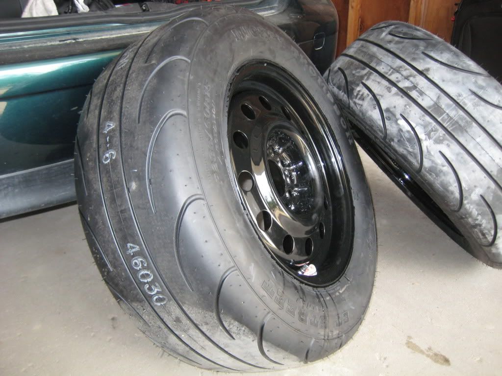

I ordered some 15x8" steelies with 6.5" backspacing from diamond racing wheels for the rear.
issue is though, I ordered them April 14th, they said it would take 6 weeks to get them to me... and I am still waiting, they keep giving me the run around! They won't call back and they are trying to tell me I ordered them like 2 weeks ago. It's BS and I'm getting pissed about it!
Rear tires will be 235/50/15 M/T Drag Radials

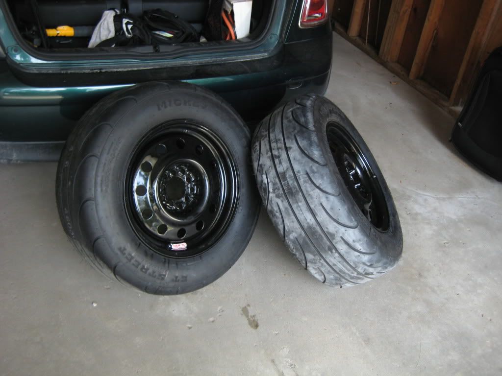

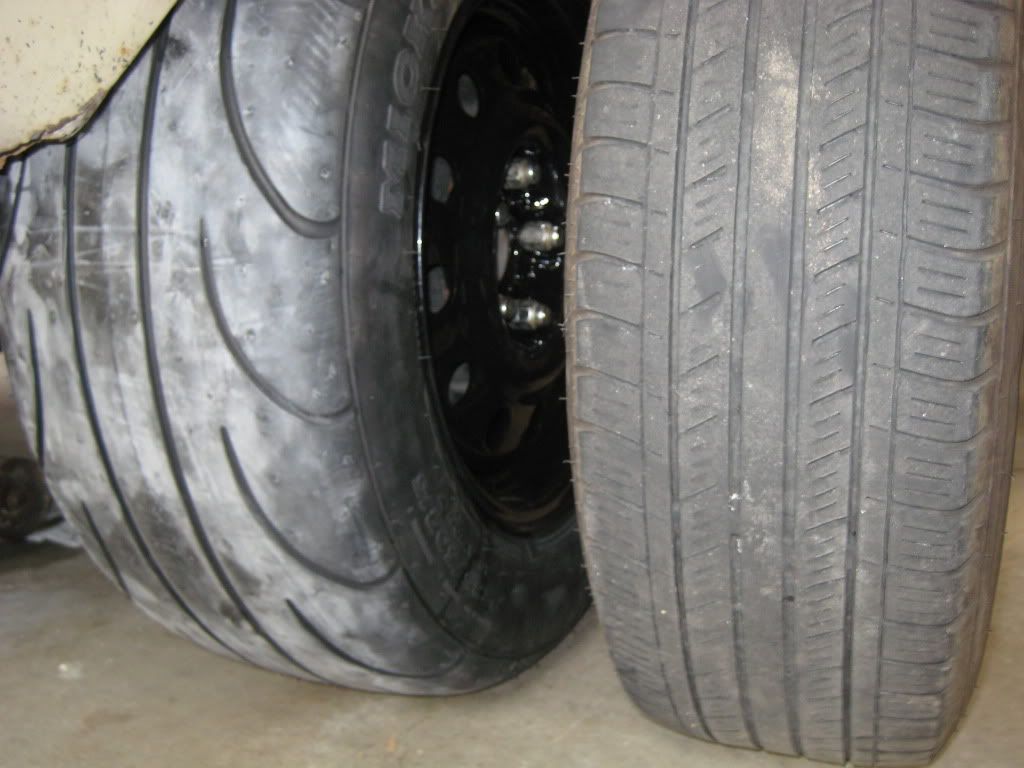

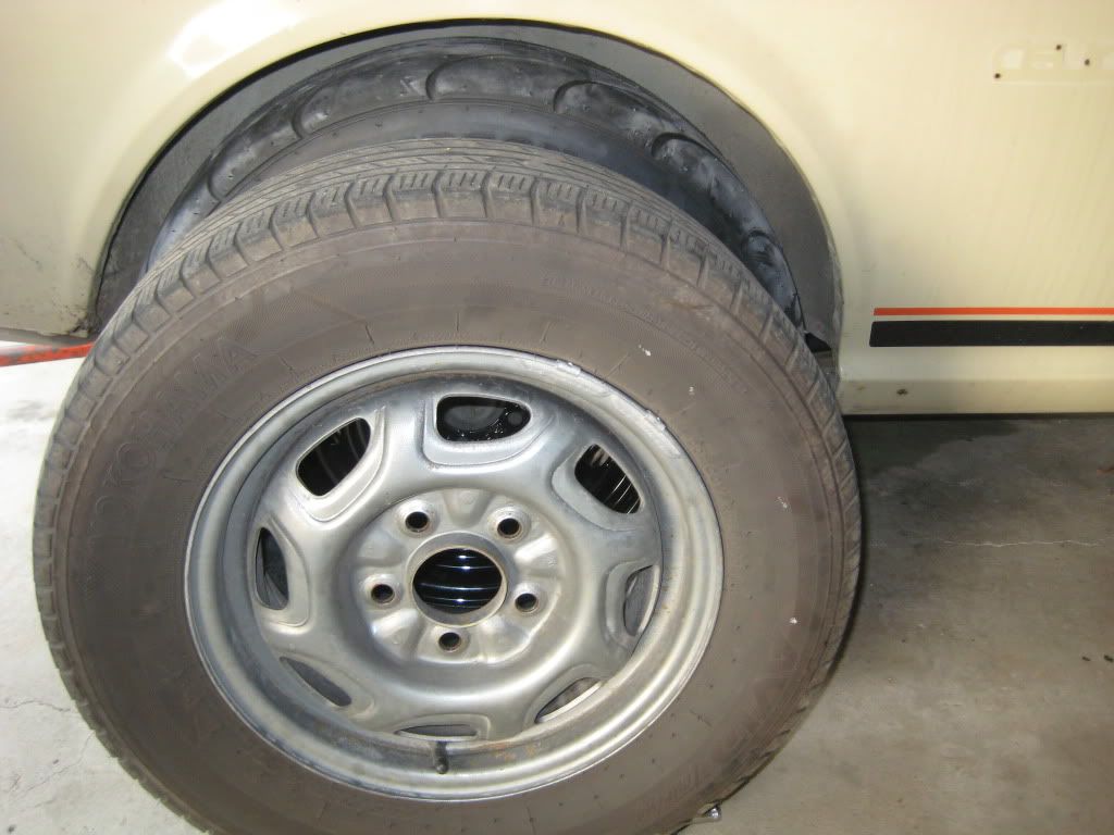

Finally after 2 years of tire melting fun... Time to hook-up
235-60-15 MT DR's
15x8" Diamond Racing wheels steelies with a 6.5" backspace
Old 195-70-15's vs new
Taller
Here is how she sits
Perfect fit (well just about, rubs the inside a tiny bit when it squats on accell, but that will be taken care of shortly)
Still a sleeper
Amazing

You have a girlfriend...? Those tires look so much larger than they actually are, I love that about small cars. Kinda gives away your secret though, if people know what to look for in a car...
