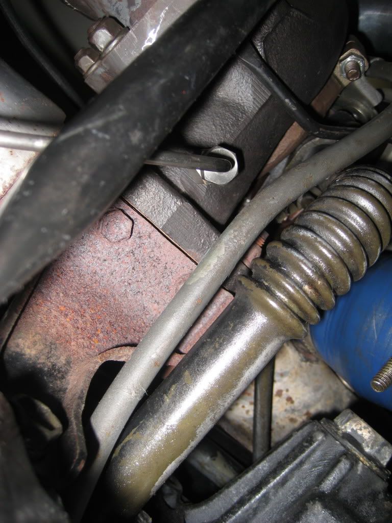

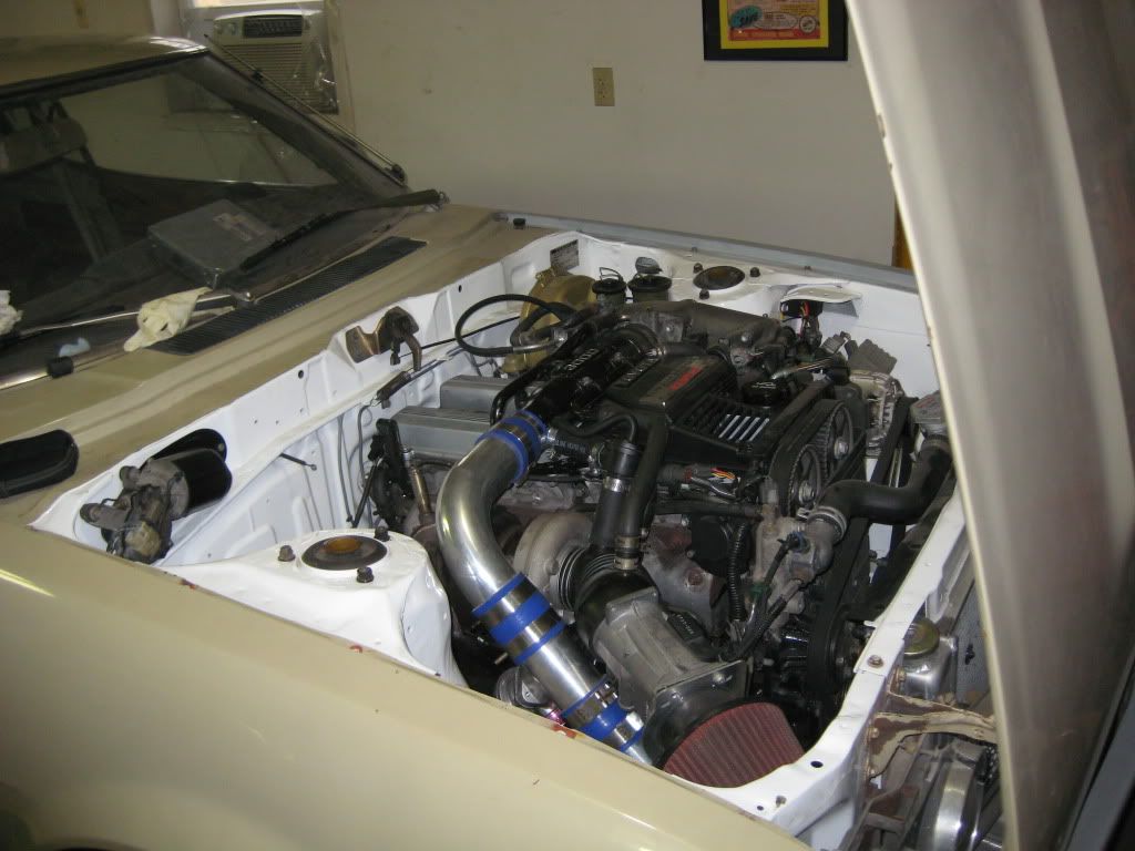

A lot has happened since my last update, including blowing a big hole in front of the transmission, but here is what is going on now

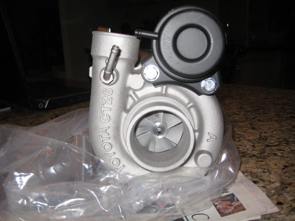

New 57 trim ct26
installed

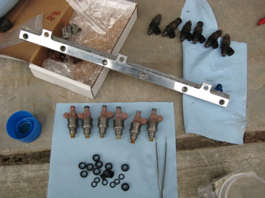

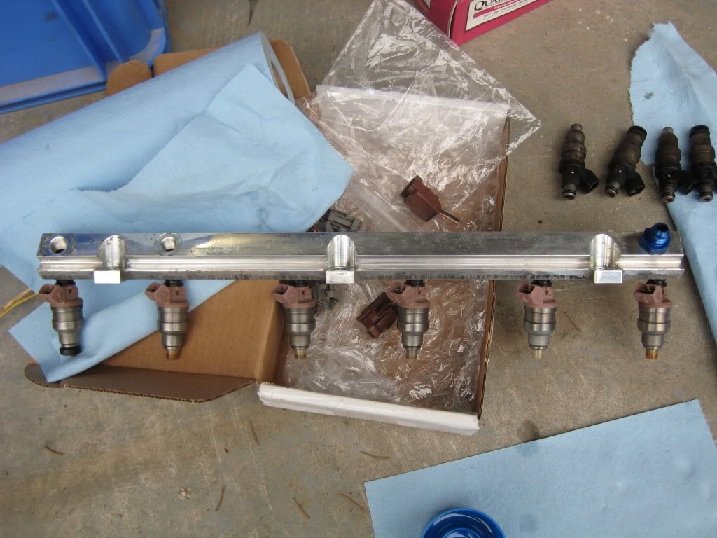

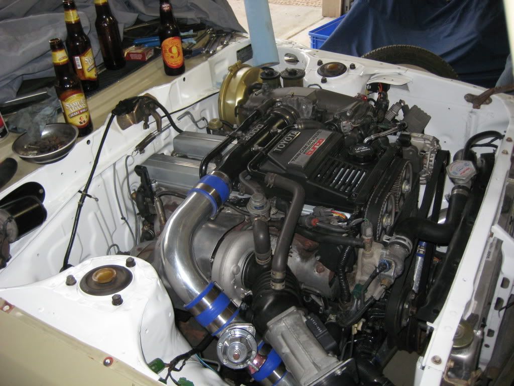

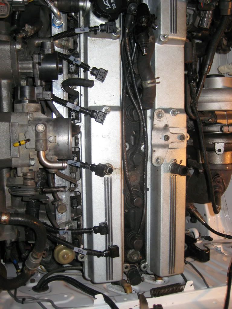

Had to cut off the injector plugs to install the EVO 9 560cc's, here is the result
old injectors on top(440cc), new ones on bottom(560cc)
installed with new seals
new ones now in, was a pain in the ass with the manifold in place

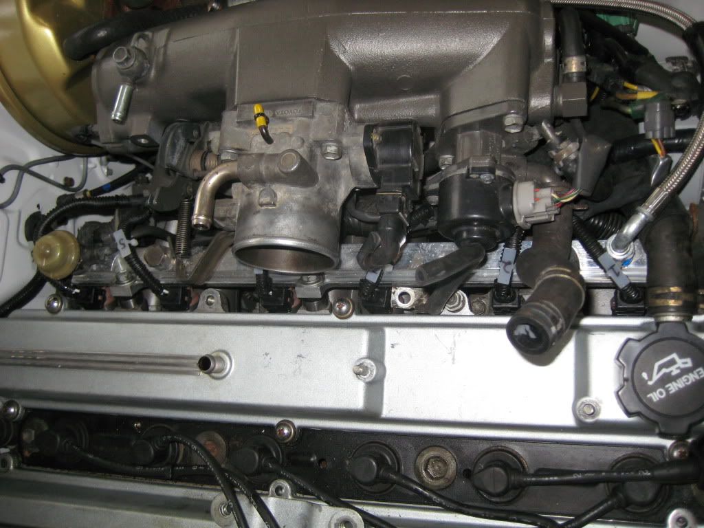

beer = much progress

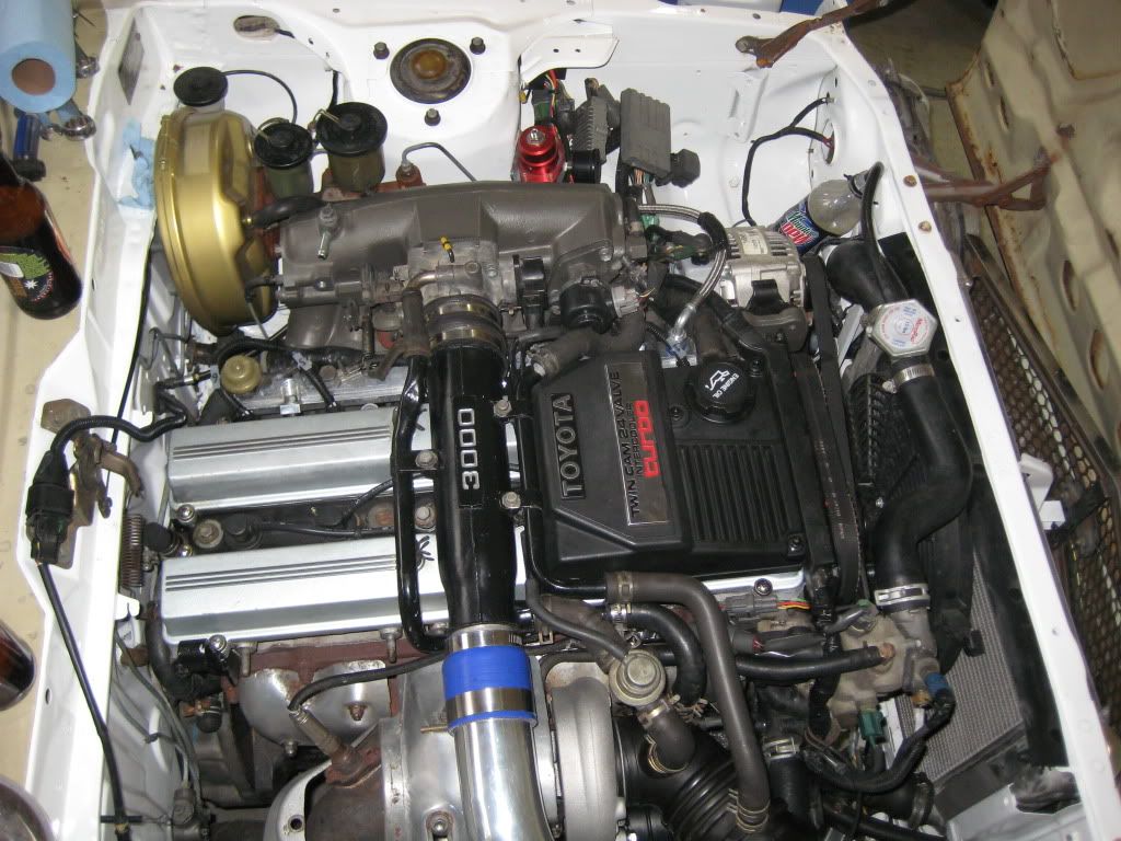

Finished
Started it up and it ran great, idles perfectly.
I still need to make some fuel pressure adjustments, but it's pretty close. Just running at stock boost for right now, I am going to give the turbo a little time to get used to it's new home before I crank it up again.

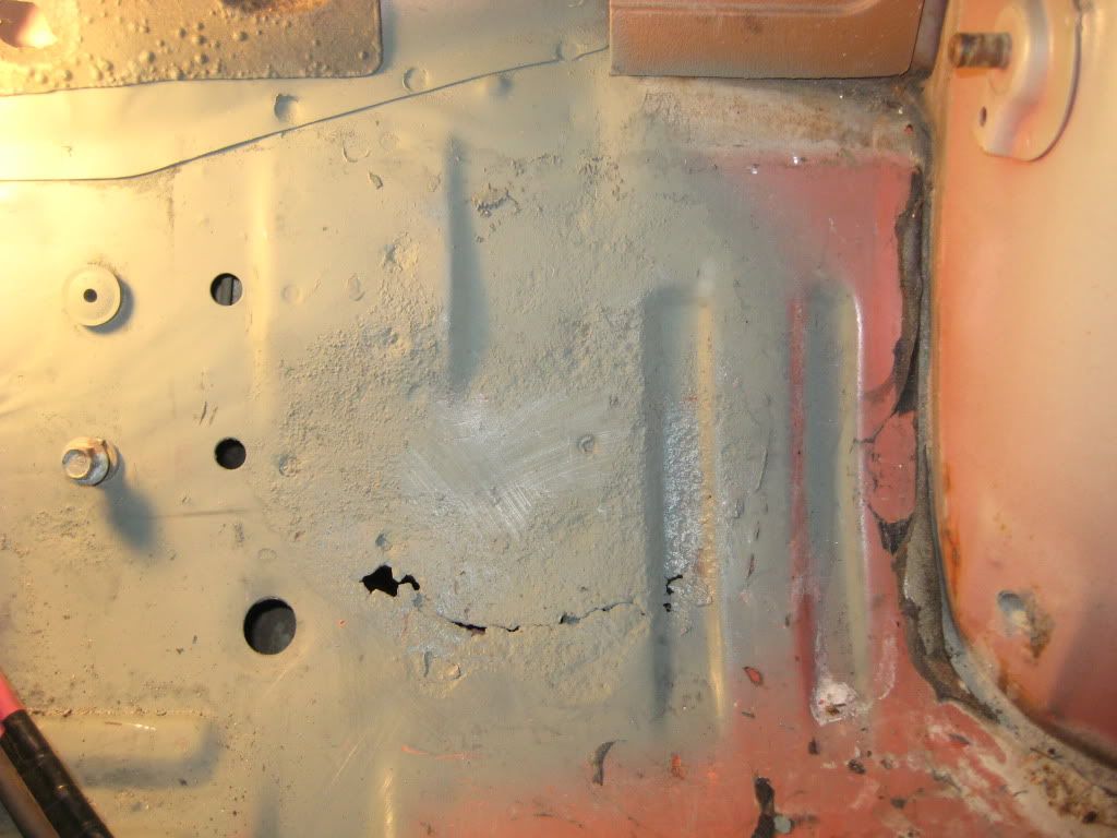

Some progress finally.

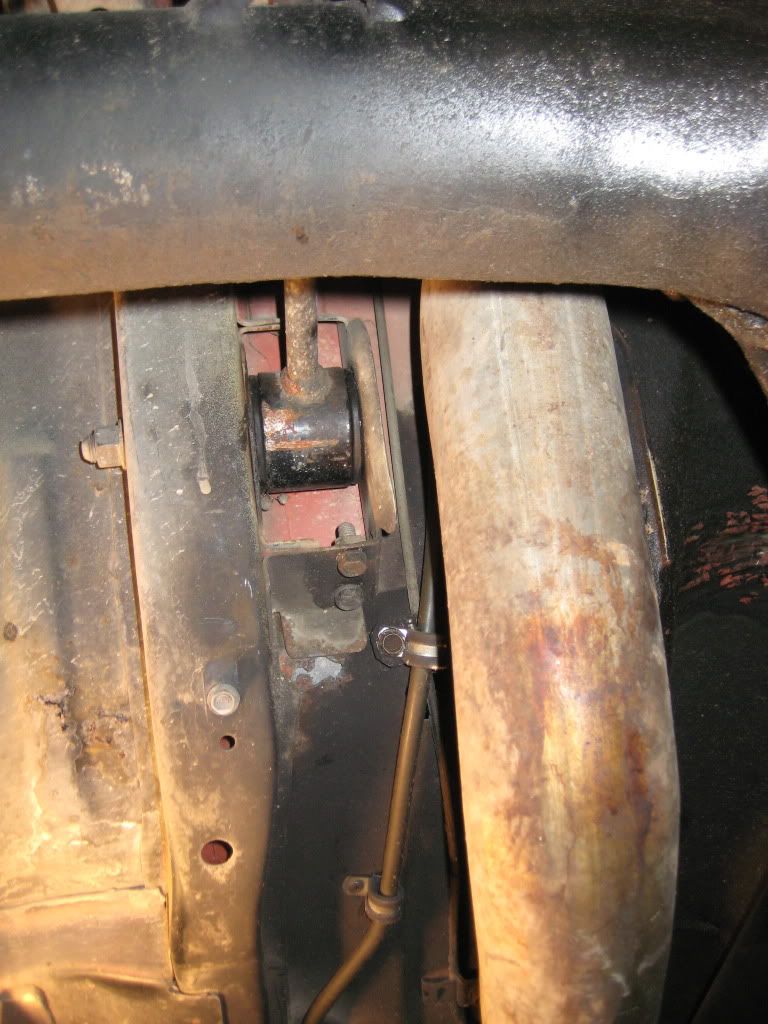

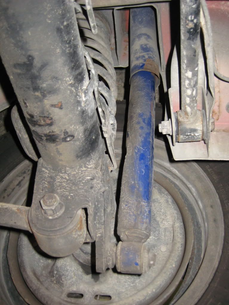

Also discovered a very bent shock.... squats so much that the spring was hitting the shock and apparently bent it.

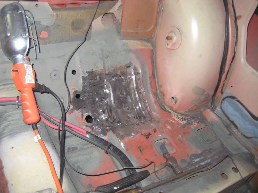

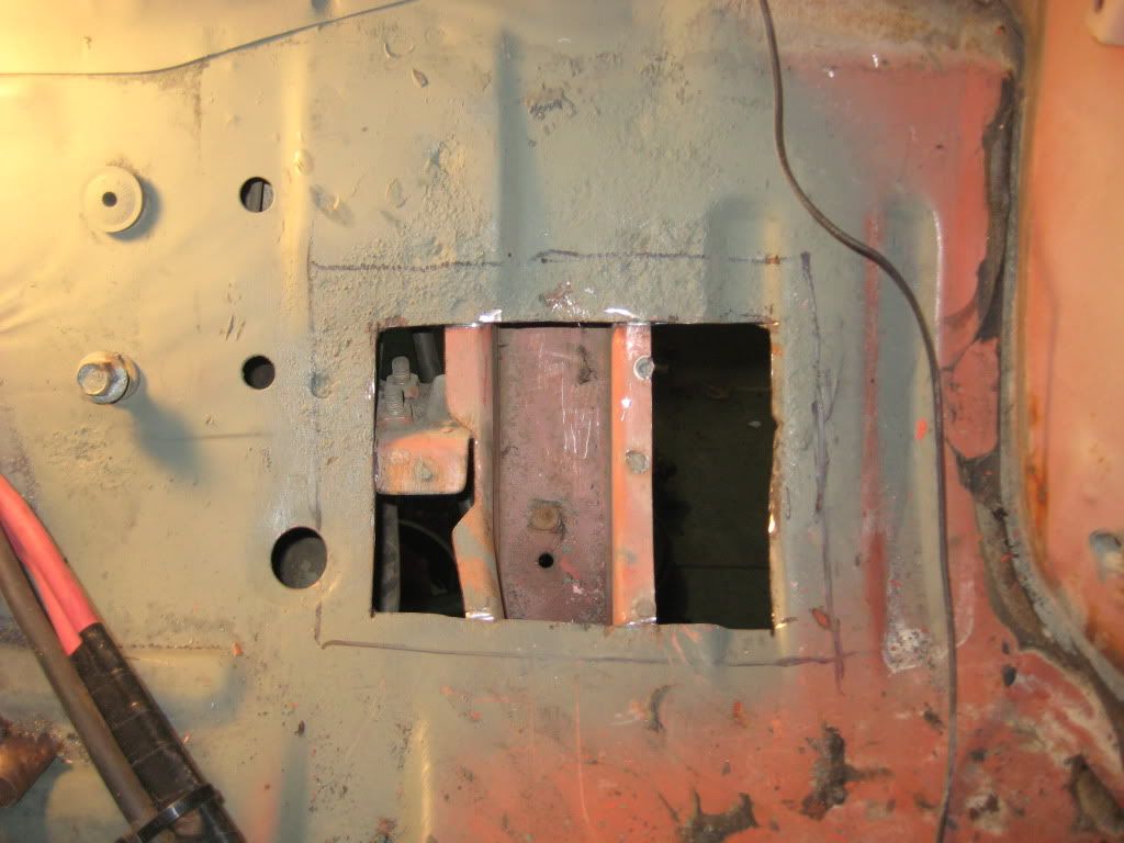

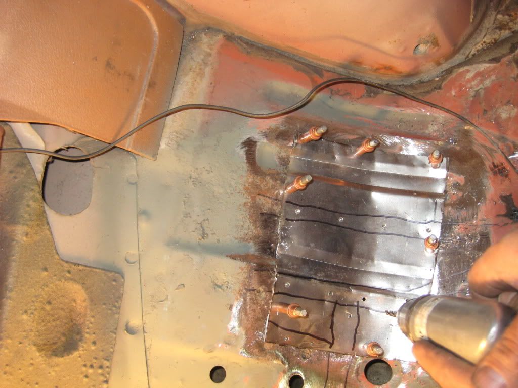

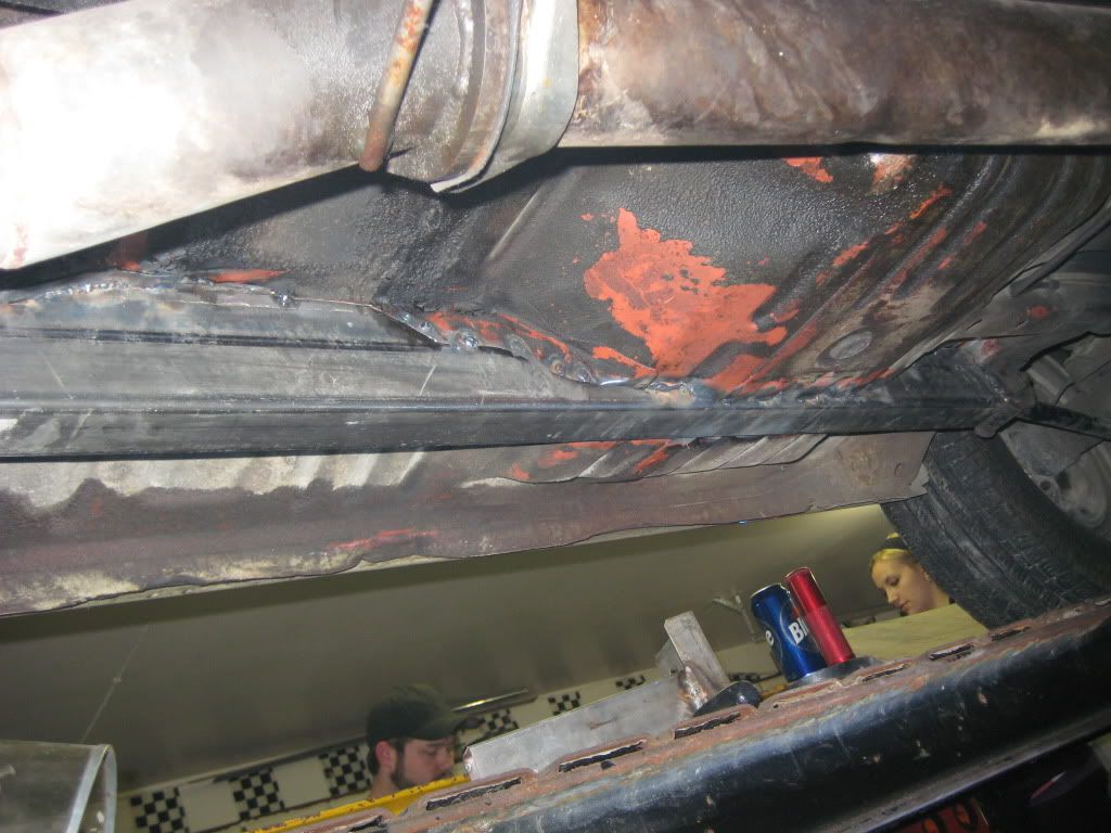

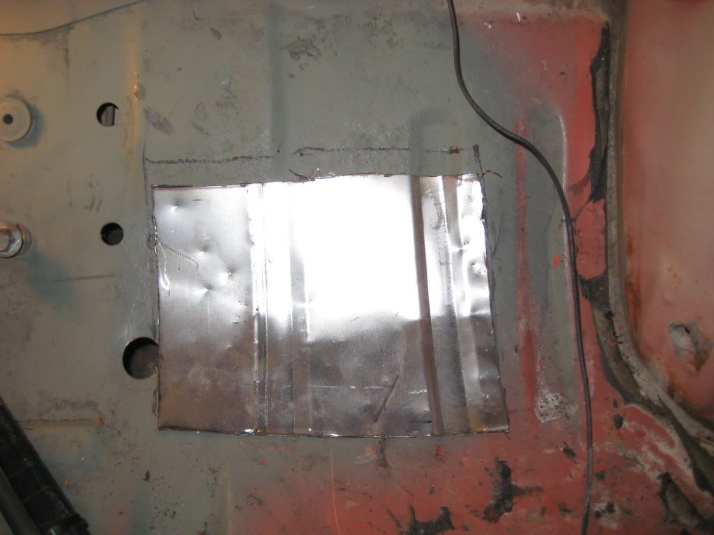

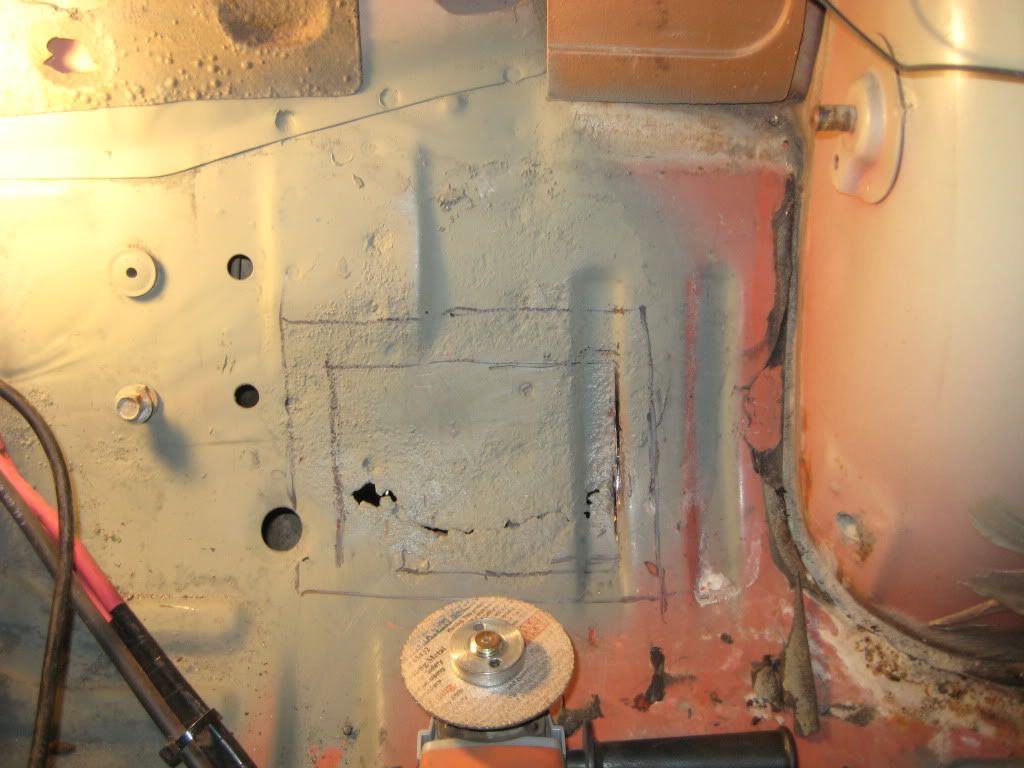

Did a little bit of nesessary rust repair. Was right above the left rear 4 link mount and subframe.
you can see the rust hole by the link mount
finished - paint

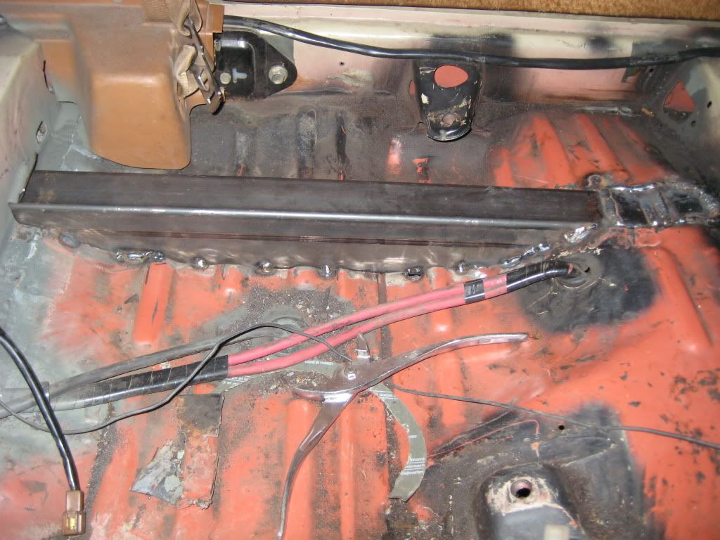

Small Update....

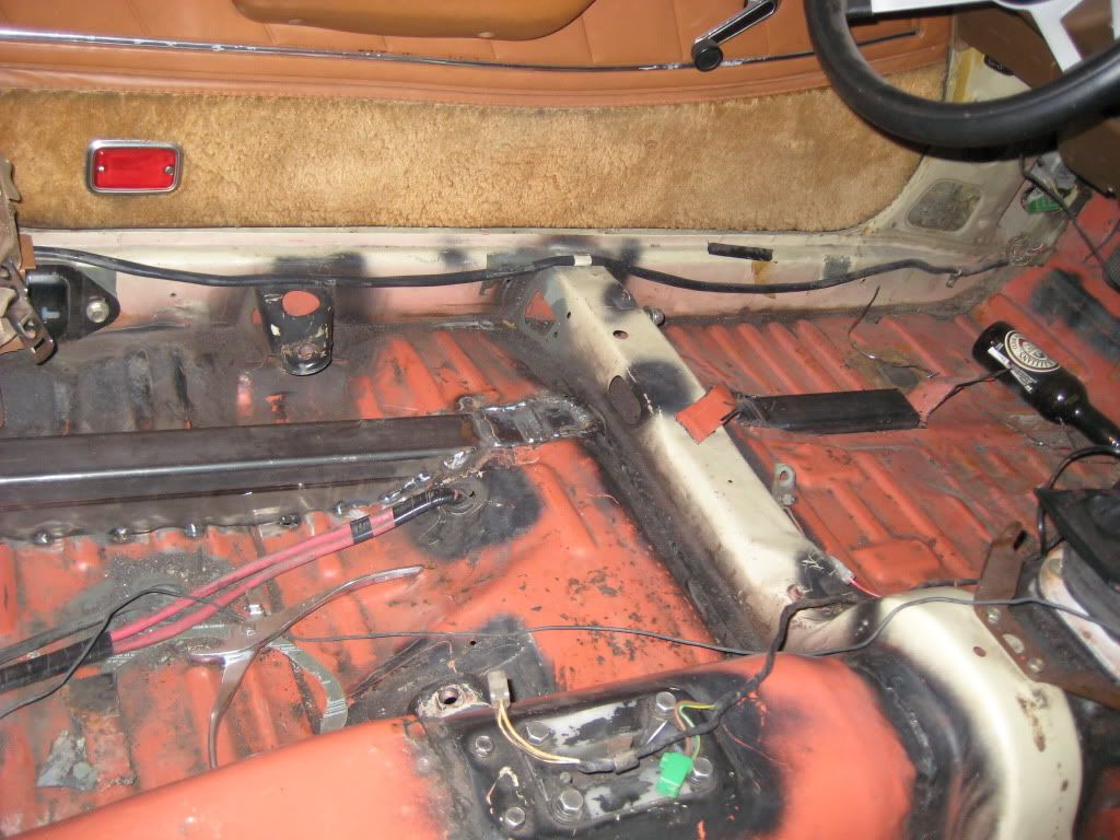

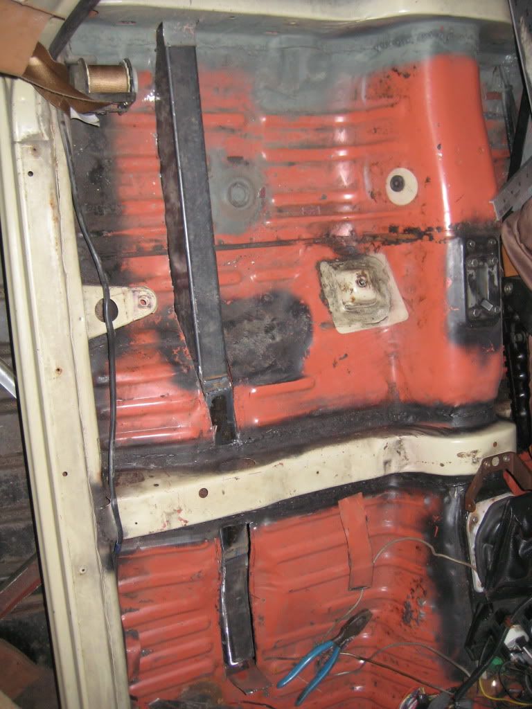

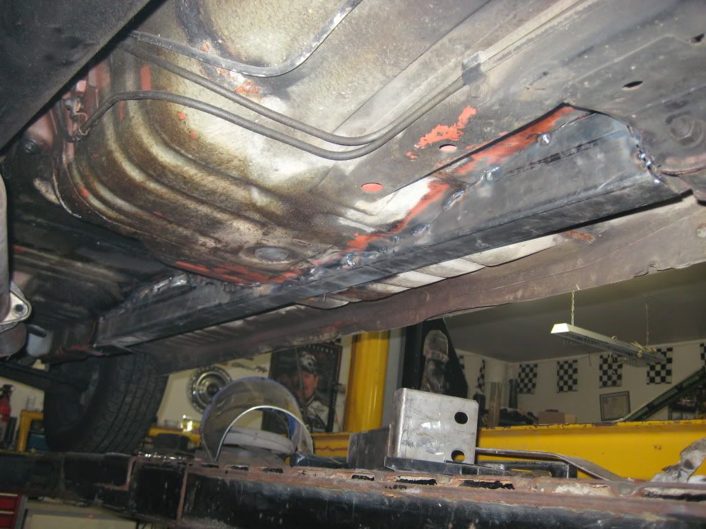

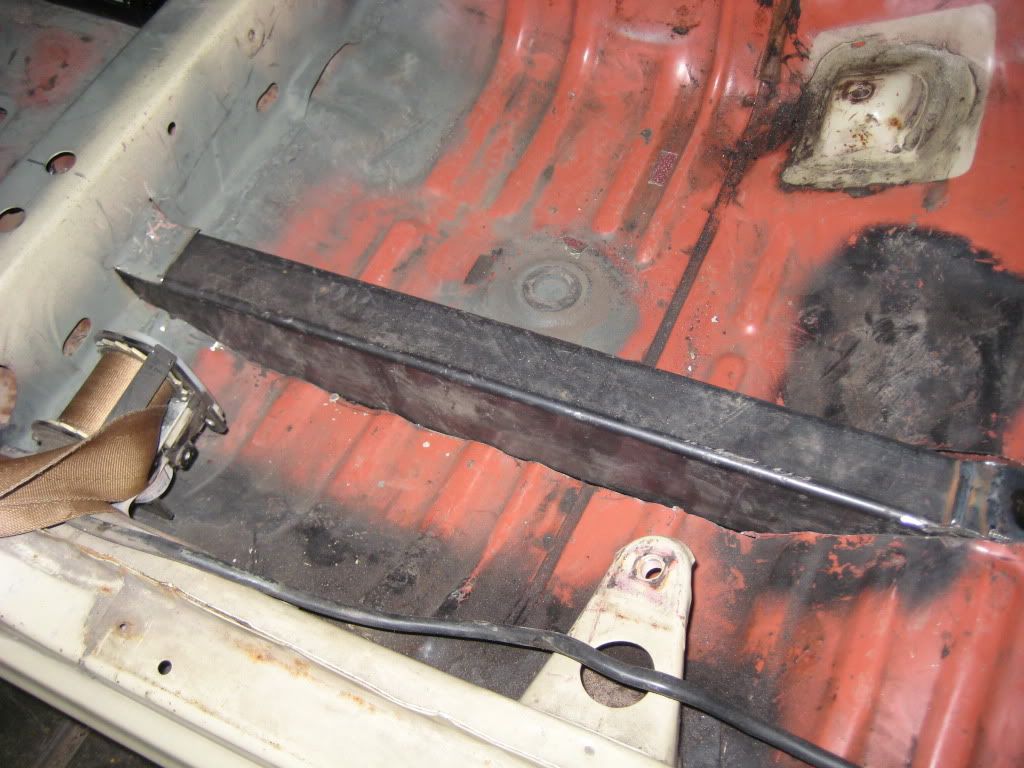

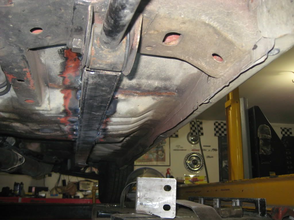

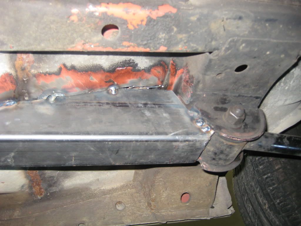

I have been working on installing some subframe connectors to stiffen up the car and to help prepare for the roll cage install.
They are not really subframe connectors really, but I tied the rear lower 4 link mount into the front subframe because they are much more lined up and I figure it will be much stronger this way. After getting both sides installed I will tie them laterally into the rockers near the rear.... and eventually will mount my rollbar hoops to that.
I am using 2"x3" square tubing
Not finished, just spot welded in mostly.... but I figured it was time for an update.
Let me know what you think.
6,619
Takes a brave man to cut channels into the bottom of a 1st gen Celica, but the work looks nice, keep it up! :)

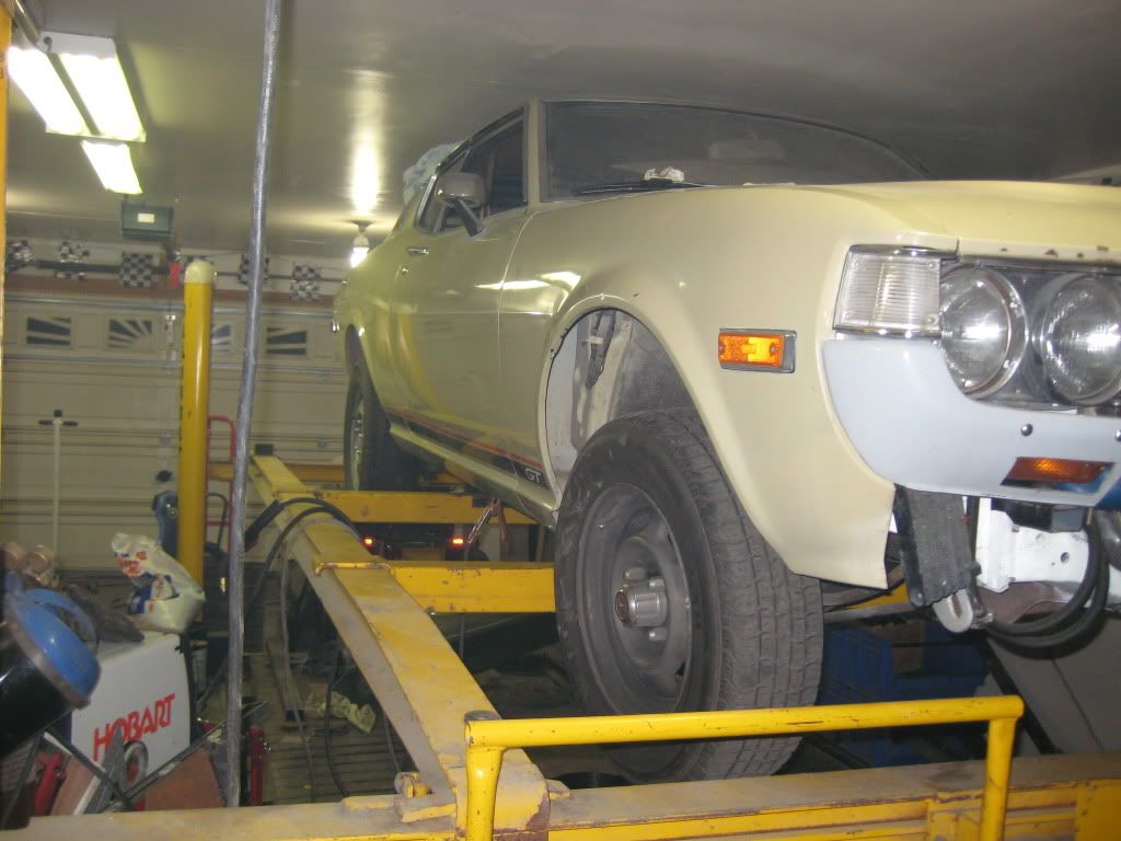

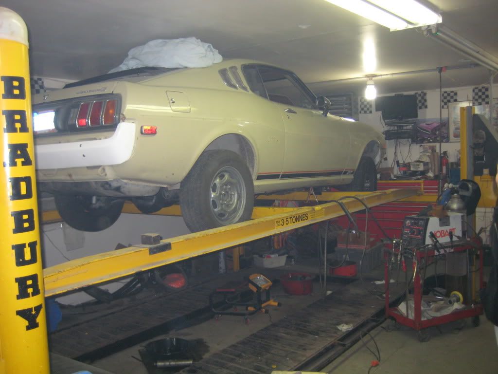

Here is my progress on the car and subframe connectors
Up in the air to weld underneath

Thru-Floor

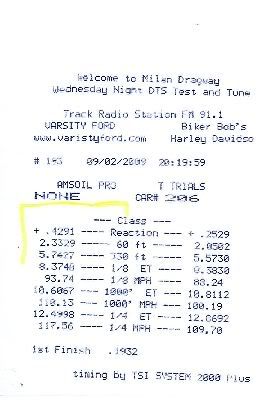

I ordered some 15x8" steel wheels with a 6.5"(crazy fwd offset) backspace, High backspace to compensate for the wider rear axle.
I will be using 215-60-15 Mickey Thompson, DR's
Don't know if I will be able to touch 10's with the current amount of boost, but that can change easily.
I am hoping for mid-low 11's in it's current form.
Guessing it's going to be kind of hard to get this thing to leave the line like I want it to with a manual and no 2-step or anti-lag...
