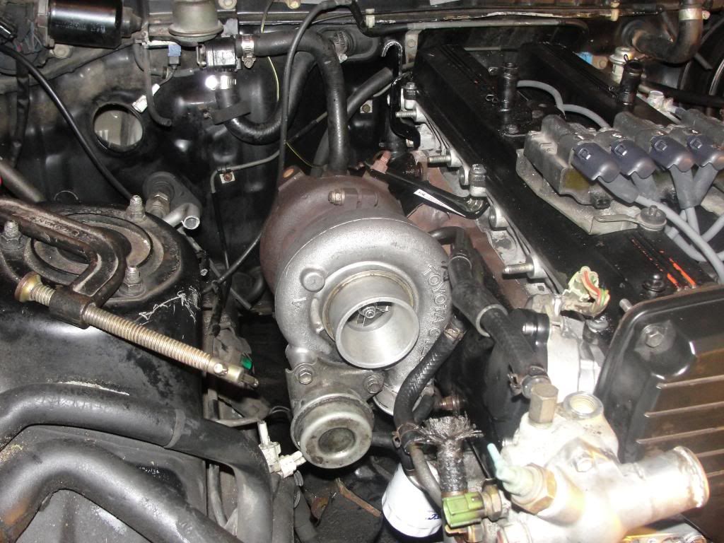

Finally got my Coil Pack harness from Toyota today as well as the gasket that tore during the last turbo install episode, Got Coil packs, Ign wires, and the CT26 installed this morning before work. All I need to do now is the clutch kit, drop the engine in, install I.C. pipe and I.C., and get my manifold stuff taken care of and I should be up and running soon.

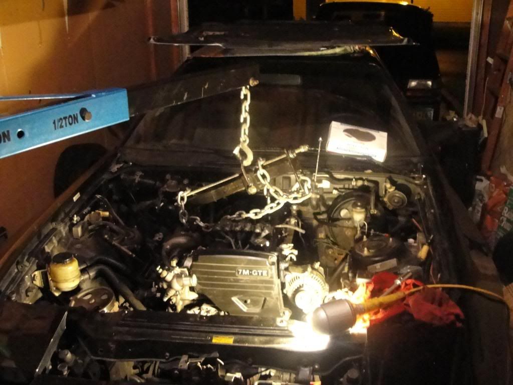

At 12:56 am July 23rd 2010... my engine was officially in my car! Woos! The generous Mr. STEVE came up and with help from the wife, we got the motor in. I believe STEVE will be posting pics.
Now to just start bolting stuff on and installing IC components and such.

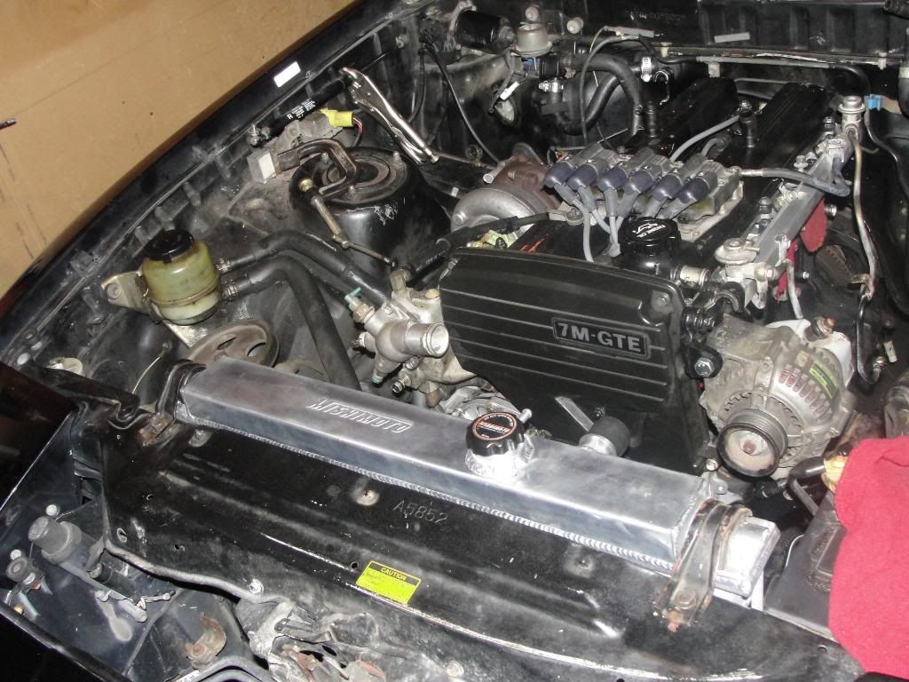

^ Actually, the IC I will be running is for a FFIM (which I will be using) so the N/A P/S reservoir will be ok where it is :)
And in other news and run-on sentences...
Today so far I installed the radiator, hoses, P/S pump, belts, engine harness, AFM, and after I veg out for a while and do some running around, I will install the starter and start installing IC and pipe as well as oil cooler stuffs. Tomorrow at work I'm going to need to get a gasket for the franken downpipe I got from Sean.. and then it's on to exhaust install!
Things are actually going smoothly kinda!:aigo:
